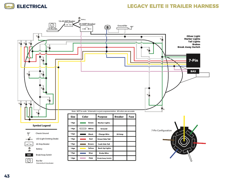

I have read somewhere about some trucks having a problem with some trailers. Found this online: "Ford vehicles, particularly certain F-150 and Super Duty models, have experienced issues with their factory-installed trailer brake controllers. These problems can range from the trailer brakes not engaging at all, to intermittent connection problems, or even the trailer brakes applying unexpectedly and forcefully. A common cause is a software glitch within the integrated trailer brake control module, which can prevent the controller from correctly detecting a trailer or properly applying the brakes. " See if you can borrow someone else's truck to see if the problem persists.
Another likely failure point is the 7 way plug on the trailer. Those contacts can become spread out and/or corroded. Look inside the plug and inspect the brake contacts with a flashlight. If they're corroded, a temporary fix can be using a thin file, emory board, or screwdriver blade to scrape the contacts clean. If they seem spread out, use a small screw driver or hook to bend them back inward a bit. These would be temporary fixes.
If your plug is shot, it's easy to replace. Disconnect the trailer batteries before you start because the 12v Power lead is hot and then follow this wiring diagram to install a new plug.

Since your brakes work when you pulled your disconnect I'm guessing it's likely a simple connection issue on the blue wire or ground. Less likely the ground wire if your running lights/turn signals and brake lights are working.

Or the Ford issue that @Steph and Dud B cited. First thing to try is to test for voltage at the Ford F350 TV 7-blade connecter. Jump the BLUE and WHITE wires with a test light or meter while a friend applies the brake pedal then releases, on and off.
@BoondockingAirstream you don't need another trailer.
If it shows voltage, then test for amperage through the blue when connected. I believe @Geronimo John wrote that brakes at each wheel should draw 2-4A, so at the main harness it should show 4x this number when all 4 brakes are working. If you have 12VDC at the hitch and no amperage draw downstream to the trailer, then you have an open circuit along the path to the wheels.
No brakes at all likely means your issue is not wiring at individual wheels or in the axles. It would be between the TT 7-blade connector and where it's connected to the first wheel in line.
The brakes are grounded to the trailer frame, not through the truck connector. This is so they will still work via the breakaway switch without the truck. That makes the blue wire from the truck the likely suspect, since the breakaway does still activate the brakes. My money is still on the connector itself.
That trailer ground works for the breakaway switch since the battery in the trailer powers it, but to complete the brake circuit from the truck  you must have a good ground from the truck to the trailer too

I tend to agree, and venture to say likely a bad ‘blue’ wire connection either at the male 7-pin connector or downstream on the Oliver. The OP has no issue with other trailers being pulled by his F350 and thus, don’t think the vintage of the TV or inherent factory installed equipment issues are of concern.
That makes sense, it needs to complete the circuit. However if the ground connection from the truck was faulty, I'd expect @BoondockingAirstream to have other problems, like intermittent running lights, too. With him reporting the breakaway system working properly it seems most of the trailer brake wiring is intact.
I've seen LED trailer lights work correctly getting their ground through just the hitch coupling alone but then the trailer brakes work intermittently or not at all. Happened to me a few years back with my boat trailer. Still think a missing ground is at the bottom of the list in this situation though... If it were mine, I'd hit both connectors with some  DeoxIT before I even broke out the multimeter.

 Thanks Steph and Dud B for the color plug wiring diagram.  I made a copy to put with our Oliver 'suitcase' of manuals.  Nothing in the manuals cover trouble shooting, that I am aware of.

The breakaway switch connects the blue wires and the pink wire through +12v side of a 20amp resetting breaker (under the street side rear bench cover).

The breakaway switch connects the blue wires and the pink wire through a 20amp resetting breaker (under the street side rear bench cover).
@Galway Girl I think the schematic indicates that the breakaway switch is on the hot side of the of the 20A auto resetting breaker, meaning that the breakaway switch is alway hot and the black 20A breaker services the black charge wire.
