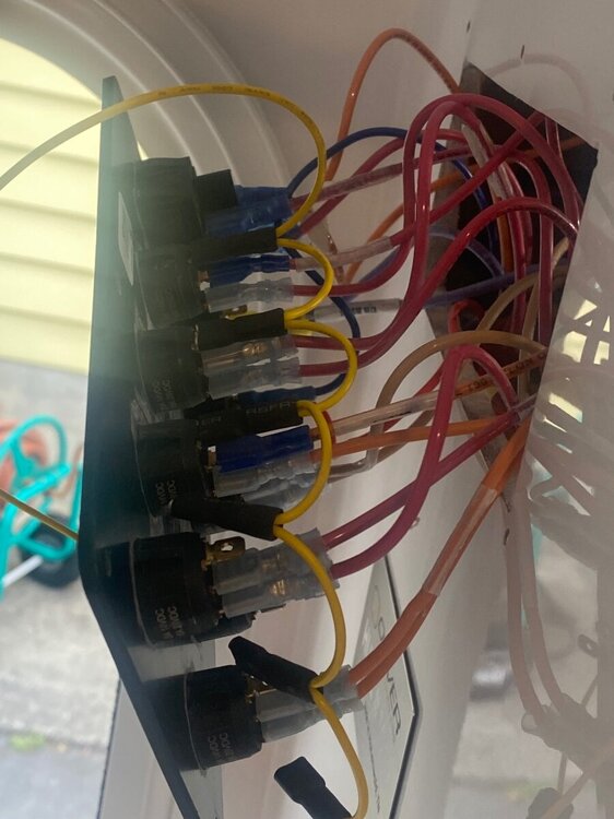

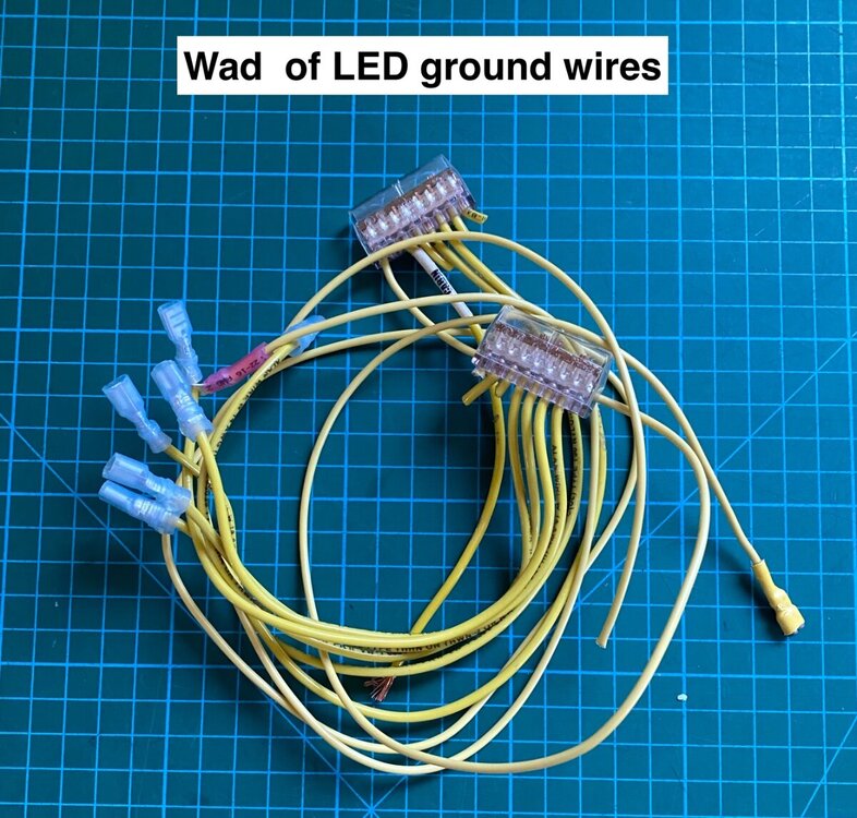

Sounds like click bait, but it’s true!  During a recent trip, the master switch on the main panel started flickering on and off, and that caused the blue LED indicator lights for other switches to flash.  It turns out that one of the spade terminals for the switch had loosened from the strain of the tangled mass of wires that were tightly stuffed in behind the switches.  Many of the wires were individual grounds for the LED switch indicators, and there just isn’t enough room for all of them.  The wires are oversized and stiff, and they used bulky splices to connect them all together.

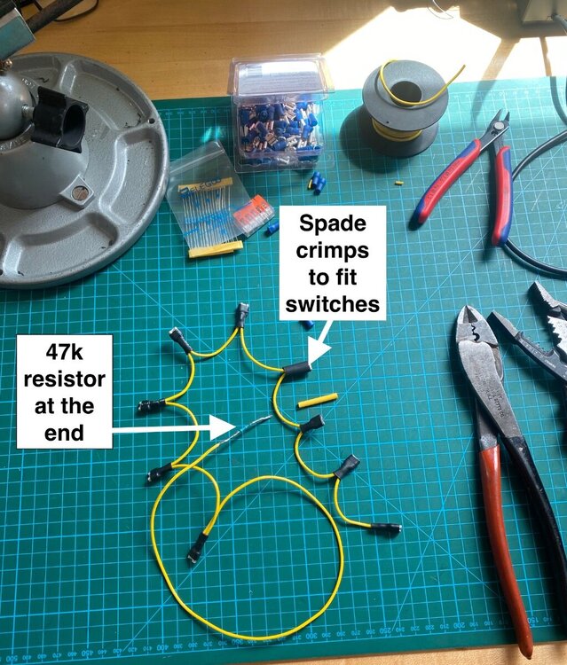

So I cut the mass of yellow wires out and replaced them with a single smaller wire that was daisy chained to each switch.   That space is much less tangled now, and there is more room and less strain on the switches.  Now I have room for a new switch for a future project.
While I was in there, I decided to address another peeve.  I’ve always thought that those blue LED’s were too bright, so I soldered a 47K ohm resistor on the termination end of the new LED ground jumper.  This dimmed the LEDs by about 50%. . . so much better!
If anyone’s interested in doing this, Amazon carries a 525 piece resistor assortment for $8 so you can experiment with various levels of dimness.  Only one resistor is needed for all the switches, so you could do a little twisted resistor art with the leftovers.
I hope that someone finds this useful.  Cheers! Geoff
