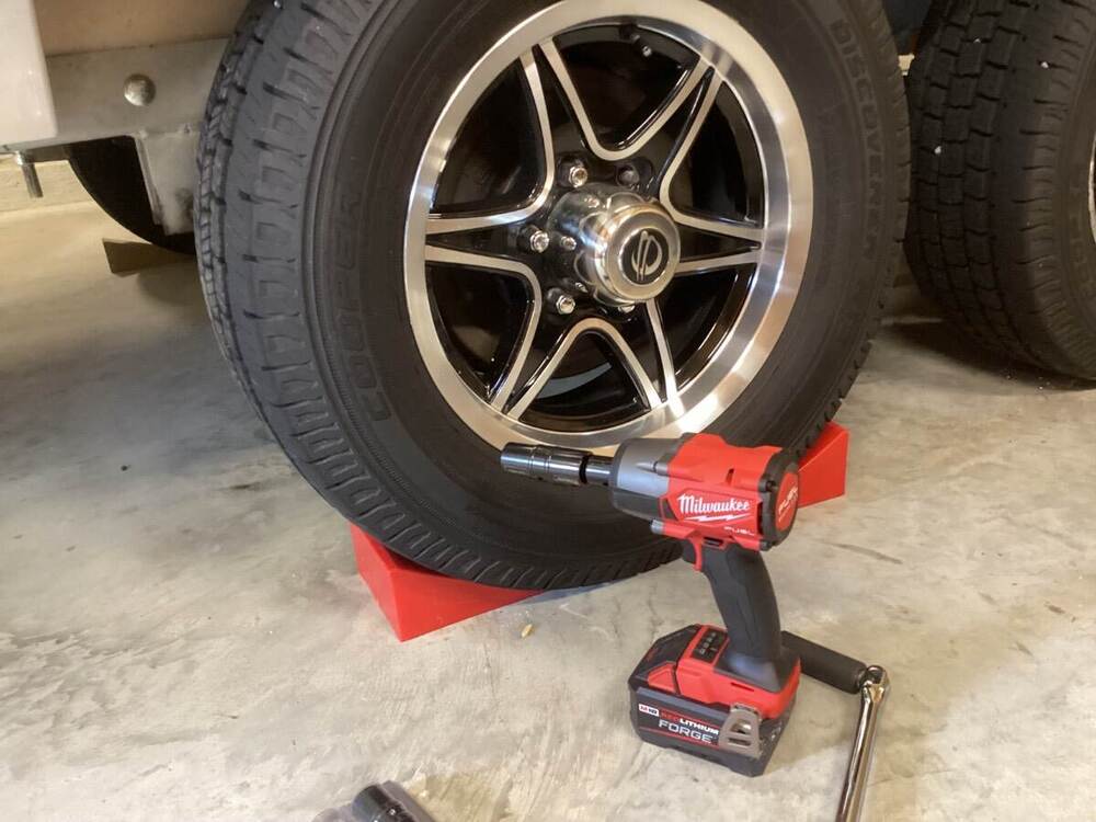

I have all the tools needed, and it was a cool sunny day, so that was a bit of luck. It had been raining a few hours earlier. I didn't have my impact driver with me, but I do have an 18" breaker bar, so I could loosen the lug nuts. Before jacking up and removing the tire, though, it was time to get the spare. Two heavy e-bikes made this a chore, but fortunately, that's when a large fellow stopped and offered to help. (Oddly enough, the local deputy sheriff who was using the facilities at the station never even checked to see if we needed anything on his way out of the parking lot.) With his help, we slid the rack and mount out far enough to get to the spare. His impact driver made for a faster swap than my breaker bar, and his torque wrench was easier to get to than mine buried in the trailer's basement. All in all, about an hour and a bit delay, and the kind gentleman who stopped to help refused any remuneration.
  - I usually only carry the impact driver with me on long trips. And while this was about an eight hour drive, I'd elected not to bring it with me. It will now be included in every trip.
