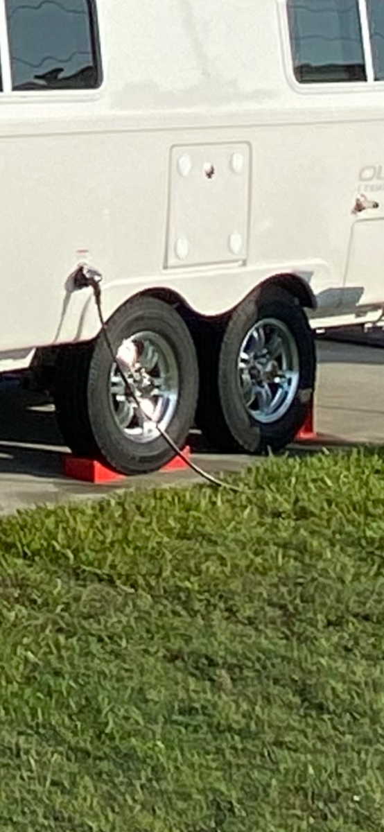

Moderators SeaDawg Posted November 23, 2025 Moderators Posted November 23, 2025 (edited) Our 2008 has the switch at the wheelwell, just above each wheel and jack. Pros and cons to each placement, I guess. Edited November 23, 2025 by SeaDawg 2008 Ram 1500 4 × 4 2008 Oliver Elite, Hull #12 Florida and Western North Carolina, or wherever the truck goes.... 400 watts solar. DC compressor fridge. No inverter. 2 x 105 ah agm batteries . Life is good.

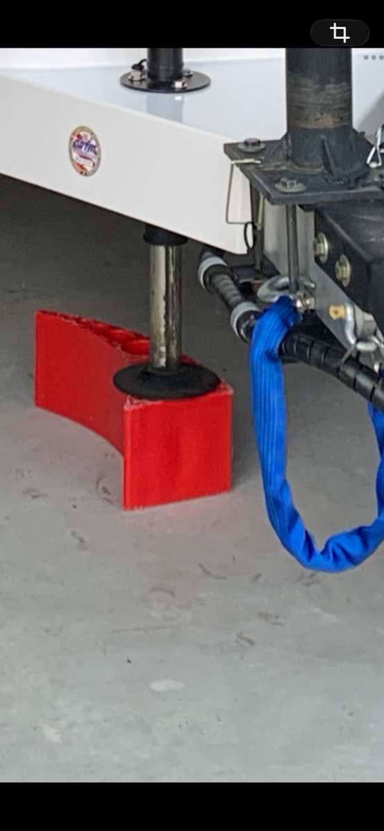

Moderators topgun2 Posted November 24, 2025 Moderators Posted November 24, 2025 (edited) I don't know if I'm in the minority or not - but - I happen to like the rear jack switches located on the front of my Ollie. Unlike Mike, I found the bubble level that is on the top of the front jack to be virtually useless. So, I installed three small bubble levels on or near the front of the Ollie. All three are right at the "belly" line where the top and bottom shells are joined. The first one is just above the front jack, the second is basically under the bath window and the third near the front door. These levels are much more accurate and sensitive than the one on the front jack and can be observed with a simple step in one direction or the other. I also didn't hurt that they were very inexpensive and are attached with exterior double sided tape. Finally, even though I very seldom use the rear jacks, when I do I use 6x6 blocks under those jacks. This makes positioning easy (in most cases) with one quick look to make sure that the jack and block are properly aliened. Perhaps, the "perfect solution would be to have three way switches so that these switches could be placed in BOTH the front and the rear which would allow for the use in either location depending on the situation. Having thought about this solution, I'm marginally surprised that ScubaRx has not done this type of mod (note that if you ever get a chance to see ALL of the switches that he and Tali have in their Ollie, you will see what I mean here). Bill Edited November 24, 2025 by topgun2 3 2023 Ford F150 Lariat 3.5EB FX4 Max Towing, Max Payload, 2016 Oliver Elite II - Hull #117 "Twist" Near Asheville, NC

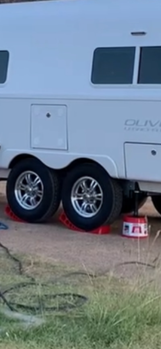

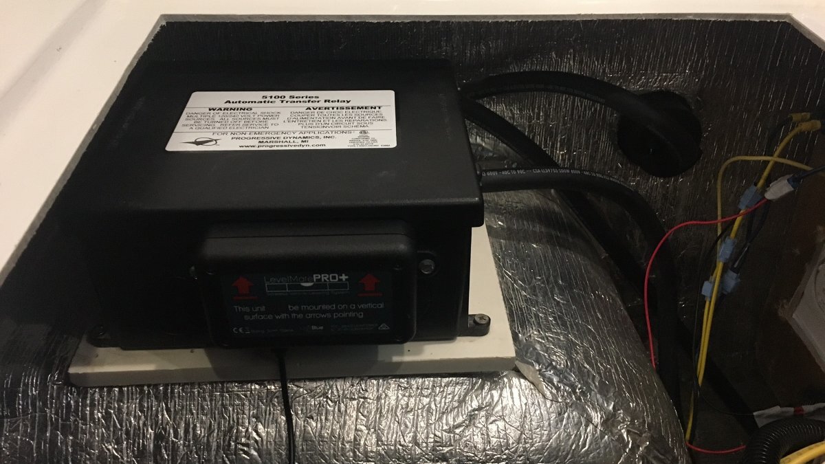

jd1923 Posted December 6, 2025 Posted December 6, 2025 (edited) On 11/24/2025 at 7:48 AM, topgun2 said: I don't know if I'm in the minority or not - but - I happen to like the rear jack switches located on the front of my Ollie. Unlike Mike, I found the bubble level that is on the top of the front jack to be virtually useless. So, I installed three small bubble levels on or near the front of the Ollie. I'm with Bill and Mike on this one (except for the bubble levels thing)! I prefer to have all 3 jack controls in one location and the best possible location for all 3 is up front, right where they're installed! I back into our spot with the LevelMatePRO App ON (hardwired and always powered ON) to get as close to level as possible. We use the Andersen Rapid Jacks on one side when needed and then place the 8" round Andersen Blocks under the rear jacks. Next I'll place some sum of 1" blocks up front to achieve the best height. First I'll get the rear jacks to just touch (often in lieu of wheel chocks when the campsite is mostly level). I don't need to see them, I just listen to the motor, use your ears instead of your eyes! The motor will change pitch, just start to grind, when contact is made (first I turn off our noisy old diesel)! Then lift the front jack to release from the TV hitch, bring up the rears a little more and finish level using the LevelMatePRO App. We like to have the front up 0.5" and level side-to-side. No way you can be this exacting with a bubble level and the LevelMate can be used starting from the driver's seat! Adding the LevelMatePRO will be something you'll never regret! Get the PRO model which can be hardwired, easiest to mount under rear dinette seat (see pic). Add this great accessory, train your ears, and leave the switches alone! 😎 Edited December 6, 2025 by jd1923 1 Chris & John in Prescott, AZ | 2016 EII #113 | '01 Ram 2500 Cummins!
