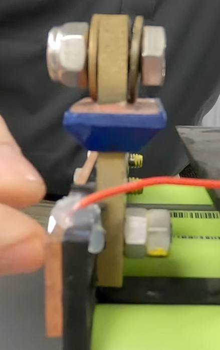

And is it me, or is the bolt on the Battleborn battery that he says is too small and the equivalent of a 6 awg cable look to be the same size used on the Lithionics battery main connections?

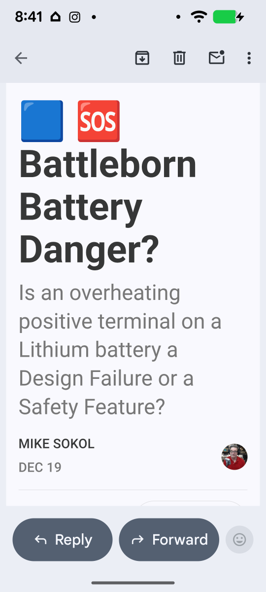

I reached out to RV Electrical Guru, Mike Sokol on his Facebook site. He responded that he would dig into this and today he posted on his email newsletter.  He has asked people to respond if they had experienced any battery overheating.
