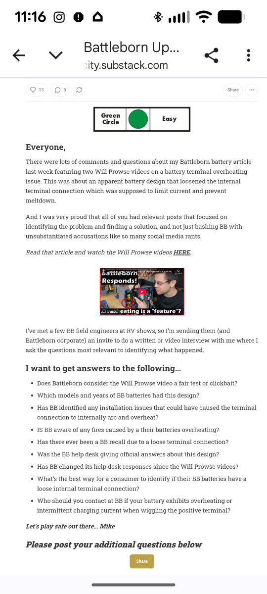

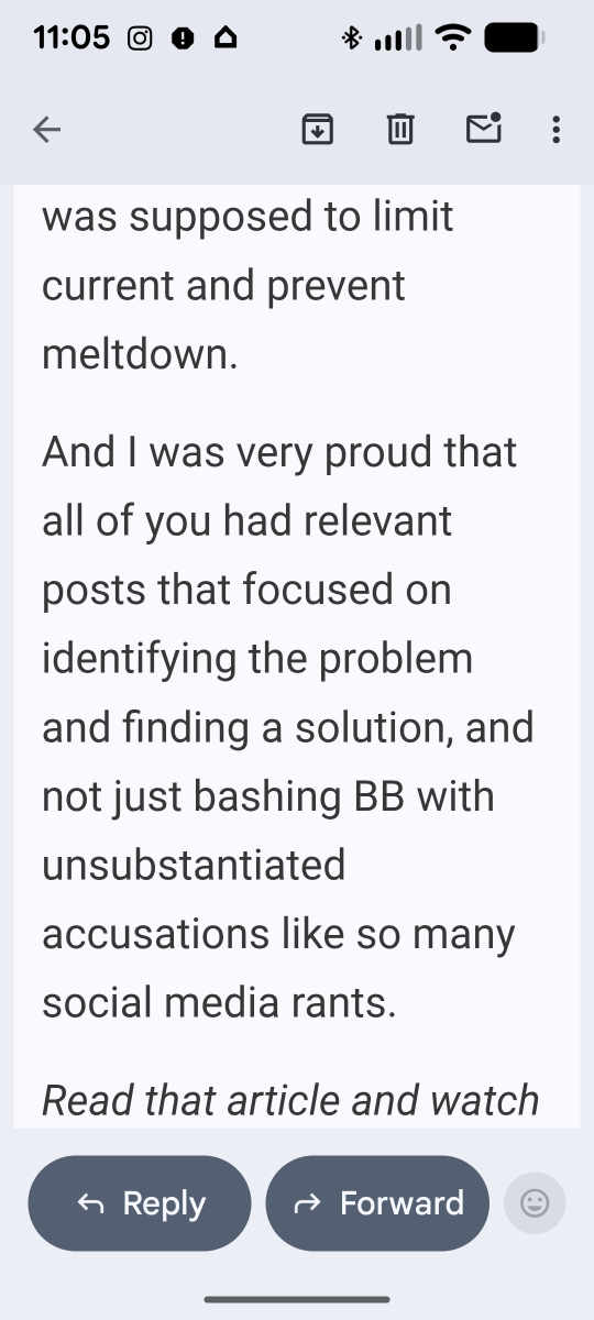

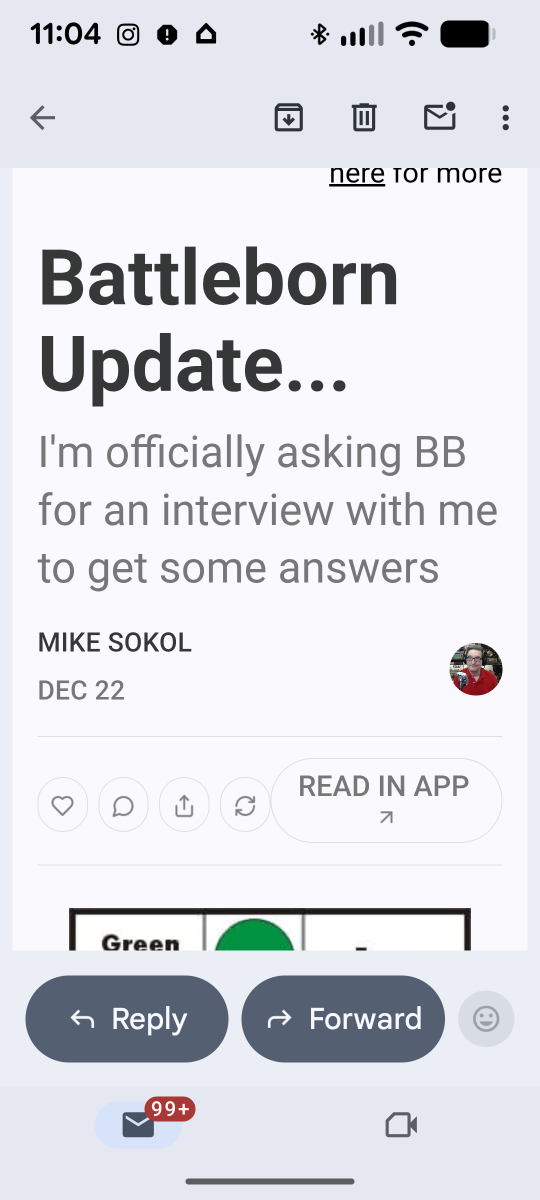

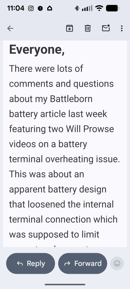

John Dorrer Posted December 22, 2025 Author Posted December 22, 2025 Mike Sokol posted another email newsletter on Battleborn. It is too long to screen shot, so you will need to get on the newsletter mailing. John & Susan Dorrer, 2013 F250, 6.2 gasser, 4x4, 2022 Legacy Elite 2, twin beds, Hull #1045, Jolli Olli -
John Dorrer Posted December 22, 2025 Author Posted December 22, 2025 Here is the whole article 2 John & Susan Dorrer, 2013 F250, 6.2 gasser, 4x4, 2022 Legacy Elite 2, twin beds, Hull #1045, Jolli Olli -
