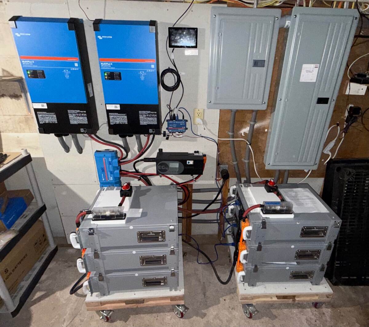

I do this with my home backup system ( pic below ). Temp sensor(s) on positive battery bank cable close to T-class fuse. It is interesting to watch it rise when pumping 6 kW+ into bank. Like you, I am now considering adding Cerbo GX to trailer ( 2xBB ) or, maybe a meat thermometer w/remote 😀
2023 F150 Powerboost 7.2kW, 2023 NuCamp Tab 400 BD, Clam Escape Sky Camper Man Cave,  Elite II wannabe
