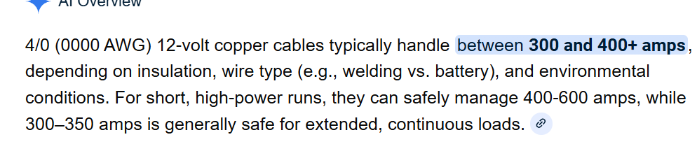

but with 900 Ah I'd have to run our A/C, our Air Fryer and run a power cord to another RV to run their A/C to get anywhere the 600A of continuous power (2x for peak use) the spec of these batteries
I know you are just joking.  But let's not toss that glove as someone may try it.  I think our 4/0 cables and lugs would have some concerns if running them at 900 amps. Not to mention our fuses.
Checked AI and "it" agrees.

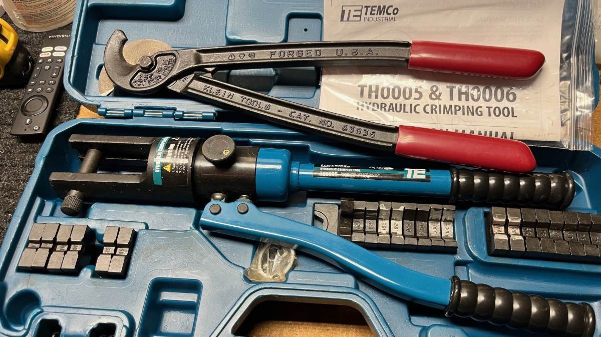

BUT, when I do upgrade, how well will my existing 3 each BB's  4/0 cabling work for one or two EPOCH's?
Knowing  would determine if I should pack for this season my cable cutter, hydraulic crimper and 4/0 lug kit.  As you know I like to be prepared, have options, and plan ahead.
GJ

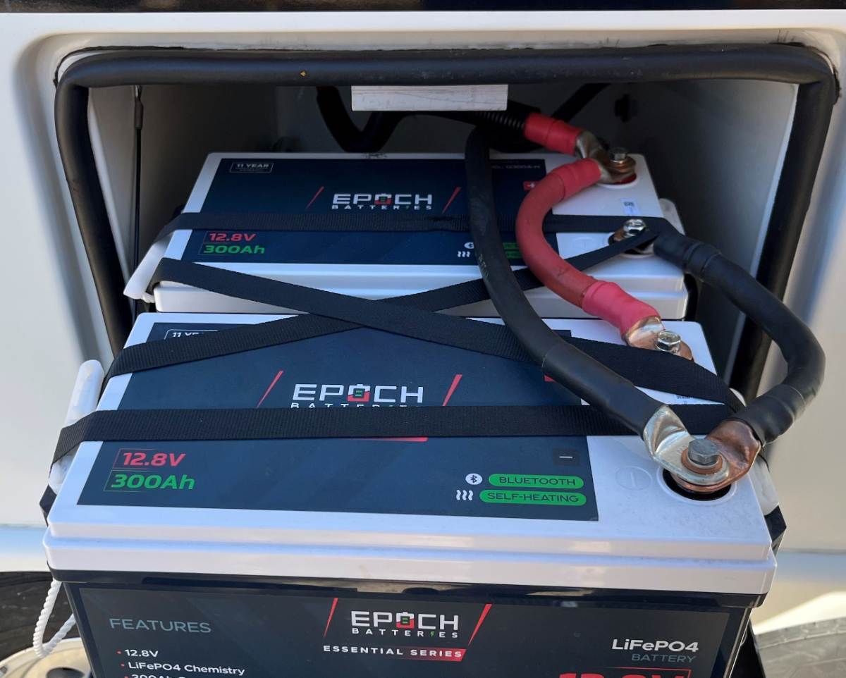

Besides the main 4/0 cables already in your Oliver, you just need two about 10" cables which you might already have on your BBs. If you want to do this work when we get together, I've got enough 4/0 cable and a cutter, but just ran out of 4/0 lugs when I added my 3rd Epoch, and I have a killer hydraulic crimper! 😎

You also want spacing between the batteries, first to dissipate heat, and if one battery has issues it would affect the other less and of course so they do not hit or rub against each other while towing on rough roads. In my two battery installation I had 1 1/2" space at the inner wall, 1 1/2" space in between the two, and 3" on the outside (there is a total 6" extra room in the tray). This also centers the weight more to the inside and directly over the frame support.

JD:
Many thanks for the offer.  I'll order out lugs and cable just to have them in case they are needed at other locations.  I'll also bring my Harbor Freight tools in case my BB's fail on the road.  But your cutter and crimper are for sure higher quality than mine.  Hopefully my BB's will survive at least until the warranty has expired.
Although I doubt that will be the case so being ready and prepared with options is warranted.
I updated my Truck to a 245Amp alternator with 4/0 to one battery and upgraded the link between batteries to 2/0.  I ran 1/0 back to the Oli for the Victron DC to DC charger.   While I was working with the big wires, I did the John Davies clean up in the battery compartment with 4/0 with smartshunt and shut off  switch  so that when I upgrade from AGM to Lithium I would have a good foundation.
I bought a hydraulic crimper and I loved it.  Made all the work so much easier.  While I was at it I bought several extra lugs from 6ga to 4/0.  I love my dog but for me tools are mans best friend. They can make life so much easier, they just aren't warm and snuggly.

JD: your battery bay sure looks a lot simpler with your new batteries!  Also like the cross strapping idea.
GJ
