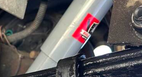

We had the 4 leaf alcans put on in October and they are a great upgrade.
They also gave me the extra leaves in case I wanted to add them in the future.
I also replaced shocks and equalizer at the same visit an it only took Alcan 3 hours.

PS what shocks did they use?
Appreciate the photo and good move to replace the shocks & equalizer, too.
The shocks are bulldog shocks.
Bulldog HD Shock Absorber Replaces 555001 For Trailer Leaf Spring Retro Kit
They were ordered on-line for around $145 from 4 state trucks.
19-050000007: Bulldog HD Shock Absorber Replaces 555001 For Trailer Leaf Spring Retro Kit

@Galway Girl Thanks for the Shock info. I just ordered a set. It's time others try new products too.
I'll let you know how it goes.

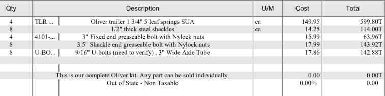

Springs Ordered:
I talked with Lew for quite a long time today.  He cannot believe how many Olivers they're doing these days. They try to keep at least one set of springs on the shelf at all times for Ollies.  Mine will ship next week. All they need to do is create the 9/16" x 3" U-bolts.
I told him on my way out West, someday, I'll have them slap on the 5200 lbs axles too. LOL. He just said give them some lead-time.
I think Lew convinced me to just stay with the 5-leaf set, but also said I can simply remove the bottom leaf if I wish, no big deal.
And when someone asks, Lew did say they recommend always leaving 20% of max spring capacity for "wiggle room". So:
4-leaf springs x 4 = 9,000 lbs - 20% (1800 lbs) = 7,200 lbs
5-leaf springs x 4 = 11,000 lbs - 20% (2200 lbs) = 8,800 lbs

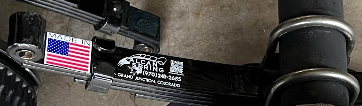

Alcan Spring visit and 5 leaf pack install went smooth and quick. I don’t recall the exact labor charge but it was reasonable.
The install only took Lew’s team 2.5 hrs and was worth every penny, I never broke a sweat. 😄 A first class install.

Alcan has already shipped the springs. Shipping was $175 via UPS. Final cost was $1291. I suspect that would be nearly the same cost having them installed by Alcan themselves. Give or take a few bucks. Can't wait to get started.  I love the experience.  This will be my second install of Alcans.  It also keeps this "aging" body moving more.  Too much desk work as a career in Information technology. 😜
PS: Lew did confirm that their shackles are NOT splined, but the wet bolts are.  I'm not sure why they have decided this, but as we did Steve's camper, I will mark the bolt ends with a scratch, in order to know where the grease hole orientation is upon installation.  It's the best we can do I think, in this situation.  I explained that to Lew, and they don't seem to see an issue with splineless shackles.  Just FYI.
Here’s a pic of the HD wet bolts. Hopefully you also ordered the HD shackles. I had Alcan install the wet bolts with the grease zerks facing under our Oliver for easier access when greasing the zerks.

I just received my shocks, thanks @Galway Girl and I know @jd1923 has used these too I think I saw in another post. Can't wait to get started, but I have another rally in a week.  LOL
Would you share the cost and the online vendor and part number for us ADD folks ?
Robert E
2022 LE II , LIthium Pro, 2018 F150 XLT 4WD 2.7 EcoBoost , 355 gears, tow package,36 gallon fuel, factory brake controller, transmission cooler
@Tideline77
It's above, but here it is again with current pricing.
(edited): Ordered from 4 STATE TRUCKS https://www.4statetrucks.com/
Item:
As of January 2026: Qty 4 = $154.40, shipping to GA just over $14.
