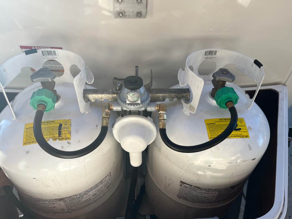

While helping my girlfriend with her 2002 Casita to down-size her propane tanks to new 20 lbs tanks, we found that the propane regulator bracket and the hold-down/tank retainer bar were flipped and allowed the regulator, and hence hose/lines, to drop too far down. This can easily happen to any camper with a dual propane tank system like this.
After anyone works on your rig, or you purchase a used travel trailer, ensure things are in order in the propane area.
Hope this helps.
UPDATE: If you look close at her picture, you can also see that the right-angle LP connector off the regulator has now rubbed into the passenger-side tank.  That's not good in any way shape or form - truly bad.  I'm sure these have very strict rules by the DOT. Also, in some rare cases, having certain regulators lower than the tops of the LP tanks, may cause certain LP appliances to fail to operate properly.
Edited by Chris Scarff
Improved image with "Bad" indicator, and UPDATE

I actually love your idea. It seems that in some cases that would be a bit less work.  However, as @Ollie-Haus recently found out with his current regulator, he ended up having to raise up his regulator on the bracket to be a bit higher compared to the top of his tanks. We had an exhaustive conversation about it. This was because his Truma (I think) was having issues igniting, he can verify.
I then read through a bunch of different regulator instructions while at a local hardware store, and found out that some regulators (few) did mention the height/elevation recommendation compared to the tanks.  That was a surprise to me, but I'm a computer guy and have never gotten out of the house much.  LOL
Since I received only this one picture from my girlfriend, I had also noted that it's time to replace both hoses so she has good data on age.
I still love the idea of an easier removal process, no matter what.  Some of you guys are really good with metal-work.  So get to work on ideas.  🫠
PS: If you look close at her picture, you can also see that the right-angle LP connector off the regulator has now rubbed into the passenger-side tank.  That's not good in any way shape or form - truly bad.  I'm sure these have very strict rules by the DOT and other agencies.

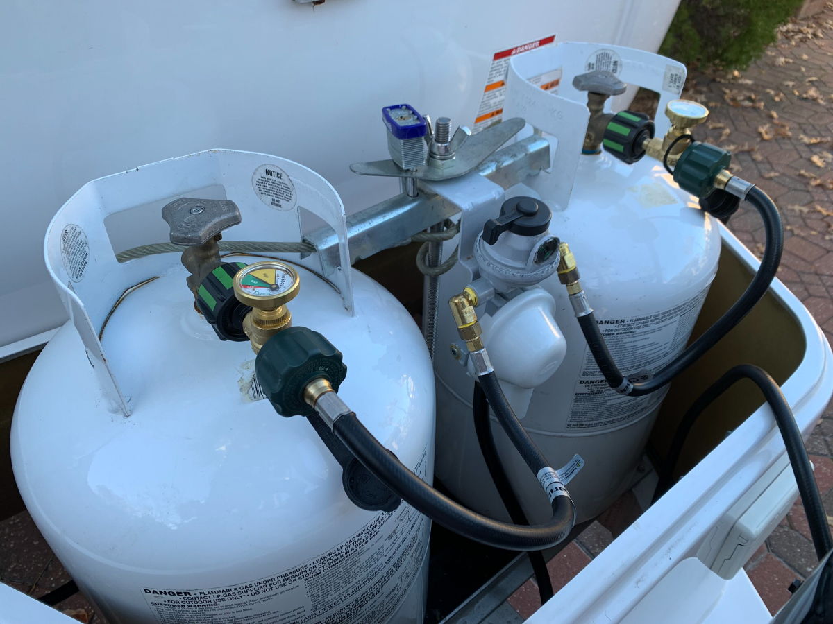

I believe it’s designed to sit above. Works for me. It drops down when detached/filling tanks and lift up and it sits nice and close when mounted and locked.
I renewed the regulator and lines a couple months ago. 😎 I used your idea of using street elbows so 12” lines would fit nicely!
Also, the new regulator came with a mounting bracket exactly like Ron’s (single mount). I reused the original bracket that mounts to the threaded post above and below for better support (can’t be seen in photo).

As @Chris Scarff mentioned above, I experienced a regulator failure on our 2023 LE2 and it was not allowing  gas to flow at a high enough rate for the Truma furnace to run properly. Rather than making an appointment and going to the trouble of hauling the camper to a local dealer for troubleshooting, I decided to just replace the regulator with an identical model. Currently Oliver is using the Fairview GR-9984. Long story short, the regulator was the problem.
When I received the regulator it came with very specific installation instructions, which clearly indicated that the regulator was not installed correctly from the factory. I have no way of knowing if this had anything to do with the failure, and I doubt that it did or you would likely hear about others experiencing this same problem.
Nevertheless I chose to install the new regulator according to the instructions. I do believe this is an important detail or Fairview would not explicitly detail these instructions.
Below is the instruction sheet that came with my replacement regulator. Notice at the bottom of the page are the highlighted instructions for correct installation and incorrect installation. The next two pictures are my as found installation, followed by my updated installation with the new regulator.
Note: I have ordered a set street 90 fittings to reduce stress on the hoses as others have mentioned in their comments
As found
Updated installation required mounting the bracket to the lower set of holes in the regulator, effectively raising it ~3-4 inches.
There is still about 4 inches of clearance between the top of the regulator and the propane cover and the valve selector is still easily accessible for switching.

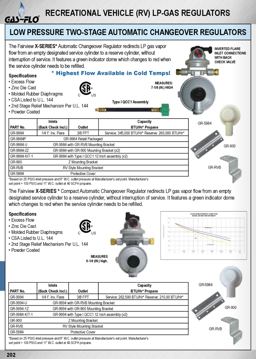

Your regulator may be undersized for the load.  Past posts indicate that the gas regulator size likely should be in this range:
·       The OEM Hull 505:   GR-9984XF with 345,000 BTU
·       Possible Smaller Replacement Part if above is not available:  GR-9994XF has 262,500 BTU
If you are using a high demand outside stove, grill or fire ring especially with the furnace running; then for sure go the larger regulation.
Hope this helps with the moonlight harmony you are getting from your regulatior.
GJ
PS:  The Fairview gas regulators are designed in USA and made in North America.  I have purchased them from American Copper and Brass for a lot less than most posted prices on the net.  Worth checking them out.
Edited by Geronimo John
added PS
I checked AC out yesterday, the version they sell is the 262K BTU version (bottom in data sheet)GR-9994.
Amazon has the GR-9984 with 345,000 BTU version (top of data sheet) for about $95 and E-Trailer $125 or so...
Edited by Galway Girl
