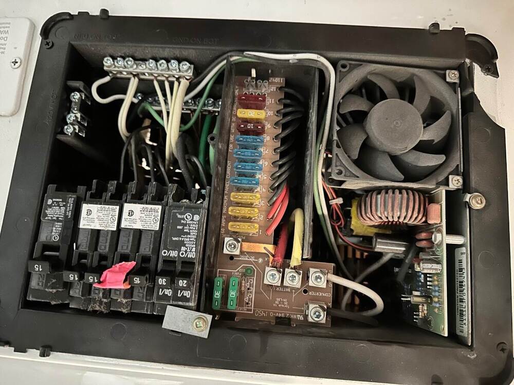

Thank you, I am using a Deltran battery tender, it’s a smart charger and it has not fully charged the batteries (yet).  My panel does not match what was in the manual!
If the previous owner accidentally connected the batteries backwards, even for a second, the reverse polarity fuses will blow and your converter won't charge the batteries. So, first, verify that your batteries are connected properly: positive cable (usually red) connected to the positive battery terminal. Just to be sure.
Next: Those 2 green 30 Amp fuses at the bottom of your photo appear to be the reverse polarity fuses that are suspect. Pull them and test them. If you don't know how to test them, just buy 2 new 30 Amp fuses and replace them. See if that solves your problem.
Also the terminals appear that they could use a cleaning as well.

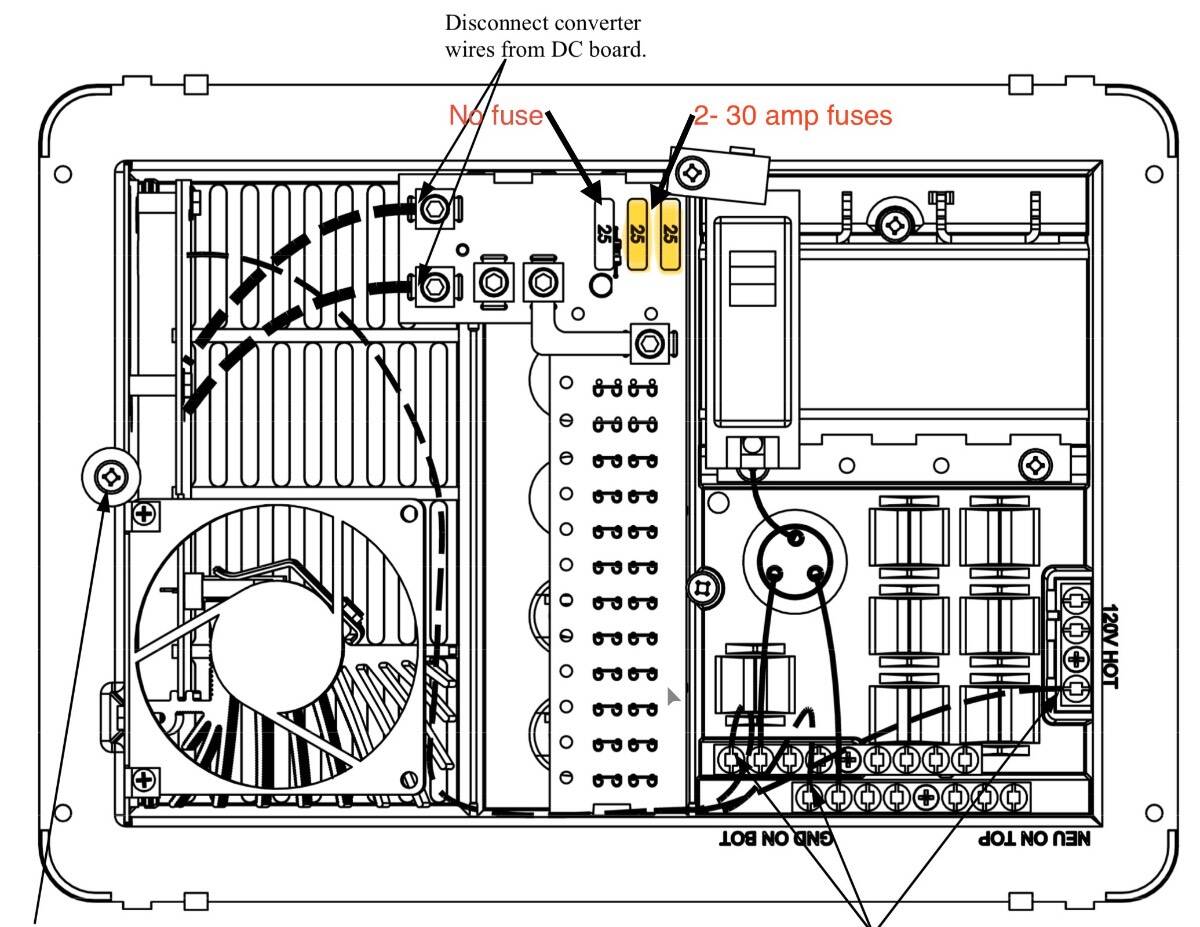

@DBL-R Based on my 2018 wiring diagram, I have 3 - 25 (or 30 in your case) amp fuses which are called Reverse Battery Fuses. Strange that your system calls for 30 amp. As indicated in this post, check the batteries for property wiring and then check the Reverse Battery Fuses to make sure they are not blown. Not sure why you do not have 3 fuses in place. It might be a good idea to call OTT to confirm the 3 fuses in your Ollie are required.
Good luck
@DBL-R
I updated my post. Again, suggest that you call OTT to find out if you in fact you should have 3 Reverse Battery Fuses in place.

Everything appears to be wired correctly and the fuses are good.  I spoke with OTT and other than the batteries loosing voltage, there is no way for me to test it.  The suggested taking it to a service center and having them do diagnostics. Since it is in the garage, on a battery tender, and not winterized I will do that this spring.  Since it is new to us, it will be worth a piece of mind to have it check out.  While we are at is does anyone know the make and model number for the shocks?  I want to replace those and all I could find was the Monroe 555001, not sure if that is correct or not.  I am waiting on a call back from the parts department.
