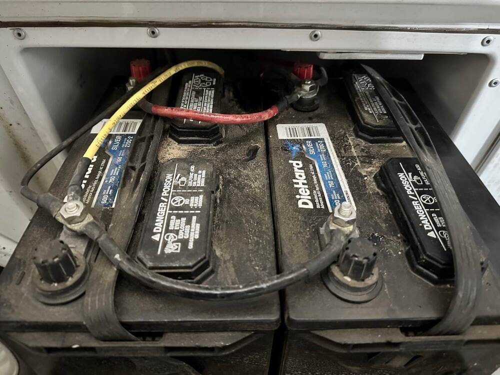

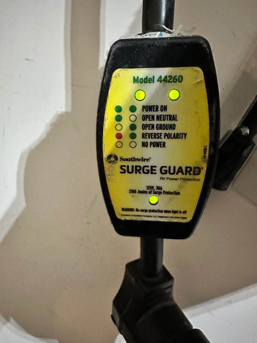

DBL-R Posted February 22 Author Posted February 22 (edited) Geoff, the 30amp 120v circuits is brand new. The surge protector indicates that the circuit is good. Still getting battery on I can only assume since the trailer is in my garage. The solar wouldn’t charge the batteries. Since there are two batteries connected together if I put one of the batteries on a battery tender, will it charge both batteries? Edited February 22 by DBL-R
DBL-R Posted February 22 Author Posted February 22 I put the batteries on a battery tender we’ll see if that helps out. I also tried a second 30 amp 120 V circuit on the outside of the house that made no difference. I thought maybe my power cable was bad but when I plugged that into 120 V the microwave works, but all the lights are still very dim. That was just an update. Thank you for all your help. It’s time to get some rest. Good night.
Snackchaser Posted February 22 Posted February 22 Okay, shore power looks good, but battery is dead! Sounds like you had been using outdoor solar to keep the batteries charged, then moved the trailer into the garage where there is no solar charging. If you didn't have shore power connected right away, then normal parasite power could have drained down the batteries and they just haven't had enough time to charge yet. A deeply discharged lead-acid battery looks almost like a short circuit to the charger initially. The battery voltage is so low that the converter/charger dumps maximum current into it trying to bring it up, which could cause brownouts both on the AC and DC power circuits. Deep discharge cycles and age can also degrade batteries, so they may not be charging, or they could be acting like a short. A faulty converter/charger can cause similar issues. It could have been weak or bad for a while, but un-noticed if you were solar charging. They can degrade and still work, but at a lower output. Where are you reading voltage? This could provide clues. To answer your question, yes a tender will charge both of your batteries at the same time. That would be a good next step. 2
Geronimo John Posted February 22 Posted February 22 (edited) 13 hours ago, Snackchaser said: 9 volts is critically low, you've got a dead or dying battery situation, At 9 volts the diehard's have likely already died. Good news on having 120V, at least you are not totally toasted. The batteries appear to be 12V wired in parallel. I'm 90% sure they are gonners. Don't just replace them until you get a volt meter and can test the output of your battery charger. They are called Converters. You'll need a volt with clamp on amp meter or a friend who has one. Post back with what you find. GJ Edited February 22 by Geronimo John 1 TV: 2019 F-150 SuperCrew Lariat, 3.5L EcoBoost, 10 Speed Trans, Max Tow, FX-4, Rear Locker OLLIE: 2018 OE2 Hull 342, Twin Bed. OLLIE DIY’s: Timken Bearings, BB LiFePO4's, Victron 712 Smart, 350 Amp Master Switch, Houghton 3400, Victron Orion DC - DC, 3000-Watt Renogy Inverter, P.D. 60-amp Converter, Frig Dual Exhaust Fans, Kitchen Drawer Straps. Front Wardrobe Shelves, Snuggle Shelf. TV DIY’s: 2 5/16" Anderson System, Nitto recon’s, Firestone Rear Air Bags, Bilstein 5100’s, Mud Flaps & Weather Tech all, installed Ham Radio (WH6JPR).

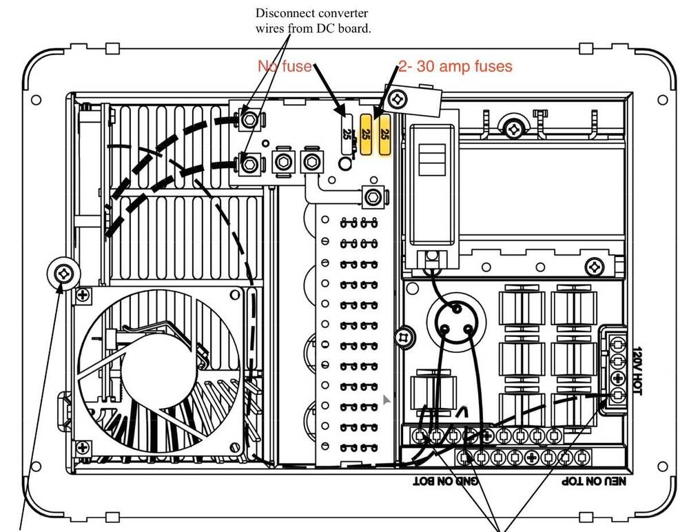

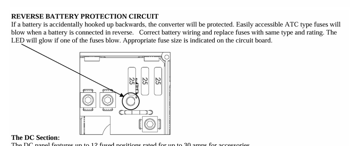

Steph and Dud B Posted February 22 Posted February 22 25 minutes ago, DBL-R said: When plugged into shore power, the 120-volt power will power the fridge, microwave, heater, and air conditioner. However, the other items continue to draw power from the 12-volt batteries As others have said, it sounds like your converter isn't charging the batteries. Could be a failed converter or blown fuse. Question for the hive mind: does the converter in a 2015 have reverse polarity fuses between the batteries and converter? Stephanie and Dudley from CT. 2022 LE2, Hull #1150: Eggcelsior. Tow vehicle: 2016 GMC Sierra 6.0 gas dually 4x4. Our Oliver journey: Steph and Dud B's RV Screed Where we've been RVing since 1999:
Geronimo John Posted February 22 Posted February 22 1 hour ago, Steph and Dud B said: Question for the hive mind: does the converter in a 2015 have reverse polarity fuses between the batteries and converter? First, great news. Yes it does. From the OM: Copy of the manual is attached. Great news. GJ OM - Progressive Dynamics Converter Manual 4000.pdf TV: 2019 F-150 SuperCrew Lariat, 3.5L EcoBoost, 10 Speed Trans, Max Tow, FX-4, Rear Locker OLLIE: 2018 OE2 Hull 342, Twin Bed. OLLIE DIY’s: Timken Bearings, BB LiFePO4's, Victron 712 Smart, 350 Amp Master Switch, Houghton 3400, Victron Orion DC - DC, 3000-Watt Renogy Inverter, P.D. 60-amp Converter, Frig Dual Exhaust Fans, Kitchen Drawer Straps. Front Wardrobe Shelves, Snuggle Shelf. TV DIY’s: 2 5/16" Anderson System, Nitto recon’s, Firestone Rear Air Bags, Bilstein 5100’s, Mud Flaps & Weather Tech all, installed Ham Radio (WH6JPR).
Geronimo John Posted February 22 Posted February 22 12 hours ago, Snackchaser said: A faulty converter/charger can cause similar issues. It could have been weak or bad for a while, but un-noticed if you were solar charging. They can degrade and still work, but at a lower output. Where are you reading voltage? This could provide clues. To answer your question, yes a tender will charge both of your batteries at the same time. That would be a good next step. WELL DONE! GJ TV: 2019 F-150 SuperCrew Lariat, 3.5L EcoBoost, 10 Speed Trans, Max Tow, FX-4, Rear Locker OLLIE: 2018 OE2 Hull 342, Twin Bed. OLLIE DIY’s: Timken Bearings, BB LiFePO4's, Victron 712 Smart, 350 Amp Master Switch, Houghton 3400, Victron Orion DC - DC, 3000-Watt Renogy Inverter, P.D. 60-amp Converter, Frig Dual Exhaust Fans, Kitchen Drawer Straps. Front Wardrobe Shelves, Snuggle Shelf. TV DIY’s: 2 5/16" Anderson System, Nitto recon’s, Firestone Rear Air Bags, Bilstein 5100’s, Mud Flaps & Weather Tech all, installed Ham Radio (WH6JPR).
jd1923 Posted February 22 Posted February 22 3 hours ago, DBL-R said: Overnight, the batteries charged and are now at 12.2 volts. Lead acid batteries should charge up to 12.6V. Yours being down to 9V and on charger overnight only getting to 12.2V, means it’s time to replace them. I see your hull #99, wow! This must be the second or maybe 3rd set of LA batteries. No time like the present to upgrade to LiFePO4 batteries! 😎 Chris & John in Prescott, AZ | 2016 EII #113 | '01 Ram 2500 Cummins!
