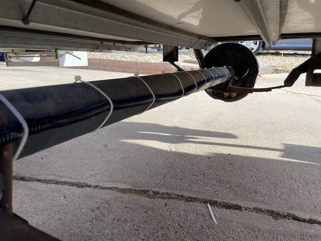

The main job was to replace the brake wires beginning at the left side (below the battery box) where the wiring exits the hull, and connecting new wires to each of the four brakes.   John suggested pulling the new wires through the axle by taping them to the end of the old wires, for various reasons, but once the taped joint reached the opposite side and I needed to pull it out through that small hole in the axle, the tape broke apart. I tried pulling the new wire through that hole with some needle-nose pliers but the wire was so soft that small pieces were breaking off. So we reverted to my initial plan (based on several others here on the forum), and ran the new wires along the rear side of the axles, using split loom and zip ties to anchor it. We found that the butt connectors I ordered from Amazon did not hold; John tested one and the wires pulled right out without any effort. He had some older style butt connectors that we used, with much thicker metal inside, and then we added tape on the connections. I will probably come back to those taped joints with some liquid tape to try to weatherproof them better. (I saw that someone had used a clear sealant -- if anyone knows what that is called, I would like to find it. The liquid tape I have is black like tar.)  The finished job looks really good. Note that I haven't tested by towing yet.
After the rewiring, I measured the amperage at each wheel, after disconnecting the 7-pin connector from the truck and pulling the Emergency Brake pin. Each one measured about 3.0, with the left front measuring slightly higher. This was a good result in so far as the power was flowing from the Emergency Brake battery (I believe on the Oliver, this is the trailer battery; SOB trailers have a separate little battery for this power).  After the tires were back on and everything was back in place, I tested again using the power from the truck through the 7pin connector, with John's son Adam helping me by being at the controls in the truck.  Measuring the two main wires exiting the hull (below the battery box) the amperage was 1.85 and 1.71 on the left front and rear wires. This measurement is obviously without being in motion, and my understanding is that the truck will not provide the full power to the brakes in this case; I'm not sure what amount should be expected here, but power is flowing to both wires from the truck. Quoting from @Geronimo John in an older forum post, "... modern brake controllers sense when a vehicle is stopped and back off the power flow to the magnetic coils when stopped..."

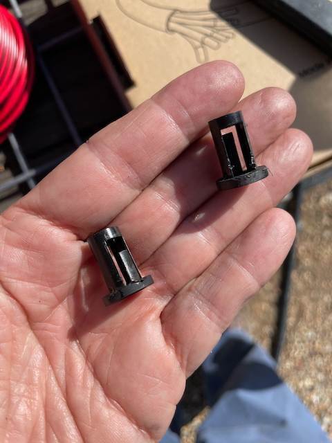

These are the grommets that come with the Dexter Axles -- the wires pass through these from left to right side of axle. NOTE that they have sprung tabs on them to keep them in the axle; when you try to remove them, the tabs break off. They are not rubber grommets they are stiff plastic. I tried to replace the missing one with a rubber grommet (I cut it to place it around the existing wire) but my rubber grommets were not deep enough to cover the thickness of the axle. These two came from a new Dexter axle that John ordered.

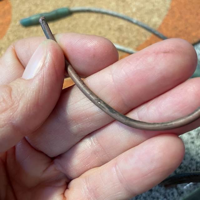

This is one of the nicks in the wire where it passed through the hole in the axle without a grommet. There was a larger section of exposed copper, but I can't find it this morning.

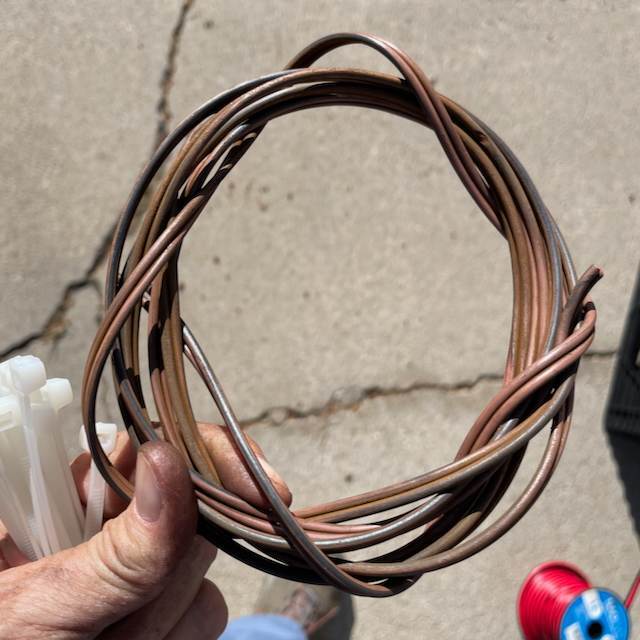

This is the brake wire pulled from the front axle; I didn't see melted insulation nor other nicks exposing the copper here. (The original rear axle wire is still inside the rear axle --EDIT: but it is cut loose from the brakes. There's a new brake wire run outside that axle as well.)

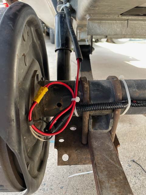

The front axle with new wire from left to right brake assembly.

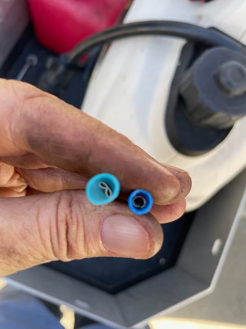

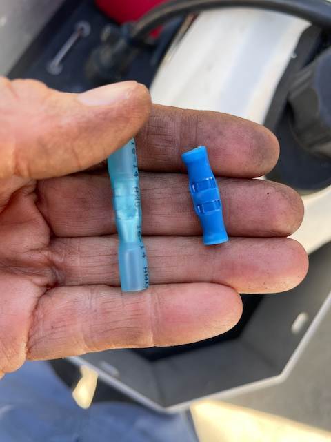

buttconnectorscomparison(1).jpeg.0f93612bbf4fb0d95523906b33480b7c.jpeg   buttconnectorscomparison(2).jpeg.7457453c7ac37518691adc6a5238294f.jpeg
Butt connectors (both images after crimping); the new heat-shrink style on the left didn't hold the wire at all -- it pulled right out. The old style held, but is not weather-proof. They are taped for now. I'm seeking a good quality liquid tape or other product to address this.

John and I don’t think the wire pulled from the axle looks like the culprit (though only the wire from front axle was pulled, the other is still in there, cut free)… only the small section near the hole with missing grommet was nicked. However, there were no warning messages yesterday. Today will be a longer tow, and I will keep the forum updated.
UPDATE: It was about 650 miles from Prescott AZ to Cimarron NM, with zero warning messages, but it's still not definitive -- I will tow 300 miles in about a week, and another 500 miles the following week. Remembering that I towed 1,000 miles without these messages at the beginning of my trip, I believe time will tell.

On our last day together, I checked the 7-pin female receiver on the truck side. It was a strange assembly! The female socket was merely pressed into the bumper opening (not bolted), with only plastic tabs keeping it in place! Then the 7 wires were terminated in a plastic terminal that snapped into the backside of the receiver. These two parts were very loose, not strongly connected.
It gets me the GMC design does not have this connection hardwired. I gave it a good shake, moving it back and forth and rotating it the terminal. Maybe I cleaned up the connections (temporarily) since @Boudicca908 did not see the error message in the next 2 days towing.
If it was my TT and TV, I would replace the 7-blade connections on both sides! replace this female receiver with a part that has a short wiring harness fused to the socket. Then replace the Oliver male plug and cable all the way back to the junction box in the bathroom vanity. Purchase both male/female sides from the same quality manufacturer for the best pairing.
Anybody know of a good supplier for quality parts? It's hard to read through all the Amazon offerings and eTrailer wasn't much better. Who makes the best 7-blade connectors? It's not what OTT used on this 2022 hull.
The other thing I learned is there are two types of 7-blade connectors (see pic). One has a single blade which I've used for decades, and another must be a newer style where there are two (IMO flimsy) blades. All of my trailers, including our hull #113 has the older single blade style.

Oh boy. This entire thread sounds so similar to my own brake issues with hull #110.  Nearly two years of doing similar checking & replacing.  I should have just listened to others on this forum from day one, and pulled BOTH brake wires from the axles.  Did I do BOTH at one time?  Of course I didn't, I'm a nuckle-dragger.  I got stopped by rain after finally pulling out and replacing the wire on the rear axle (this year), then still having brake issues with the truck, I finally got to doing the front axle.   OMG!!!  The wire in my front axle was an ABSOLUTE frayed mess in several locations.
Once I had both new wires on the outside of the axles, I've not had an issue since.  Now towing with my new-to-me 2024 F-250.  No issues.
But, I will say, doing all that troubleshooting and replacing 7-pin connectors and inspection the 7-pin wire connector to the trailer and redoing connections a few times.... well, I'm much better and braver now for it.
WHEN the next person inquires about intermittent brake issues.  Please have them pull BOTH break wires from the axles and save them many hours of troubleshooting.  I think it should be the first step after checking basic voltage at the break assemblies.  Just my 2cents.
