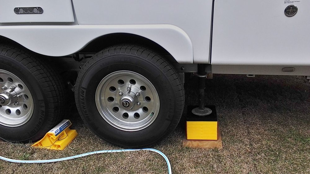

Try2Relax Posted March 6, 2017 Posted March 6, 2017 Do you level the jack contact surface, before putting pressure on it? Example, last year I was in such a sloped spot that I side stacked my 6x6 blocks and put about 2-3 inches of my wheel chalk under one end to get the contact surface level before jacking. The setup of the Oliver system is rigid and 90° angles, class A jacks tend to have a floating head, as such the jack contact surface should be level to the trailer frame when done. As Steve mentioned above, the frame/mount will be under excessive twisting stress if forced to lift and support the weight on an outward angle. Randy One Life Live It Enjoyably 2017 F350 6.7L SRW CC LB 2015 Oliver Elite II Hull #69
Moderator+ ScubaRx Posted March 6, 2017 Moderator+ Posted March 6, 2017 Do you level the jack contact surface, before putting pressure on it? ... As Steve mentioned above, the frame/mount will be under excessive twisting stress if forced to lift and support the weight on an outward angle. I do try to provide a level surface to put my blocks on. Usually that only requires brushing away any rocks or debris that would not let the block sit solidly on the ground. I have never had to dig any dirt away. Again, our rear jacks are rarely extended over four inches or so. It's rare that the tires are off the ground. We even set the front jack on about 8 inches of block to keep it from being over extended. This manner of leveling our Oliver's have served us well and without problems for over 9 years of use. We have found the message in Matthew 7:24-27 to be useful when parking the Outlaw Oliver. In other words, be careful about parking your Oliver alongside a river with a sandy beach during a four day rain event. 2 Steve, Tali and our dog Rocky plus our beloved dogs Storm, Lucy, Maggie and Reacher (all waiting at the Rainbow Bridge) 2008 Legacy Elite I - Outlaw Oliver, Hull #026 | 2014 Legacy Elite II - Outlaw Oliver, Hull #050 | 2022 Silverado High Country 3500HD SRW Diesel 4x4
KarenLukens Posted March 6, 2017 Posted March 6, 2017 Do you level the jack contact surface, before putting pressure on it? Example, last year I was in such a sloped spot that I side stacked my 6×6 blocks and put about 2-3 inches of my wheel chalk under one end to get the contact surface level before jacking. The setup of the Oliver system is rigid and 90° angles, class A jacks tend to have a floating head, as such the jack contact surface should be level to the trailer frame when done. As Steve mentioned above, the frame/mount will be under excessive twisting stress if forced to lift and support the weight on an outward angle. I've shoveled lots of times but this time it's sitting on a new lawn at a new house. The street side tires are both off of the ground and spin freely and that's fine because there's no loss in strength on this side of the trailer. Notice that I put the Camco blocks upside down always when using them under the jacks, giving the jacks a flat surface to sit on. Then I always use ast least one of the oversized plywood blocks as a base, when on dirt or lawn. The large blocks help keep the trailer level longer when set up on a dirt pad because the jacks don't have the chance to sink in. I stuck the water hose under the one tire just for the pic. I just want to say that, having the door get jammed up is really such a common occurrence that you guys need to understand that it's not anything to worry about because it's just a simple part of RVing :) 1 Happy Camping, Reed & Karen Lukens with Riffles our Miniature Poodle 2017 Oliver Legacy Elite II Standard, Hull #200 / 2017 Silverado High Country 1500 Short Bed 4x4 Past TV - 2012 Mercedes-Benz ML350 4Matic BlueTEC Diesel Click on our avatar pic above to find the videos on our Oliver Legacy Elite II
rideandfly Posted March 6, 2017 Posted March 6, 2017 We use wood blocks under all of the Ollie jacks (when using all jacks) to make the Ollie stable. Making the Ollie exactly level is not a goal for us. Many times the only jack we use is the front jack with chocked wheels for one night stays while en-route. Understand sometimes you only have one place to park and it's not close to level like some of the mountain sites we camp on. Used to place our previous TT (single axle wheel) up on a block on the low side with all wheels chocked and extend the stabilizers for stabilization. When we encounter the same type of sloped mountain site this summer, will do the same with the Ollie. 1 Bill 2015 LE2 2024 F-350 6.8L

GaryJona Posted March 7, 2017 Posted March 7, 2017 Ok I will put in my 2 cents. We have had our Oliver for over 2 years now and been across the US several times and from Florida to Alaska this past summer and have never placed my Oliver in such a way that my Doors or anything becomes stressed or stuck. When I level the trailer I use either 2 x 8 ramps or sometimes the leveling stackable blocks being described in the post. The rear jacks I only those to stabilize the Trailer when parked in a site and I do place blocks under them for two reasons one to stop sinking into soft or wet ground and second to shorten the distance they travel. We bought the rubber horse stall matting they use in stables from Tractor Supply by the foot and cut it into squares to use under the blocks for on uneven or rocky ground, stays better and saves the plastic blocks. I from day one have worked to not tork or twist my frame to any measure. I just replaced my bearings and put the new Dexter easy flex equalizer on the axles and used a floor jack at the steel section at the wheels to lift the trailer and the jack stands under the wheel bracket while working on it. The Hydralic jacks on the Oliver were my back up safety not my primary lift. Will the rear jacks lift the trailer.... Yes they will, would i use them to level the trailer maybe on a minor off level campsite but I just check the bubble when I pull in and just use the blocks on the wheels an extra 5 minutes to set up. I will even use my blocks in a overnight in a Walmart, Cabela's where ever for the betterment of the Frig and my wife not rolling out of bed. Thanks Gary 3 Gary & Jona 2016 Silverado 2500 Diesel Legacy Elite II Hull 81
