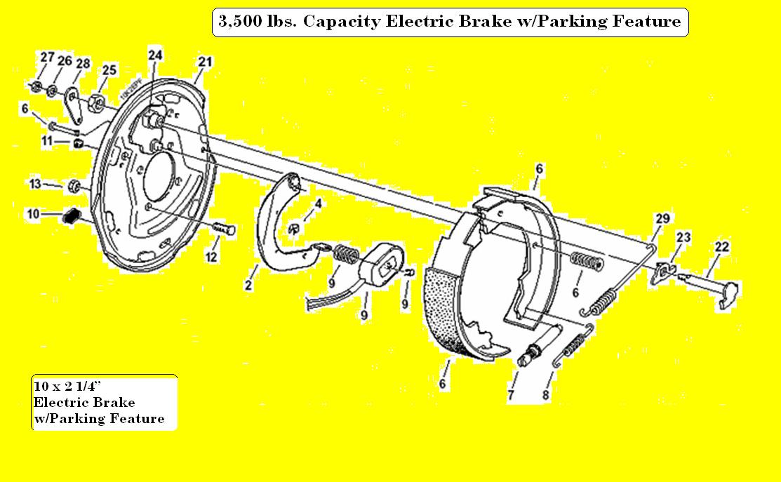

Angus Posted November 26, 2017 Share Posted November 26, 2017 I just read through the comments on emergency chocks and have a few rookie questions: Is there a way to "engage" the brakes on the Oliver once you have the chocks set? Can the breakaway cable be pulled to "set" the brakes? Would the above be a bad practice or cause harm to the brakes while at rest? Thanks, Peter Link to comment Share on other sites More sharing options...
Moderators Mike and Carol Posted November 26, 2017 Moderators Share Posted November 26, 2017 I’m no expert, but I did stay in an Oliver Travel Trailer last night.... I think the short answer is that you don’t want to engage the brakes on your trailer when stopped. The breakaway cable is for emergencies. The brakes are electric and if you pull the breakaway cable the brakes would activate and would start discharging your batteries. Not sure how you inactivate them once you do that, or if the activator is adversely affected. One of the technical experts will know. We use regular chocks on all wheels if we’re level. If we have to raise one side on our legos, we use the “between the wheels” gadget on that side. Works well. Mike 1 Texas Hill Country | Elite II #135 | Ram 2500 6.7L Link to comment Share on other sites More sharing options...
Moderators topgun2 Posted November 26, 2017 Moderators Share Posted November 26, 2017 Yep - Mike's basically got it right. Since the brakes are activated electrically, the only way to keep them activated is for electric current to constantly be applied to energize the magnet that in turn causes the brake shoes to press against the inside of the brake drum. Unfortunately, once the current is turned off the brakes are no longer "applied". Therefore, if you energize the brakes by pulling the emergency breakaway cable and your batteries run out of juice then your trailer is no longer in "park". Chocks are simple and effective - all you have to do is remember to use them. Given that the penalty for not using them could be very severe (destroyed trailer and even possible death) it pays to be VERY careful in making sure that chocks are used. Bill 1 1 2017 Ford F150 Lariat 3.5EB FX4 Max Towing 2016 Oliver Elite II - Hull #117 "Twist" Link to comment Share on other sites More sharing options...

John E Davies Posted November 26, 2017 Author Share Posted November 26, 2017 Peter, Dexter does in fact make drum backing plates with a “parking brake feature”. Instead of a round top post for the shoes to rest against, there is a cam with two flat surfaces, and a shaft that extends to the inside surface of the plate. On the shaft is a short arm or lever - number 28 in the drawing. This is designed mostly for offroad/ military utility trailers. The system requires a brake lever at the front of the trailer, usually on the tongue, plus cables that run back to the brake parking levers. You simply pull up on the brake lever and the shoes on one (or more) axles are engaged hard. You can leave the brakes set indefintely. Even with a parking brake setup, you should always chock the wheels, just in case. My rule is “Chocks under both sides of one axle, always, before uncoupling from the tow vehicle...” Never ever unhook the trailer without making darned sure it cannot roll. This is the sort of situation where a parking brake would be very helpful - turning around on a nasty jeep trail that is only 10 ft wide.... John Davies Spokane WA "Mouse": 2017 Legacy Elite II NARV (Not An RV) Two Beds, Hull Number 218, See my HOW TO threads: https://olivertraveltrailers.com/topic/john-e-davies-how-to-threads-and-tech-articles-links/ Tow Vehicle: 2013 Land Cruiser 200, 33" LT tires, airbags, Safari snorkel. Link to comment Share on other sites More sharing options...
