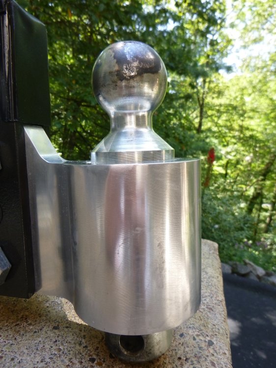

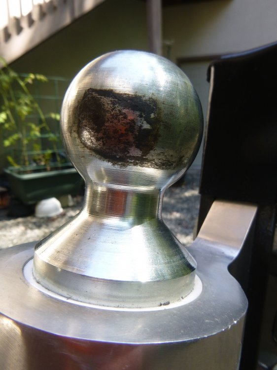

Hi, I have a new Oliver Legacy Elite II travel trailer, purchased new 05/15/17. It currently has 4100 miles on it. It came from the factory with a 2 inch/ 7000 pound Bulldog coupler bolted to the aluminum tongue. The inside of the socket has two raised areas that are destroying the balls.
I first used a 2 inch chrome ball and towed for about 3200 miles as a dead weight. Tongue weight was about 650 pounds. Wear was bad, but tolerable since the ball only costs $10.
Now I have an Anderson weight distributing hitch. In just 700 miles, the forward thrust of the chains is VERY SEVERELY wearing the 2 inch/ 10,000 pound Anderson ball where the raised pressure points are in back. This is unacceptable since a replacement ball is $50 plus shipping.
https://andersenhitches.com/Products/3382--wd-2-replacement-ball-tapered-10k-gtwr.aspx
I have kept the ball and coupler lubed with synthetic grease but it does not appear to help.
I need to know if I can get a replacement coupler sent at no charge under warranty, and also a reimbursement for the purchase of a new Anderson ball.
Is the wear I am experiencing unusual? I have seen NO mention of this on forum discussions.
Also, with a new coupler, can I manually “lap” the ball and socket together by using an old ball and valve grinding compound, to eliminate the high spots before towing? Or is there another way you recommend to prevent the coupler from abusing the new ball?

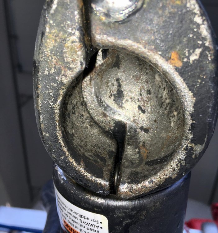

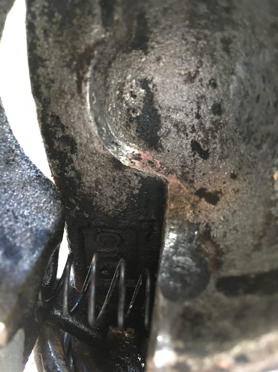

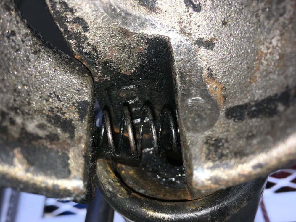

I have experienced a similar wear pattern as shown in your pictures, and probably have fewer miles towing than you. The wear showed up after the first 500 miles, towing with a dry ball per the Andersen recommendation. I too sent an email to Andersen, c/o Justin in customer service. His reply was in the nature of "Oh, that is normal, they all do that."
Since then I have been greasing the ball, but I don't think it has helped much. The reason I can say this is that when I replaced the brake lining cone under the ball (due to excessive groaning) I rotated the ball 180 degrees to present a new wear surface. Sure enough, after the next trip there was fresh wear on the "new" back side of the ball, even though I had given it a good coating of grease.
At this point I don't know which component is at fault. One could blame the bulldog coupler as destroying the Andersen hitch ball. One could also say that the Andersen hitch ball has been inadequately surface hardened. I don't know what the Brinell hardness of the coupler and the hitch ball are, but I bet some nitriding of the ball would improve its resistance to wear.
I think the root cause is the use of bolt on components without a real understanding of the issues raised when they are used together. Some time ago I sent an inquiry to the folks at Bulldog and told them I would be using an Andersen hitch which by design would put an extra 4000 lb horizontal load on the coupler. It didn't appear it was something they had ever thought about, and their reply suggested that, to be on the safe side, I should use their 2 5/16" coupler rated at 12,500 lbs vice 7000 lbs.
I don't know what the real solution is. Seems to me it might involve some combination of better surface hardening of their hitch ball by Andersen, and use of the 2 5/16" coupler by Oliver (which would not cost any more). In any event I have stayed calm believing that if the wear on the ball became excessive, Andersen would (I hope) replace it under their lifetime warranty on the hitch. They have been very stand up with respect to brake lining cone replacement.
It might be helpful if Oliver had a conference call with Bulldog and Andersen with a goal of improving the compatability of the two components. I look forward to seeing how this turns out.

Well it is great to see that John is hooking his Andersen WD up properly. Unfortunately the wear on the ball is normal when our hitch is used as designed. With the chains correctly tensioned the coupler does push on the back of the ball and will leave evidence of that. With our WD hitch and a regular coupler the locking claw leaves a (smiley face) in the chrome plating because the ball is designed to be softer than the claw so the trailer is not having excessive wear in inconspicuous safety related spots. It seams to wear rapidly at first then it stops once the initial wear has settled in. Anytime there is metal on metal friction there will be wear, even with grease. As we can see from John's original ball, the difference is where it happens. Is it on the top and front of the ball with a traditional hitch or is it on the backside with the Andersen? If the ball is harder than the coupler the ball will not show much sign of wear but the inside of the trailer coupler will, however; that often goes unnoticed until it is to late.  With the design of the Bulldog coupler there is a different wear pattern on the ball and it should wear to a point similar to the photo John provided then neutralize. This should not affect the performance or the safety of the connection at all.
As John requested, here are a couple of pictures of my ball.  This ball has about 4,600 miles on it.  While it is difficult to tell from the pictures, I do not consider the wear to be excessive - it appears to me that basically the chrome plating has worn in the spots shown, but, there are no real gouges or divots that would indicate to me that anything was amiss.
It's impossible to get away from wear when you have a forged, two piece coupler on a machined ball.  Under normal circumstances, this would be predominantly on the top area of the ball, due to the tongue weight down force.  This is where mine shows wear and it was expected.  But with the particular design of the Anderson, there is a very large and constant forward force applied to the ball.  The Bulldog coupler doesn't seem to really be designed for this, but is perfectly capable of handling it as long as the sliding sleeve does it's job.  The way the two forged pieces come together to enclose the ball doesn't describe a perfect spherical shape to match the ball and there has to be some grinding.
Load leveling hitches in general put a lot of force of the coupling/ball interface.  Anderson used to say not to grease this interface, but I've recommended to always grease it.
Bottom line:  There will always be wear with this design.  The chrome finish is the first to go.  The ball and socket fit will never be perfect.  Wear will be much faster with load leveling than with a simple coupling.
I've never been a big fan of the Anderson design, but with the tongue design of the Oliver and the factory offering only this brand and design, it seems there will have to be some maintenance or replaced parts occasionally.
I doubt anyone really needs one of these special hitches as the Oliver is incredibly stable by nature.  Heavier rear springs or air bags would handle the tongue weight more efficiently than the awkward geometry of the tensioned chain design.  If damping was needed, and I doubt it is, a strut design might be better than the cone clutch and chains of the Anderson that seems to always be making too much noise and need replacement.

Sage, the wear you posted is not the same as the wear I am experiencing. Mine is highly concentrated in one area and it is eating out a deep canyon in the steel. There is no way that this can be considered "normal".
I heard back from Bulldog and the only way they will do any kind of warranty exchange is if I send them the coupler and the Anderson ball for "evaluation". The rep did say that the coupler should not wear the ball like that if kept lubricated. He did not address my questions about the special way the Anderson "back loads" the ball very heavily.
There is no way I will risk having my trailer inoperative during the summer - I have many trips planned. I will send them the two parts late this Fall and see what happens.
I plan to ask them to send me a 2 5/16 inch 10K coupler, and I will order a 2 5/16 inch Anderson ball. I hope that the larger surface area will mitigate the wear. I also plan to do some very close inspection and testing with Dykem machinist layout dye to find the high spots on the coupler and then either grind or lap them down, BEFORE towing.
Hopefully my existing coupler is a bad one. I can't imagine them all being that roughly forged inside the ball cavity.

It depends on what you describe as "normal".  I consider what you are experiencing as normal considering the design. Anderson proudly says their balls are soft, so wear will happen.  The ball turns with the coupler in this design, so the wear will be concentrated in one spot.  It would be even worse if you followed Anderson's original recommendation to NOT grease the ball.  The Bulldog coupler is not accurately machined to fit a ball precisely, so you will get wear in spots.  This is not a defective coupler as it is never a problem with a hardened ball with a downforce from the coupler.  And finally, the Bulldog is not designed to be used with the extreme forward push the Anderson hitch applies to it.  It can take it, as it is a good design, but that is not a force it is set up for.
Not to be too negative, but when you look at the history of the Anderson hitch and the comments they make about how to use it and their responses to problems, it seems obvious it's not a perfected product.  They do stand behind it, but the public is doing the Beta testing for them.
The frame clamps are marginal, the balls are soft and wear, the geometry of the chain design gives limited weight distribution, the friction/sway clutch fails and has been a big problem with lots of warrantee replacements, first they recommended no grease on the ball and then they said to grease it, they have even recommended  turning off the stability control on the TV if  your vehicle is unstable while using the Anderson, etc.
Don't blame this on Bulldog.  Their couplings are very strong and a bit crude, but they will go forever with a good ball and no heavy and continuous forward load.   If you want to reduce the localized wear on the ball, best to grind the inside of the socket to better match the ball in the wear area.  Just don't be surprised that this is happening.
Makes sense. I learn something interesting and/or helpful every time I visit this forum.
