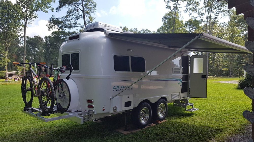

Other than the Oliver-installed bike rack it is my understanding rear-mounted bike racks are not only unsafe for the bikes but create a possible hazard for vehicles traveling behind you. There are multiple posts here regarding bike racks. Through online research (google and youtube videos) I discovered that mounting a bike rack to the back of your tow vehicle is the safest way to go.
roguebooks 2020 Ram Classic 1500 Warlock 4x4 Hemi V-8 2018 Legacy Elite, Hull #309  ALARCOFLINKYLAMIMSMONMOKTNTXsm.jpg
Ross is going to attempt an inside “bike rack” that will hold the bikes upright in the aisle of the Oliver, similar to what you sometimes see in the back of trucks. I will report back on our success/failure at this effort.

Definitely get the Oliver rack - it's really solid. You might ask them about just getting the base and then adding your own rack to it, which is what we did, though the rack they supply is good quality.
I would be really interested to see if this works, but I have doubts that you will ever be able to maneuver past a couple of bikes secured to the floor, to the back of the cabin. Pedals and other hard points will scrape, tear and soil the interior, plus the mount will be a real toe knocker when the bikes are gone. I just can't imaging it working very well in such a narrow isle. In a full sized van, it can be great.... Good luck and please post pics of the experiment!
Any competent welder who is comfortable with aluminum (not all are!) can build a custom bolt-on bumper bike/ storage rack like the Oliver one, to your specifications. Don't even think about welding it to the frame! Consider the high shipping cost if ordering from the factory. If I made one I would be sure to include red LED turn and running lights and an expanded metal floor. plus tie down loops. Be aware that the rear of the trailer is its most dirty/ wet location when moving fast. Nice bikes or equipment need to be covered. If you don't have a backup camera, you will definitely want to install one to keep an eye on the bikes as you travel on bumpy roads! "HEY, didn't there used to be two bikes back there?!"

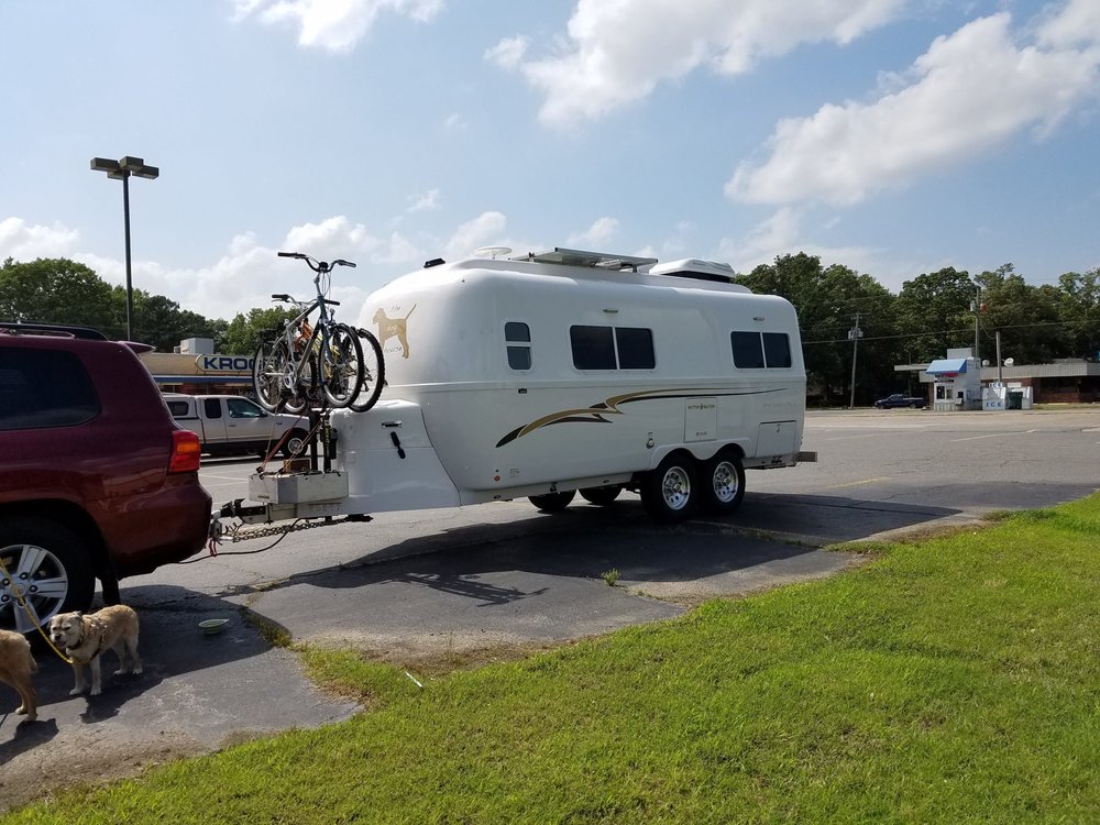

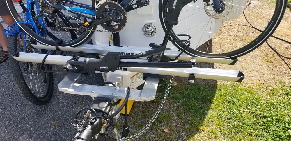

Someone at the Rally had built one for the front of their trailer that was very nice. I'm sorry I don't remember who but hopefully someone will chime in who does. Bill? Jason? Foy?

Duke took a photo of the bow mounted bike rack. It was an entry in the modification contest at the Rally. I'm sorry I don't have more information. Again, hopefully, someone who does will give us the details.

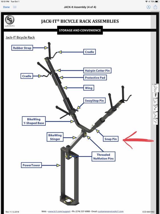

Since you already have the bike wing rack, you might think about this mount.  It’s the Lippert version aka “Jack-It”.  I don’t think you can buy the tower alone, but you could think of something along those lines.

Watched a video from the manufacturer site and the “jack-it” seems to have a lot of deflection (wobble) when the vehicle/trailer is in motion. The unit is a novel idea but have you found excess or concerning wobble in yours?

Does the jack-it tower sway as much as it appears to do in the manufacturers video?
thanks,
Garry
There really isn’t any movement in tower on my install, but I modified my installation from the stock instructions.  All of the movement happens above the Snap Pin, marked by the red arrow.
If you would like more detail, let me know.
