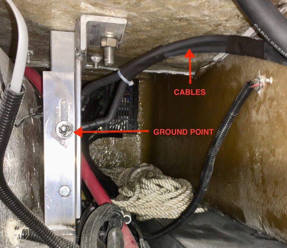

Matt, so I grounded my inverter at a different location than the bulletin requires. Will my cables have to be completely reworked to meet the exact wording of the bulletin?
My TWO big 4AWG cables are grounded at the battery support pillar (which is welded directly to the frame at the bottom). It is as good a ground point as the stud described in the bulletin.
I just hate to see my good work ripped out if it is OK, because as an ex-A &P mechanic I know my work is of better quality than the typical RV tech. I have seen the kind of work some of them do and it can be very ugly.

Matt, so I grounded my inverter at a different location than the bulletin requires. Will my cables have to be completely reworked to meet the exact wording of the bulletin? My TWO big 4AWG cables are grounded at the battery support pillar (which is welded directly to the frame at the bottom). It is as good a ground point as the stud described in the bulletin.
John,
From the looks of where you grounded on the support beam, I'm not sure if that support is welded to the chassis. I haven't personally looked yet on a unit, but I will check.  In any case, we would recommend moving the grounding point to the chassis ground stud.

Matt, the battery box support on my trailer (#208) is not welded to the frame. There is a 1 1/2 x 2 x 8 inch aluminum angle attached to the body. there are two self drill screws holding this angle to the body and the support leg is welded to the angle. The angle is resting on the insulation. Probably the two self drill screws go through the fiberglass and into the frame. The #2 welding cable that I used for the ground is attached to one of the two 1/2 inch rear jack mounts attached directly to the frame. The ground tab you speak of is also attached to the frame with a 1/2 inch bolt but, already has two other grounds attached to the 1/4 inch stud. Due to the potential levels of current possible, I wanted to keep the ground length short and use a fairly large cable. I also feel that the 1/2 inch attachment will carry more current than the 1/4 inch stud. Remember that the minor diameter of a 1/4 x 20 screw is only about 3/16 or so. Not much surface area to carry a large current. Not to mention the metric stud on the inverter. It’s minor diameter is really closer to 1/8 inch or so (only a rough guess as I didn’t look up the minor diameter specs of either 1/4 x 20 or the metric version). My guess is that the small studs will melt long before the #2 ground cable will even get warm. My welder uses #2 cable and I can use (melt) 3/16 rods all day.

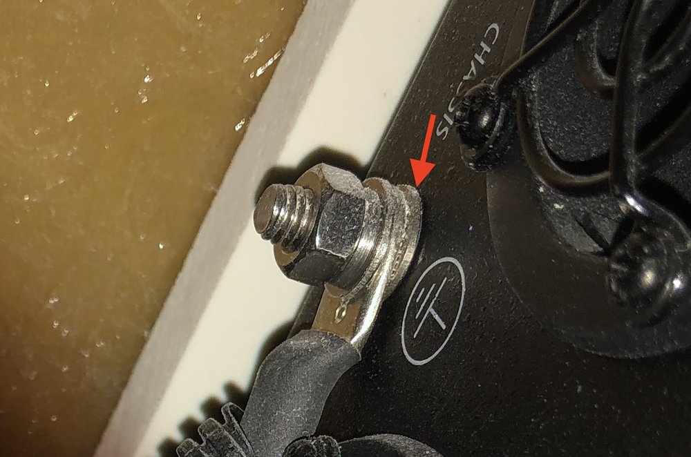

When Matt Duncan posted details about the problem I realized that I did not know whether my grounding cable had a flat washer installed between the ring terminal and the inverter. I could not see well enough back there. So I went back to the trailer and put my cell phone down there and took enough photos that a few were in focus.
Hmm. Not clear. I see this metal ring, indicated with the red arrow. Is that a flat washer, or part of the terminal on the inverter chassis? I am going to have to unscrew the nut to answer this question.

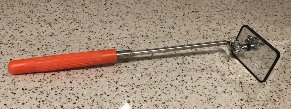

Oliver offered to pay for an RV tech to look at this, which is really good. But I figured I could handle this, saving Oliver $150 and avoiding the hassle of scheduling the RV tech.
Matt Duncan’s instructions had a bunch of good safety guidelines. Pop the circuit breaker, unplug 30 amp power cord, disconnect battery cables from the inverter. I did not do any of those. My Ollie is under cover when in storage, so no solar when in storage, so I have a battery disconnect switch. With the battery disconnected, I figured there are no electrons coming into the inverter, and so I did not follow any of Matt’s procedures for electrical isolation. (If I am wrong about this safety consideration, I know a wiser forum user will speak up!)
I used a 10 mm socket wrench to loosen the nut, and then hand loosened the nut further, being careful not to take it all the way off and have nuts and washers spill to the bottom of the compartment. I could not convincingly determine whether my unit contained the problematic washer, either by touch or with my mirror. However, a cell phone photo shows that the metal ring is part of the terminal on the inverter chassis. No washer. Tighten up the nut, and all is good.

Hmm. Not clear. I see this metal ring, indicated with the red arrow. Is that a flat washer, or part of the terminal on the inverter chassis? I am going to have to unscrew the nut to answer this question....
David,
Thank you so much for this!  We checked ours, Hull#268, and it looks like yours.  I was wondering the exact same thing, whether that was a washer or part of the terminal and was going to contact Matt about it.  I now know that ours is fine.  You have settled my mind.  This is why I love this forum.  Thanks again!
