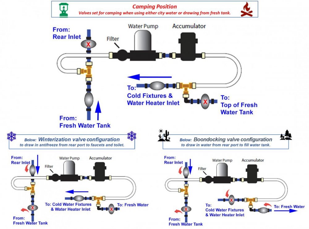

fritzfrangle Posted June 25, 2019 Posted June 25, 2019 Mike Where are the plumbing schematics located? I cannot find any schematics in my manual. Thanks Neil Neil & Diana Living full time in our Oliver traveling North America 2016 Oliver Legacy Elite II Raised Twin Bed. Hull # 138 2020 F250 4x4, Supercab, Longbed, 7.3 gasser
Moderators topgun2 Posted June 25, 2019 Moderators Posted June 25, 2019 Neil - Go to Travel Trailers in the blue banner above, then go to the bottom of the page under Oliver University. Next click on Legacy Elite II, find your model (2019 models are first up on the list) and click on that model. Under the index will be a list of items to include plumbing and under that you will find the page where the plumbing schematic is located. Bill p.s. I just noticed that your Oliver is a 2016. There is no schematic in that owner's manual. However, while there have been some "slight" changes, the schematic for the 2019's is really not all that different from the 2016 model. At least it should give you a good general idea of what is where. 1 2023 Ford F150 Lariat 3.5EB FX4 Max Towing, Max Payload, 2016 Oliver Elite II - Hull #117 "Twist" Near Asheville, NC

fritzfrangle Posted June 25, 2019 Posted June 25, 2019 Bill, Thank You. I will download the 2019 plumbing schematic. Neil Neil & Diana Living full time in our Oliver traveling North America 2016 Oliver Legacy Elite II Raised Twin Bed. Hull # 138 2020 F250 4x4, Supercab, Longbed, 7.3 gasser
Moderators mossemi Posted June 26, 2019 Moderators Posted June 26, 2019 [postquote quote=177210][/postquote] Sorry I missed your question about the plumbing diagram. Let us know if you have any trouble finding it. Mike Mike and Krunch Lutz, FL 2017 LEII #193 “the dog house”
Moderators topgun2 Posted June 26, 2019 Moderators Posted June 26, 2019 In addition, Cedarforks did some really nice schematics of the plumbing system. You might want to PM him in this regard. Bill 2 2023 Ford F150 Lariat 3.5EB FX4 Max Towing, Max Payload, 2016 Oliver Elite II - Hull #117 "Twist" Near Asheville, NC

Galway Girl Posted September 24, 2020 Posted September 24, 2020 On 6/25/2019 at 3:17 PM, fritzfrangle said: Bill, Thank You. I will download the 2019 plumbing schematic. Neil Neil, Here's an updated diagram I created to augment the 2019 EII Manual. This "might work" for your 2016, but given the changes often made, you may want to use it as a reference. I can send you a version for yours marked up if you find it's different in a 2016 after inspection. I have this as both a PDF and JPG...and can edit it for you as needed. Craig Short 2 2019 Elite II (Hull 505 - Galway Girl - August 7, 2019 Delivery) Tow Vehicle: 2021 F350 King Ranch, FX4, MaxTow Package, 10 Speed, 3.55 Rear Axle Batteries Upgrade: Dual 315GTX Lithionics Lithiums - 630AH Total Inverter/Charger: Xantrex 2000Pro Travel BLOG: https://4-ever-hitched.com Lower 48 + Alaska Achieved in Maine in Aug 2024 on way to Nova Scotia.
Galway Girl Posted September 24, 2020 Posted September 24, 2020 On 6/25/2019 at 3:53 AM, fritzfrangle said: Forgot to mention this thread on Alternate Plumbing Diagrams has some good updates from various Forum Members... 2 2019 Elite II (Hull 505 - Galway Girl - August 7, 2019 Delivery) Tow Vehicle: 2021 F350 King Ranch, FX4, MaxTow Package, 10 Speed, 3.55 Rear Axle Batteries Upgrade: Dual 315GTX Lithionics Lithiums - 630AH Total Inverter/Charger: Xantrex 2000Pro Travel BLOG: https://4-ever-hitched.com Lower 48 + Alaska Achieved in Maine in Aug 2024 on way to Nova Scotia.
Going Posted September 25, 2020 Author Posted September 25, 2020 Craig, thanks for the diagram. Mine is the 2017 Elite II. I knew the accumulator had been added but wondering what it does? Might add it to mine. Phil Drye Hull #246, 2017 Elite II

Galway Girl Posted September 25, 2020 Posted September 25, 2020 1 hour ago, Going said: Craig, thanks for the diagram. Mine is the 2017 Elite II. I knew the accumulator had been added but wondering what it does? Might add it to mine. An accumulator tank is a water chamber which has a pre-pressurized internal air bladder. They are installed on the pressured side of your pump and dampen water pressure 'spikes', reduce pump cycling, help increase the pump's life and also save battery power. 4 2019 Elite II (Hull 505 - Galway Girl - August 7, 2019 Delivery) Tow Vehicle: 2021 F350 King Ranch, FX4, MaxTow Package, 10 Speed, 3.55 Rear Axle Batteries Upgrade: Dual 315GTX Lithionics Lithiums - 630AH Total Inverter/Charger: Xantrex 2000Pro Travel BLOG: https://4-ever-hitched.com Lower 48 + Alaska Achieved in Maine in Aug 2024 on way to Nova Scotia.
