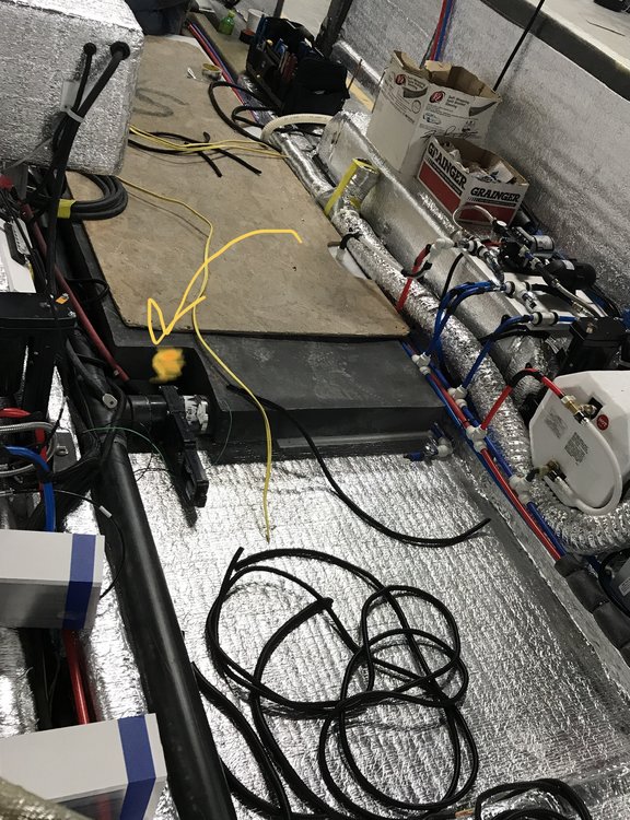

Townesw Posted May 4, 2019 Posted May 4, 2019 Is your trailer level when you are seeing the 100% reading or is the front elevated? The grey tank level sensor is located where the yellow mark is in the following picture. It is near the rear. Even if you only have a little water in your grey tank and the front is elevated the sensor could be seeing 100%. Bill and Martha 2018 LEII Hull 313 Original owners 3/14/2018 2019 Chevrolet 2500HD Duramax

Townesw Posted May 4, 2019 Posted May 4, 2019 Those tanks are long in length, narrow in width and short in height and the sensors are at the rear ends. You can be easily fooled by the readings. You will become accustomed to what you are putting in them and how often you need to dump and the display will mean nothing. Have fun. If grey water is not coming up through the shower drain you are good. Just be sure to close the valve beside the head before you move. 1 Bill and Martha 2018 LEII Hull 313 Original owners 3/14/2018 2019 Chevrolet 2500HD Duramax
