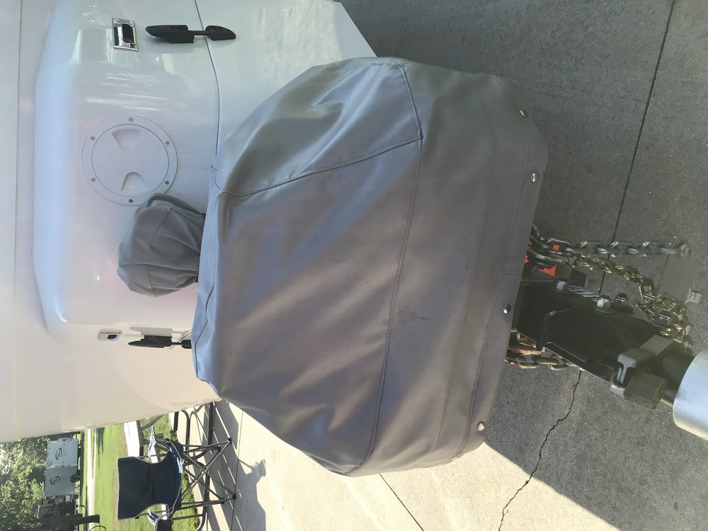

mountainoliver Posted June 20, 2019 Posted June 20, 2019 I carry/store my 2000w Honda generator and fuel in my basket. They are strapped down, locked and covered. 4 2017 Elite II, Hull #208 2019 Chevy HD 2500 Duramax

rideadeuce Posted June 20, 2019 Posted June 20, 2019 [postquote quote=175884][/postquote] Where did you order the custom cover with snaps? Would they make/sell another one... Perfect solution for my needs. Was it difficult to the install SS snaps on the aluminum cargo tray? Did you use Screw studs/rivets/threaded for the male stud? Thanks, Mike - Mike Brentwood, TN - 2018 Elite II - Spirit of Adventure Hull #308 - 2016 Toyota Tundra Limited 5.7L Class IV hitch with 12k lb coupler, Weigh safe adjustable trailer hitch, Dobinsons HD 2in Leaf springs, Timbren bump stops, Dobinsons 3in coilovers and UCAs, Mechman 370 amp HO alternator. Oliver upgrades: Starlink, Cradlepoint cellular modem, Victron Multiplus II 12V 3000W, Ekrano display, Orion XS 50amp DC/DC charger with Anderson connections, Toshiba 6-in-1 Microwave oven - air fryer combo, Atmos 4.4 15k AC/12K Heat pump, Nova Kool 5810 fridge, Epoch 460aH x2, 520 watts solar on top, Custom aluminum bicycle rack, Alcan Springs, Bulldog shocks, Falken H/T02 tires, Seabiscuit Metal Designs front storage box and moose rack.
mountainoliver Posted June 21, 2019 Posted June 21, 2019 The cover was a one off thing. I took the loaded basket to a canvas/upholstery shop at a lake. They make all sorts of covers, etc. for boats. I had to leave the loaded basket (generator and fuel can strapped in place) with them as they digitized the whole assembly and then fitted the cover. I also got a quote from an auto upholstery shop. Either one could do the work and you’d have to leave the loaded basket with them as well in order to get a proper fit. I used a heavy truck tarp material that is super strong but Sunbrella material would also be a good choice. The male snaps were ordered from McMaster-Carr, an industrial supply company, they are stainless steel with a (I think the size is) #8-32 stainless stud attached. Whoever makes the cover could supply the complete stainless snap assemblies. My basket is one of the older designs so it has a fairly heavy lower rail. I just measured evenly all around and drilled/tapped for the studs and installed them before I had the cover made/fitted. On the newer baskets, I would just drill through the sides close to the bottom and use nylon lock nuts on the inside for the male snaps. On a side note: Mike, if you’re interested I have a Firestone air bag assembly for a 2017 +/-Tundra which is like new. I used this only about 3-4 months until I traded for a different truck. 2017 Elite II, Hull #208 2019 Chevy HD 2500 Duramax
rideadeuce Posted June 21, 2019 Posted June 21, 2019 Thanks. Going to look for someone here locally to try and do something similar. Very nicely done. As far as the air bag, I am pretty satisfied with my current setup. I love my Tundra but I have had so much trouble with the dealership here that I am seriously thinking about getting a Dodge in a few years. May change my mind but plan on just using it without any more upgrades for now. Thanks for the specifics on the gen cover! - Mike Brentwood, TN - 2018 Elite II - Spirit of Adventure Hull #308 - 2016 Toyota Tundra Limited 5.7L Class IV hitch with 12k lb coupler, Weigh safe adjustable trailer hitch, Dobinsons HD 2in Leaf springs, Timbren bump stops, Dobinsons 3in coilovers and UCAs, Mechman 370 amp HO alternator. Oliver upgrades: Starlink, Cradlepoint cellular modem, Victron Multiplus II 12V 3000W, Ekrano display, Orion XS 50amp DC/DC charger with Anderson connections, Toshiba 6-in-1 Microwave oven - air fryer combo, Atmos 4.4 15k AC/12K Heat pump, Nova Kool 5810 fridge, Epoch 460aH x2, 520 watts solar on top, Custom aluminum bicycle rack, Alcan Springs, Bulldog shocks, Falken H/T02 tires, Seabiscuit Metal Designs front storage box and moose rack.

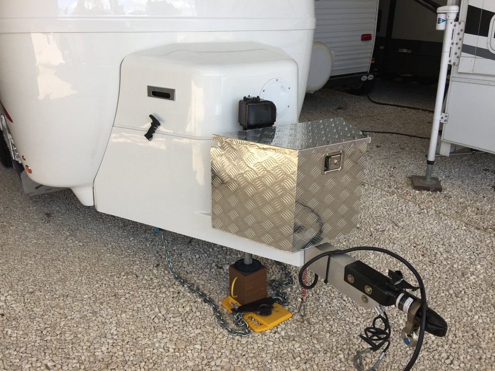

Trainman Posted June 23, 2019 Posted June 23, 2019 I passed on the front tongue basket upon our ordered unit, I may go with a tongue toolbox which I can keep the trailer setup stuff in as the side compartment on the trailer is not that user friendly for quick to get to items. I just need to look at the trailer tongue area and see how I can manufacture brackets that will fit over the fiberglass front panel, I'd rather not cut the fiberglass panel if possible. https://www.northerntool.com/shop/tools/product_200620947_200620947 I've seen this box on sale for $219.00, I've checked them out in the store and all seems to be done nicely, plus it does match the rear bumper somewhat. trainman 1 2019 RAM 1500, 5.7 Hemi, 4X4, Crew Cab, 5'7" bed, Towing Package, 3.92 Gears. Oliver was sold.
Moderators Mike and Carol Posted June 23, 2019 Moderators Posted June 23, 2019 [postquote quote=176829][/postquote] This what I did. I got mine off Amazon for a little over $100. I carry chocks, blocks, gloves, flashlight and an old towel in it. 1 Texas Hill Country | 2016 Elite II #135 | 2020 Ram 2500 6.7L

Raspy Posted June 25, 2019 Posted June 25, 2019 [postquote quote=176841][/postquote] Mike, I remember looking at your front box at the rally and really liking it! Very practical and a perfect fit. 1 John "I only exaggerate enough to compensate for being taken with a grain of salt." LE2 #92 (sold), Black Series HQ19
Moderators Mike and Carol Posted June 25, 2019 Moderators Posted June 25, 2019 Mike, I remember looking at your front box at the rally and really liking it! Very practical and a perfect fit. John 2015 LE2 hull 92 John, thanks. As we discussed, it was an inexpensive mod that works well for what I needed it to do. Having all the chocks, blocks, etc right there makes set up much easier. Mike Texas Hill Country | 2016 Elite II #135 | 2020 Ram 2500 6.7L
