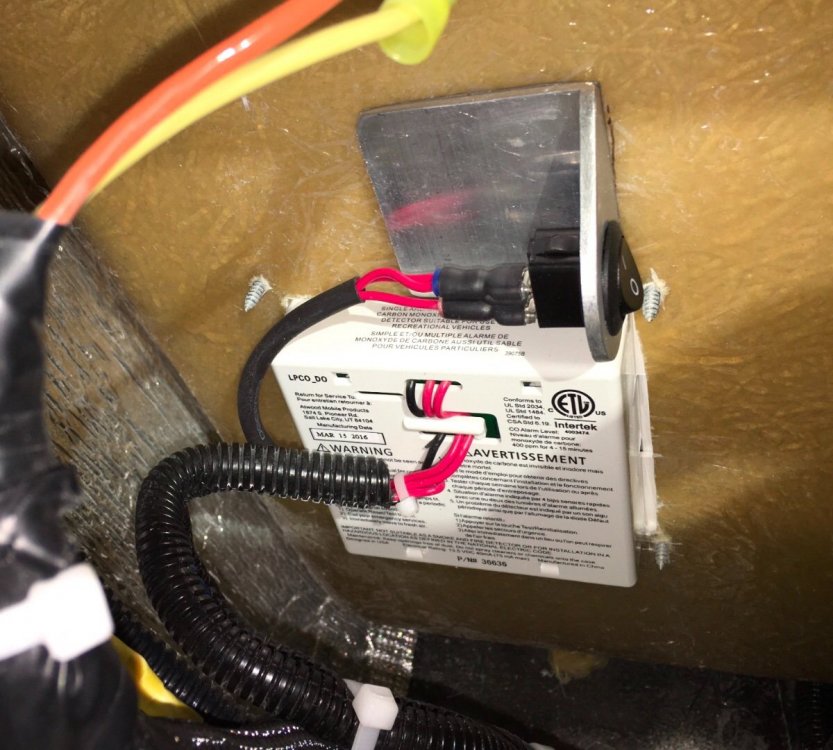

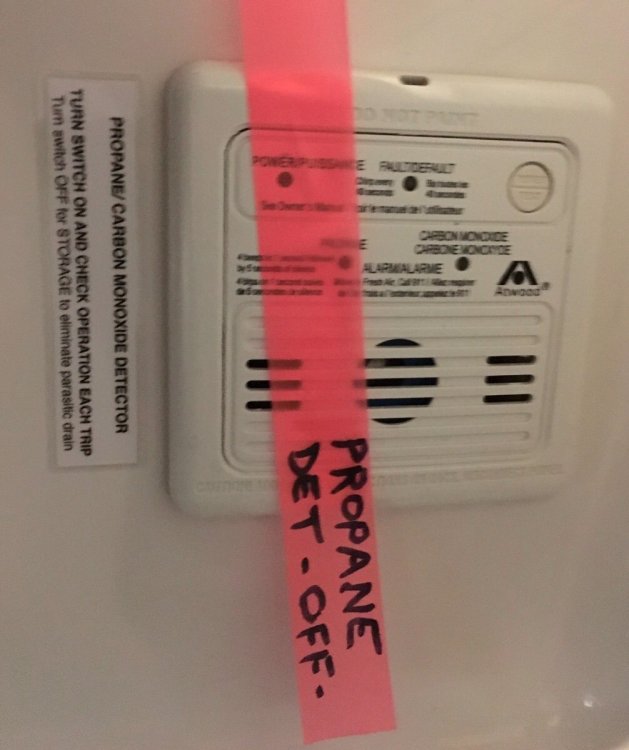

FYI, I added an ON/ OFF switch to my detector, partly in case of nuisance alarms, which hardly every happen, but mainly to eliminate the phantom electrical draw. A side benefit is that it should keep working a lot longer, maybe, perhaps. I flag the compartment when it is switched off, I can’t emphasize enough how critical it is to turn it on and test it before every trip.
https://olivertraveltrailers.com/forums/topic/5330-how-to-propane-co-detector-on-off-power-switch/
@John E DaviesIs that your original detector? It’s interesting to note that you have Hull number 218 and your detector was manufactured on March 15, 2016. I have hull number 313 and my detector’s date of manufacture is January 25, 2015.
Bill and Martha
2019 Chevrolet 2500HD Duramax
Yes, that is original. In your shoes I would be a little irritated that they installed an old unit. I bet Oliver does not rotate stock religiously. You put new inventory on the back of the shelf! However, I don’t think sitting in a sealed box will hurt the life span measurably, unless they keep these in a factory location near hull production, where there is a lot of airborne chemicals around….. It is exposure to some solvents that degrades or wrecks the sensor.
The actual 7 year service life before it goes into its crippled “end of life”  mode is determined by how long it stays powered on, which is why I think killing power to it routinely will perhaps make it function well for a longer time period. It does take three minutes to “boot up” when you turn it on each time. The red light flashes, then goes out after it warms up.
