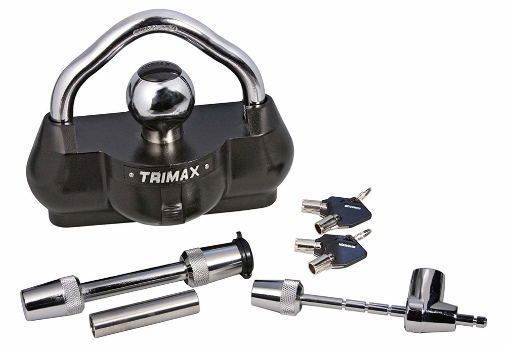

DavidS Posted August 17, 2019 Posted August 17, 2019 I’ve been looking for a locking pin, but everyone I’ve tried is too large to fit through the hole. In order to use the coupler lock I purchased, I needed to use a drill to enlarge the hole that originally held the coupler pin. I purchased the Trimax TCP100 Combo Pack, which includes three locks: a hitch lock, a coupler lock, and a receiver lock. I liked this kit because all three locks are "keyed alike," meaning they use the same key. The kit also included a rugged canvas carrying case. I put the hitch lock in the carry case when towing. When the trailer is in storage I remove the ball and ball mount from the tow vehicle, and I can fit them into the carry case. If you read through the forum you will find hitch locks that are more robust and more expensive than this one. I think any hitch lock is a useful deterrent, and I liked the keyed alike feature. Additionally, I’m having issues finding a hitch receiver that will lock the hitch to the TV. I’ve tried several, but they all seem to be about 1/8 inch too short. Note that there are several complaints on the recent reviews for this product that complain that the Receiver Lock is too short for a Tacoma. The Receiver Lock included with the Trimax TCP100 Combo Pack is the Trimax TS32 Universal Receiver Lock, which has a length of 2 5/8 inches. One of the reviewers with the Tacoma solved his problem by purchasing the Trimax T5 Extended Receiver Lock, which has a length of 3 1/2 inches. The locking part of the two Receiver Locks appears identical, so you should be able to swap them to keep the keyed alike feature. David Stillman, Salt Lake City, Utah 2016 Oliver Elite II Hull 164 | 2017 Audi Q7 tow vehicle. Travel and Photography Blog: http://davidstravels.net

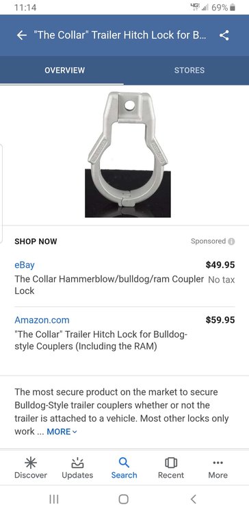

Moderators SeaDawg Posted August 18, 2019 Moderators Posted August 18, 2019 We use a bulldog collar lock. Traveling, or at camp. 2 1 2008 Ram 1500 4 × 4 2008 Oliver Elite, Hull #12 Florida and Western North Carolina, or wherever the truck goes.... 400 watts solar. DC compressor fridge. No inverter. 2 x 105 ah agm batteries . Life is good.
