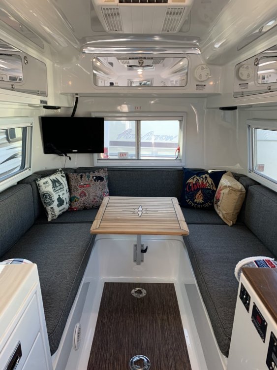

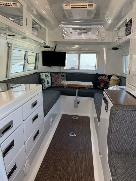

djpinaz Posted December 26, 2019 Share Posted December 26, 2019 Sharing pics of a lagun table installed in our Oliver. If we were ordering new (or select in our used purchase) we would have looked for a twin bed model, but we have the standard floor plan. We’re not a fan of leaving the queen bed made or leaving the large dinning table up, as it consumes so much space and feels more open without. Therefore we installed a lagun table. If my to-do list wasn’t so long I would have made the table top, but opted for the manufactures tabletop (beautiful, but pricey). 2 2014 Oliver Elite II, Hull #62 Link to comment Share on other sites More sharing options...

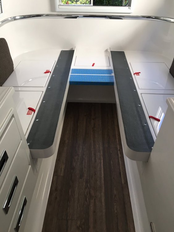

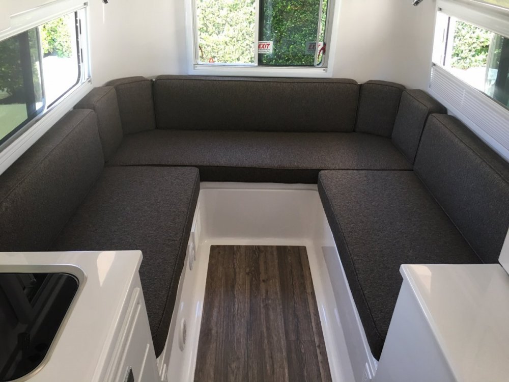

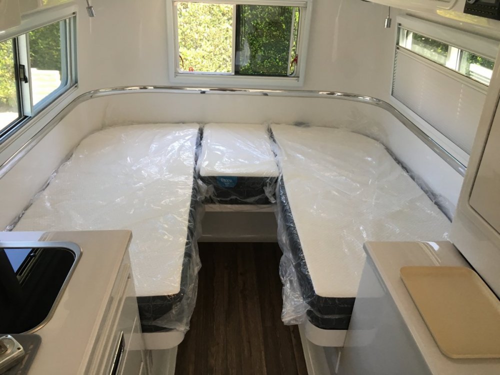

AndrewK Posted December 26, 2019 Share Posted December 26, 2019 After purchasing a standard floor plan new, we decided converting from a bed to seating and back again was going to be just more that we wanted to do everyday so, I converted it to a modified twin bed myself. A little expense and a little effort and we love it! I needed the extra width at the head of the bed so we added a 18" x 36" "fill in" mattress between the two twins. Before and After pictures. Andrew 3 Andrew 2019 Legacy Elite II 2018 BMW x5 35d Link to comment Share on other sites More sharing options...
Mattnan Posted December 26, 2019 Share Posted December 26, 2019 Looks awesome. I am sure you'll enjoy it and the added flexibility. We have a twin bed option and I am in the process of adding the Lagun table option developed by Overland. Ttyl mounts to the side. He has a terrific description back 4 or 5 pages on this forum. We have a local craftsman making the top. 1 Link to comment Share on other sites More sharing options...

djpinaz Posted May 7, 2020 Author Share Posted May 7, 2020 On 12/26/2019 at 11:02 AM, AndrewK said: After purchasing a standard floor plan new, we decided converting from a bed to seating and back again was going to be just more that we wanted to do everyday so, I converted it to a modified twin bed myself. A little expense and a little effort and we love it! I needed the extra width at the head of the bed so we added a 18" x 36" "fill in" mattress between the two twins. Before and After pictures. Andrew Andrew, did you do this conversion yourself, or did you have Oliver do it? We would prefer to have the twin layout so would be interested in what it would take. It seems like I also saw a post of someone that made brackets to accommodate twin mattresses, but I can't seem to locate that post. Darren 2014 Oliver Elite II, Hull #62 Link to comment Share on other sites More sharing options...

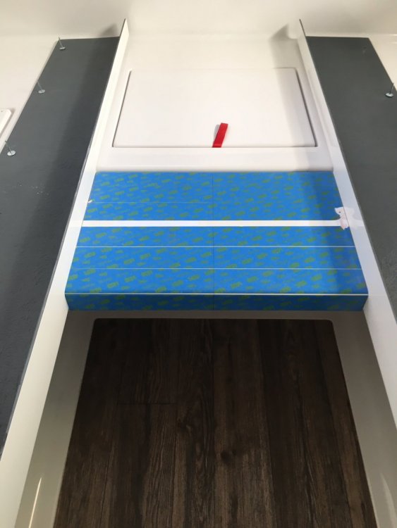

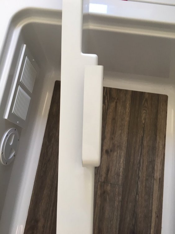

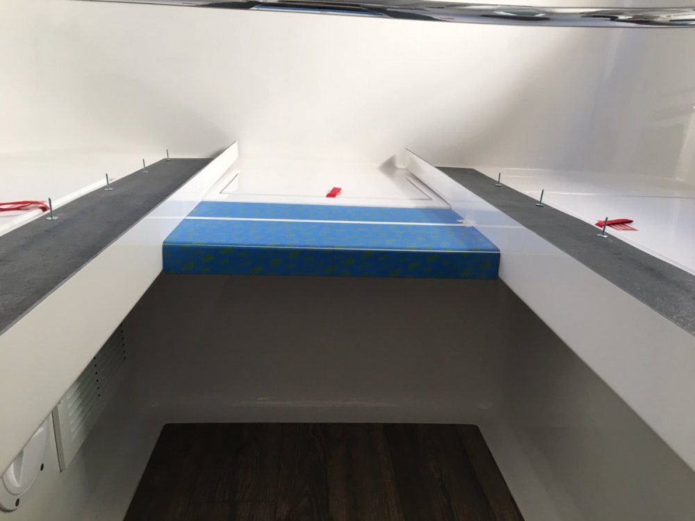

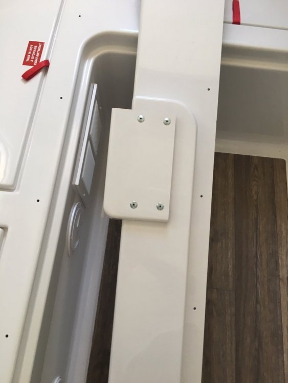

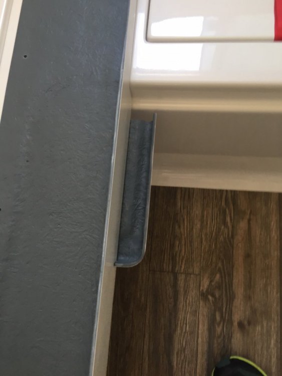

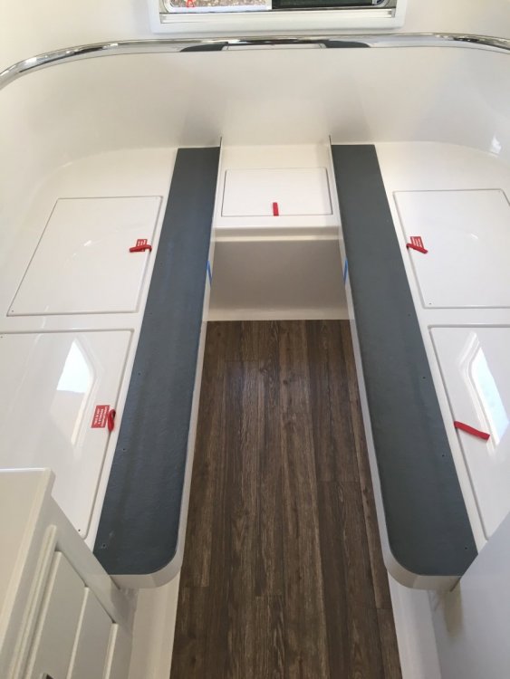

AndrewK Posted May 7, 2020 Share Posted May 7, 2020 Darren, I did this myself, using twin bed rails and rivets purchased from Oliver and a filler piece made form the factory filler, used to make the king bed. I included a few more pictures that include; the rails installed, the bracket and filler piece (covered in blue painters tape). If you would like to do the same, I would be more than happy to walk you through it. Please PM me with your contact information. Andrew Andrew 2019 Legacy Elite II 2018 BMW x5 35d Link to comment Share on other sites More sharing options...
hellfighter1 Posted June 1, 2020 Share Posted June 1, 2020 Love your re-design and would like to do this to my Oliver... Questions- what is the purpose of the (blue) filler pieces? Are they the standard filler piece(s) that are provided with the standard Oliver? Can these be moved forward to allow for a Lagun Table riser? Thanks, Bill, Hull # 144 Link to comment Share on other sites More sharing options...
djpinaz Posted June 1, 2020 Author Share Posted June 1, 2020 We’re very happy with how our conversion from the standard floor plan to the twin turned out. Thanks to Andrewk for his help in navigating the project along the way! Before pics at the start of this thread. After pics below. 2014 Oliver Elite II, Hull #62 Link to comment Share on other sites More sharing options...
AndrewK Posted June 6, 2020 Share Posted June 6, 2020 (edited) On 6/1/2020 at 10:41 AM, hellfighter1 said: Love your re-design and would like to do this to my Oliver... Questions- what is the purpose of the (blue) filler pieces? Are they the standard filler piece(s) that are provided with the standard Oliver? Can these be moved forward to allow for a Lagun Table riser? Thanks, Bill, Hull # 144 Bill, I put the blue tape on the filler piece, that came with our standard floor plan, to keep from damaging it when I cut it on the table saw. If you want or have a Lagun table, I wouldn’t use the filler and set it up like Darren did. We don’t have the table and I needed the extra length for the center piece, to spread out at the head of the bed as, I am 6’5” and a back sleeper. I need the extra room for my shoulders. Most would not. If you would like to discuss further PM me or I am sure Darren would be happy to talk with you as well. Andrew Edited June 7, 2020 by AndrewK 1 Andrew 2019 Legacy Elite II 2018 BMW x5 35d Link to comment Share on other sites More sharing options...
Ray and Susan Huff Posted June 7, 2020 Share Posted June 7, 2020 On 6/5/2020 at 11:00 PM, AndrewK said: Bill, I put the blue tape on the filler piece, that came with our standard floor plan, to keep from damaging it when I cut it on the table saw. If you want or have a Lagun table, I wouldn’t use the filler and set it up like Darren did. We don’t have the table and I needed the extra length to to center piece, to spread out at the head of the bed as, I am 6’5” and a back sleeper. I need the extra room for my shoulders. Most would not. If you would like to discuss further PM me or I am sure Darren would be happy to talk with you as well. Andrew I was wondering about bed width in the twin bed. Our current RV twins are 34"x76 - 4" narrower and 1" shorter than the Oliver. My husband is 6'1" and also a back sleeper. This looks like a great solution. I would rather not have the table mounts in the floor. I like your Lagun table top. Is this something you did? The table could also serve as a replacement for the nightstand that the twin floorplan includes. In our current RV layout, the nightstand is the same height as the bed platform and includes a filler mattress (for transforming into a king bed). If the Oliver twin was designed this way, you could do this mod. You give up the drawer between the beds, but are always tradeoffs. On the topic of tables: Can someone tell me the dimensions of the dinette table. Has anyone modified it with a sliding extension or some way to make it just a bit wider? I appreciate everyone sharing their ideas so we can make the best decision on floorplan, options, etc. Ray and Susan Huff Elite II Twin "Pearl" - Hull#699; delivered December 7, 2020 2013 F350 6.7l diesel Super Duty 4x4 long bed crew cab 1UP-USA Heavy-duty bike rack 2017 Leisure Travel Van Unity Twin Bed (sold) Link to comment Share on other sites More sharing options...

djpinaz Posted June 7, 2020 Author Share Posted June 7, 2020 Susan, the first link provided above by Overland above is where I purchased our lagun table hardware and top. We’re very happy with it and the options we have with it. We fold the top into it’s smaller shape and rotate between us when we’re sleeping to make sure the walkway is clear for a middle of the night potty run, and it acts as a nightstand. During the day we rotate it to the hallway and open it up for coffee or while watching tv. Darren 1 2 2014 Oliver Elite II, Hull #62 Link to comment Share on other sites More sharing options...
