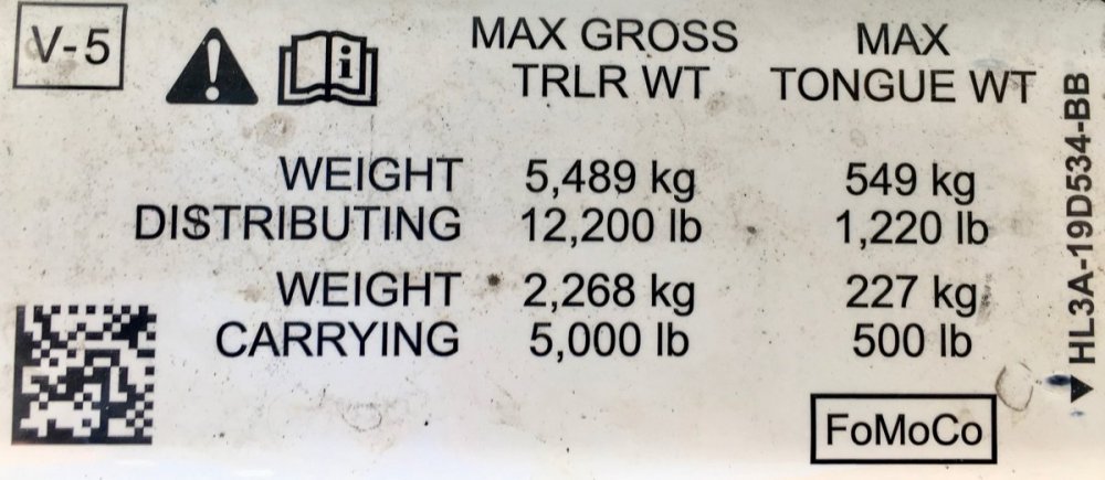

You may want to look  in your manual and at the actual receiver and see if there is a tag like the one below from our F150.
In our case, it was on the body of the hitch receiver.
It states the  hitch capacity towing with or without  with a weight distribution setup.
For the example below it says specifically if you are towing
* without a weight distribution hitch it has a 500 LB MAX tongue wt.
* with a weight distribution hitch it has a 1220 LB  MAX tongue wt.
My Elite II has a 630 LB tongue wt so I must use the WDH to avoid overloading that actual receiver assembly.
