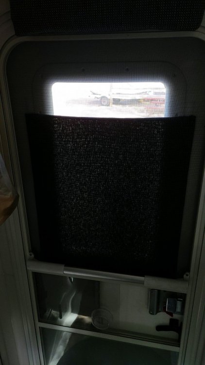

AndrewK Posted June 22, 2020 Author Posted June 22, 2020 Overland, I purchased standard shade size 3 through Zarcor and they customized it. Model CSH-3-W Oceanair Cabinshade - White. Size: x=21 5/8” (shade width), y=23 5/8” (shade height), z=24 1/8” (head rail). Cost $124.90. They customized x=19 1/8” and z=21 5/8”. The customizing cost $39.00 + $10.00 shipping. If you think you can cut down the shade yourself, you can get the shade online for less than $100. Andrew 1 Andrew 2019 Legacy Elite II 2018 BMW x5 35d
Overland Posted June 22, 2020 Posted June 22, 2020 Thanks - after installing it, do you think you'd adjust the dimensions any or is it good?
Moderators SeaDawg Posted June 22, 2020 Moderators Posted June 22, 2020 Andrewk, the shade looks great, and so easy to operate. Since these were created for marine environments, I'm guessing the shade fabric is easy to clean? Website says uv resistant. How long did it take to install? What fasteners did you choose, or were they included? Sure beats the heck out of the "shirt over the head bump cushion over the door" method we use. Even if it's a nice shirt. Lol.😆😅 Your shade looks great! Sherry 1 2008 Ram 1500 4 × 4 2008 Oliver Elite, Hull #12 Florida and Western North Carolina, or wherever the truck goes.... 400 watts solar. DC compressor fridge. No inverter. 2 x 105 ah agm batteries . Life is good.
AndrewK Posted June 22, 2020 Author Posted June 22, 2020 Sherry, They are the same roller shades used in modern Airstreams, with a different Head rail attachment point. The shade is a thin vinyl that appears would be easy to clean. Just installed it so time will tell. The install took about 15-20 minutes. Drilled three holes in the screen door and screwing in three screws. All screws and the bottom attachment point are provided. Andrew 1 Andrew 2019 Legacy Elite II 2018 BMW x5 35d
Townesw Posted June 23, 2020 Posted June 23, 2020 (edited) AndrewK Did you just replace the glass pane and reuse your old frames? Do you think that the shade could be mounted upside down, so that a viewing gap could be left open near the top of the window instead of the bottom? Also noticed that your head bump cushion is missing. It didn’t affect installation or usage of the shade, did it? Edited June 23, 2020 by Townesw Edited to add additional question. Bill and Martha 2018 LEII Hull 313 Original owners 3/14/2018 2019 Chevrolet 2500HD Duramax
AndrewK Posted June 23, 2020 Author Posted June 23, 2020 Townes, I just replaced the glass. There is no reason to replace the frame unless it is damaged. The shade can’t be installed upside down because the clip that holds the shade open (covering the window) would have nothing to attach to and keep the shade from catching on the door frame, when you open the door. The head bumper has no impact on the operation of the shade. I removed It because we didn’t like how it looked and it did nothing to keep me from hitting the top of my head on the bottom of the frame, when I enter the trailer. Andrew 1 Andrew 2019 Legacy Elite II 2018 BMW x5 35d

Townesw Posted June 24, 2020 Posted June 24, 2020 Mossey What is SME? I want to be able to look out the top. This is what KountryKamper did Bill and Martha 2018 LEII Hull 313 Original owners 3/14/2018 2019 Chevrolet 2500HD Duramax

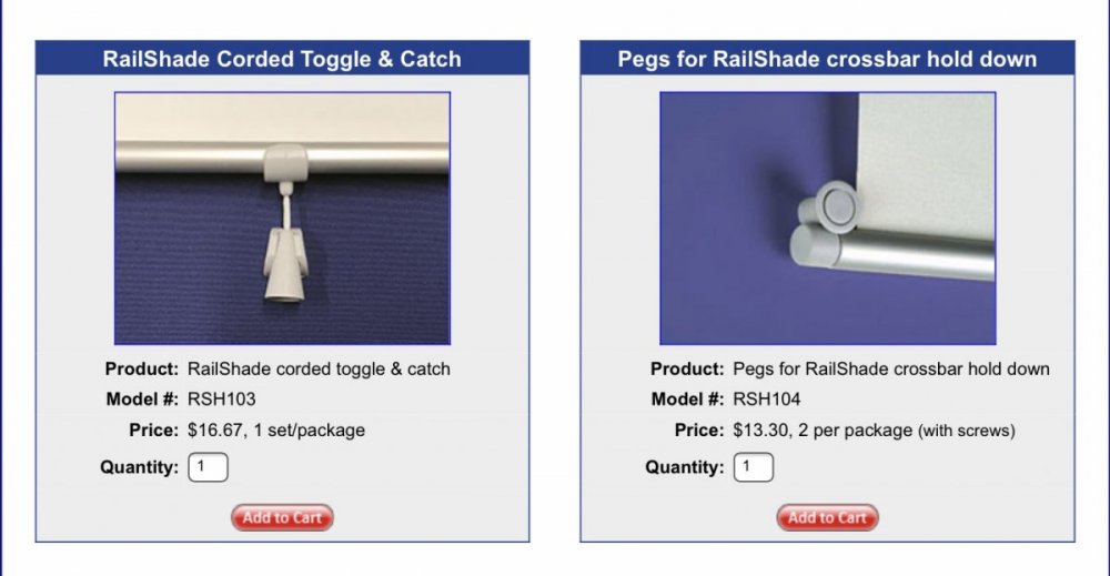

AndrewK Posted June 24, 2020 Author Posted June 24, 2020 Mossey, The head rail can be attached at any level. We placed ours as high as it could go, without interfering with the operation of the door. For us, it will only be closed when we are getting in and out of the shower and we want maximum privacy. As for the pegs, they can't be used with the shade as it came, as the bottom shade rail is skinnier than the head rail and the width of the screen door frame. (refer back to the pictures I posted earlier) The pegs would have to be installed on the screen door frame and the bottom rail would not be able to catch on them. If someone wanted to use the pegs, they could ask Zarcor to leave the bottom rail long (same width as the head rail), to allow for this. Knowing what I know now, I would seriously consider that and then mount the head rail at the bottom. This would address Townesw desire. If you ordered more sets of pegs, the shade could be set in different positions. If someone wants to do this, I will check to make sure the pegs won't interfere with opening/closing the screen/door. Andrew 1 2 Andrew 2019 Legacy Elite II 2018 BMW x5 35d
