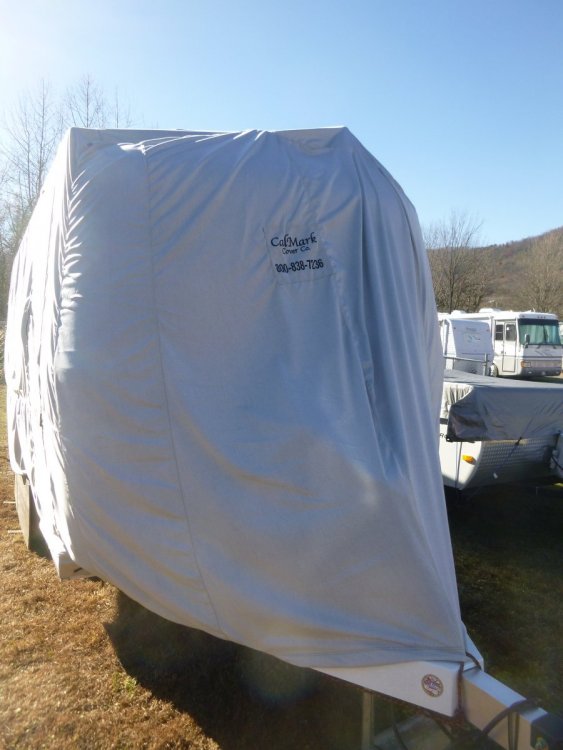

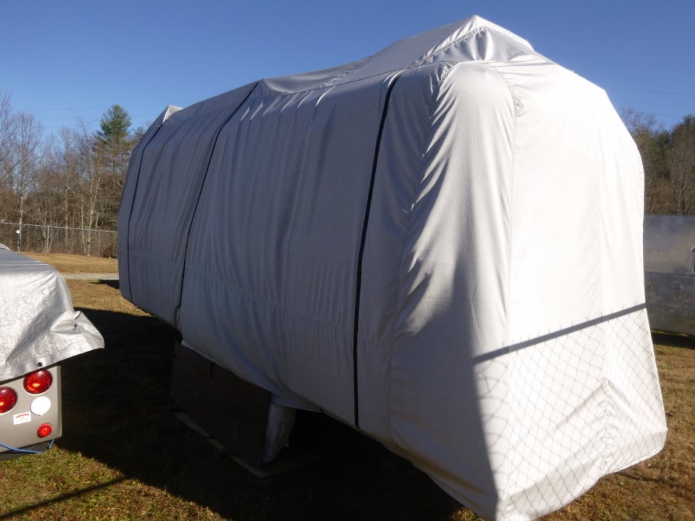

Moderators topgun2 Posted May 11, 2020 Moderators Posted May 11, 2020 Just before changing into my workout cloths and going downstairs to the home gym, some guy has to mention "weighing in" - bummer. However,with reference to the CalMark covers - just type Calmark into the search box at the top right of this page and have fun reading. And, there are even pics in some of those posts. I've used both CalMark and Adco covers over the years and firmly believe that the CalMark's are better. Both are made from the same "Sunbrella" material but the CalMark has three webbing straps that completely go around the Oliver (front, middle and rear) and it has both a cinch rope in the bottom hem and grommets in the bottom hem that the Adco doesn't have. Both companies have the measurements for the Oliver LEII (they probably have it for the LEI also). Both have an access door so you can get into the Ollie without taking the cover off. Bill 1 1 2023 Ford F150 Lariat 3.5EB FX4 Max Towing, Max Payload, 2016 Oliver Elite II - Hull #117 "Twist" Near Asheville, NC

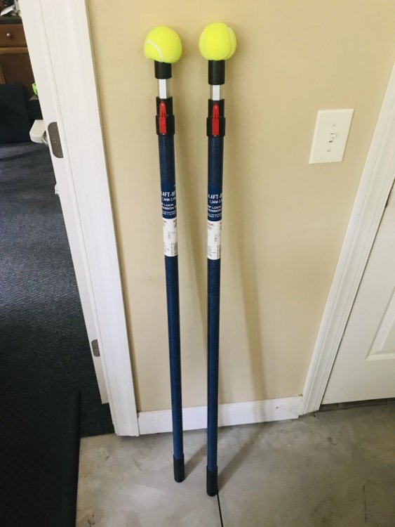

Patriot Posted June 9, 2020 Posted June 9, 2020 (edited) We picked up two of these commercial grade extension poles at Lowe’s to assist in draping the Calmark Cover over our Ollie when it comes time to store it. Our intention is start from the front using the poles to lift the cover with one person on each side of the Ollie walking back and slowly draping the cover as we go. I purchased a cheap pack of tennis balls at Wally World to protect the cover from the threaded ends of the extension poles. This is just an idea or lets say a work in progress. The poles extend up to 8’ and are very rigid. We will only need to extend the poles 3’ to clear the 9’7” top of the AC. So we’ll post up our thoughts on how this idea works when we give this a try at some point in the future. Edited June 9, 2020 by Patriot 3 2020 OLEII - Hull #634 aka- “XPLOR” 2021 F350 6.7 liter Diesel Lariat Ultimate Tremor aka - “Beast of Burden” Truma Aventa 13.5 AC, Alcan 5 leaf pack, Alcan HD shackles & HD wet bolts, 5200lb never lube axles.XPEL 10 mil PPF front both front corners, 30 lb LP tanks, Sea Biscuit Front Cargo Storage box. ⚡️⚡️11/2025- Lithium upgrade to XPLOR - (2) Epoch 300ah Lithium batteries, Victron 3000W MultiPlus-II, Victron GX Touch 70, Victron Cerbo GX, Victron Smart Solar MPPT, Victron Smart Shunt, Victron Orion XS 1400 DC-DC charger, RV Soft Start. Zamp 90W suit case solar panel for 420W of solar.⚡️⚡️ North Carolina

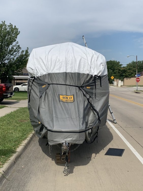

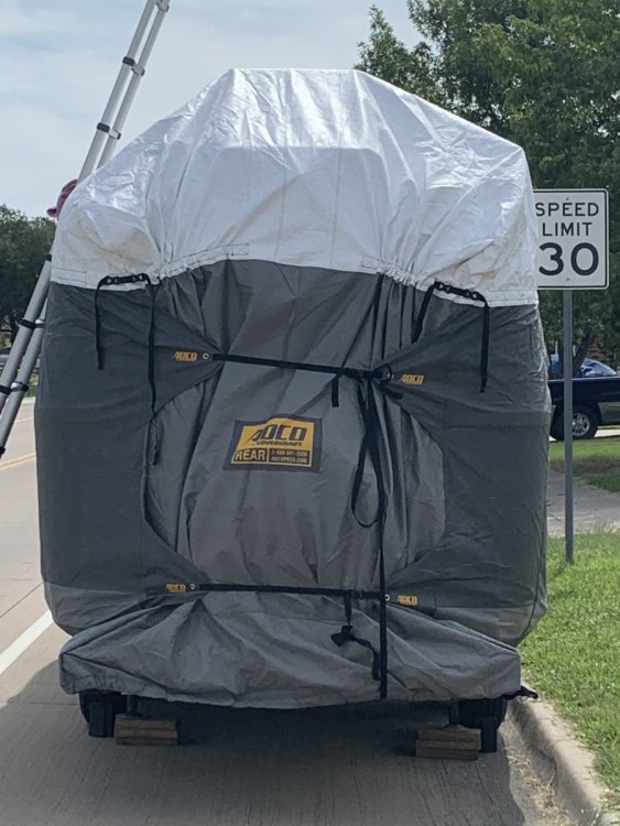

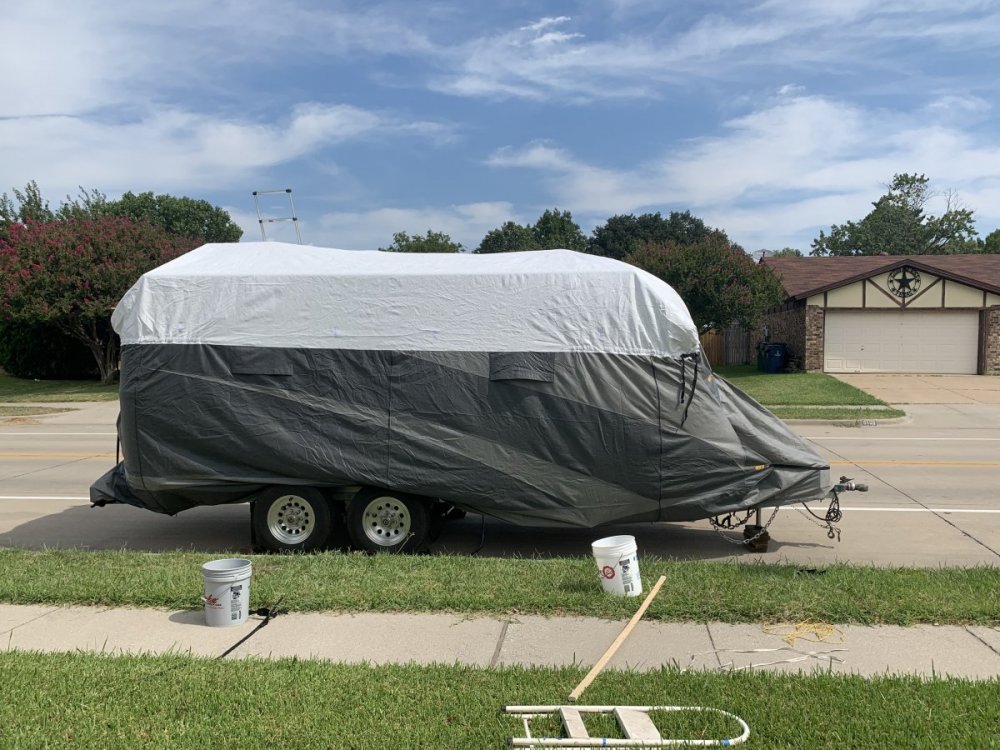

Geronimo John Posted September 4, 2020 Posted September 4, 2020 I store my Oliver in a 95% dark barn in Oklahoma. I wanted a cover that would provide insect and bird protection. I went with the ADCO cover, but the one received was larger than I needed. Circumstances required that I use it anyway as my summer flight back to Hawaii was just a day away. When my too large cover had a warranty issue, Ichose to go with the next smaller size stock ADCO Cover. They sent me a replacement at no cost. The one sent and shown is their 3840 stock number. I did a quick install of the cover just to test fit it. I was not trying to make a perfect install, just wanted to make sure it would fit. Hence the imperfect strapping alignments. For an off the shelf cover, it is still a bit larger than the Elite II requires, but gets the job done much better than it's bigger brother did. I would be interested if any Oliver Elite owner has tried their next smaller size. Likely to be too small I think. Yes I would order the 34840 ADCO again. If I did not have a barn, I would go with a metal carport with this ADCO cover. NOTE: I install my cover and set up the trailer so that the ground points of contact are the tires and three jacks. I do not need to use the ADCO provided wheel covers as it is a 95% dark barn. The jacks are all on 6" concrete blocks. This combination makes it harder for ground pests to get into a position to do any damage. So far, after two winters, no issues. 1 TV: 2019 F-150 SuperCrew Lariat, 3.5L EcoBoost, 10 Speed Trans, Max Tow, FX-4, Rear Locker OLLIE: 2018 OE2 Hull 342, Twin Bed. OLLIE DIY’s: Timken Bearings, BB LiFePO4's, Victron 712 Smart, 350 Amp Master Switch, Houghton 3400, Victron Orion DC - DC, 3000-Watt Renogy Inverter, P.D. 60-amp Converter, Frig Dual Exhaust Fans, Kitchen Drawer Straps. Front Wardrobe Shelves, Snuggle Shelf. TV DIY’s: 2 5/16" Anderson System, Nitto recon’s, Firestone Rear Air Bags, Bilstein 5100’s, Mud Flaps & Weather Tech all, installed Ham Radio (WH6JPR).
