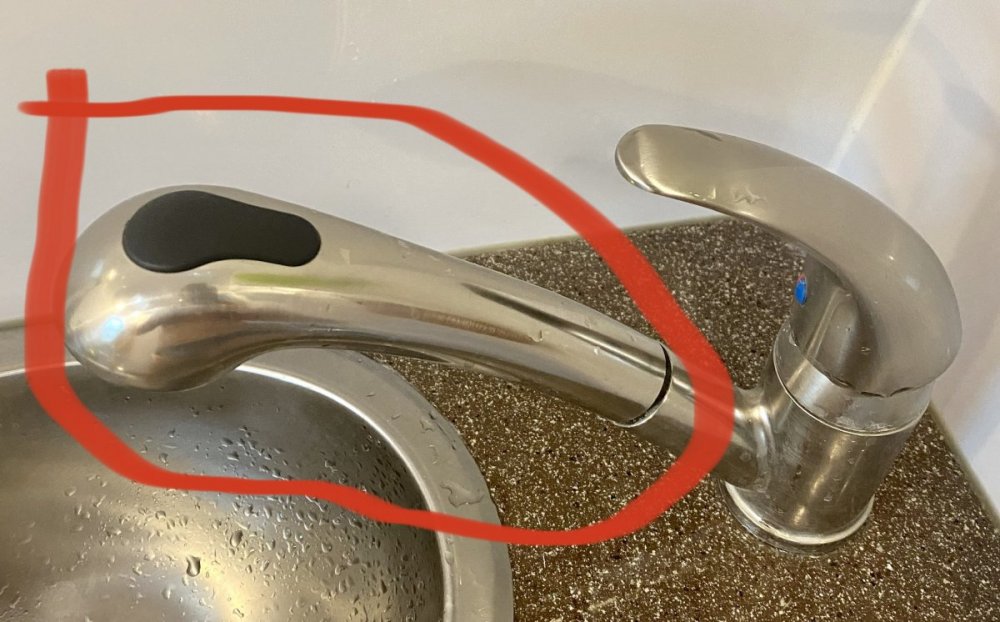

Bobfirst Posted June 2, 2020 Posted June 2, 2020 (edited) The pressure button to change from flow to spray doesn’t work. Can we buy a replacement piece for the end ? How does it come off? Edited June 2, 2020 by Bobfirst Bathroom sink & shower faucet

Bobfirst Posted June 2, 2020 Author Posted June 2, 2020 34 minutes ago, topgun2 said: Bobfirst - I see that your Ollie is a 2017 model but it would be helpful if you could post a picture of the specific faucet you are talking about. Thanks, Bill

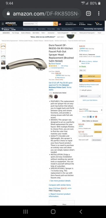

Moderators SeaDawg Posted June 2, 2020 Moderators Posted June 2, 2020 If this is the Dura kitchen faucet / sprayer that I believe it is, the replacement is about $20 with free amazon prime shipping/free returns. If it's the Scandvik model we have in the older trailers, the replacement head for their similar model is over $40, direct from Scandvik. The Oliver website lists 1 year warranty for the faucet, but Dura shows "limited lifetime warranty" on their catalog that I downloaded. It's always worth asking, imo. There are several listings on Amazon, with dimensions, so you should be able to verify that it's the right one. Their listing says it fits all Dura pullouts. https://www.amazon.com/Dura-Faucet-DF-RK850-CP-Designer-Replacement/dp/B009Y05M8M/ref=pd_lpo_263_t_2/138-7547063-1507704?_encoding=UTF8&pd_rd_i=B009Y05M8M&pd_rd_r=76c0b342-1688-4245-a196-7f1203fb3d09&pd_rd_w=W9QrM&pd_rd_wg=P3Gbp&pf_rd_p=7b36d496-f366-4631-94d3-61b87b52511b&pf_rd_r=P6GTRJNQF23D5KTP45F3&psc=1&refRID=P6GTRJNQF23D5KTP45F3 Sherry 3 2008 Ram 1500 4 × 4 2008 Oliver Elite, Hull #12 Florida and Western North Carolina, or wherever the truck goes.... 400 watts solar. DC compressor fridge. No inverter. 2 x 105 ah agm batteries . Life is good.
Bobfirst Posted June 2, 2020 Author Posted June 2, 2020 Yes the correct Dura Model Number IS DF-RKF 850-SN for 2017 Oliver Elite II. Although the manual says only 1 yr warranty, Dura website states ‘limited lifetime warranty. Waiting to hear back from customerservice@durafaucet.com
Moderators SeaDawg Posted June 2, 2020 Moderators Posted June 2, 2020 (edited) Like I said, no harm in asking. I've had home faucets replaced by delta, no questions asked, just a photo of the problem. Other brands, too. If Dura doesn't recognize this as warranty, at least it's minimal, and an easy swap out. My faucets in the 2008 are Scandvik. Haven't had an issue, so I don't know their policy. I also have three replacement Scandvik faucets on our boat, about 10 years old. No issues there, either. Good luck. Let us know how it works out. Sherry Edited June 2, 2020 by SeaDawg Typos 2008 Ram 1500 4 × 4 2008 Oliver Elite, Hull #12 Florida and Western North Carolina, or wherever the truck goes.... 400 watts solar. DC compressor fridge. No inverter. 2 x 105 ah agm batteries . Life is good.
Moderators topgun2 Posted June 2, 2020 Moderators Posted June 2, 2020 In reading the warranty it sure seems to me that you have a legit claim. Good luck! Bill 2023 Ford F150 Lariat 3.5EB FX4 Max Towing, Max Payload, 2016 Oliver Elite II - Hull #117 "Twist" Near Asheville, NC

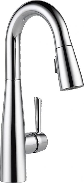

Moderators Mike and Carol Posted June 2, 2020 Moderators Posted June 2, 2020 Good luck, I hope it works out! I replaced the original faucet with this Delta model. It has been a very good mod. https://www.amazon.com/gp/product/B012I44QG4/ref=ppx_yo_dt_b_search_asin_title?ie=UTF8&psc=1 1 Texas Hill Country | 2016 Elite II #135 | 2020 Ram 2500 6.7L Cummins

Bobfirst Posted June 5, 2020 Author Posted June 5, 2020 Update on Dura Bath Faucet Warranty . They required verification it is a Dura faucet. Had to slip iphone between faucet & wall. Now they are sending a replacement head under Dura Limited Lifetime Warranty 1 3

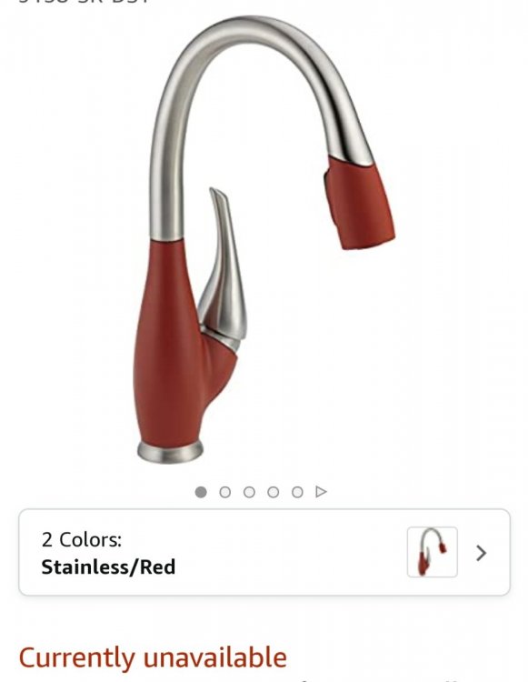

Moderators SeaDawg Posted September 14, 2020 Moderators Posted September 14, 2020 (edited) For those of you with Delta faucets anywhere, I had my first failure with a Delta product, at home. It wasn't even a leaker, just "cosmetic." The colored red coating on my Delta Fuse kitchen faucet has developed some dings and scratches in 5 years of use. Delta stepped up. Asked for photos, and original receipt. It has been discontinued, but Delta sent me a new, similar faucet in brushed stainless. Since I have many Delta products in my home, including all the shower valves, I was really heartened to get such a quick response. That said, I'll really miss that touch of red in the kitchen. Sherry Edited September 14, 2020 by SeaDawg 2008 Ram 1500 4 × 4 2008 Oliver Elite, Hull #12 Florida and Western North Carolina, or wherever the truck goes.... 400 watts solar. DC compressor fridge. No inverter. 2 x 105 ah agm batteries . Life is good.
