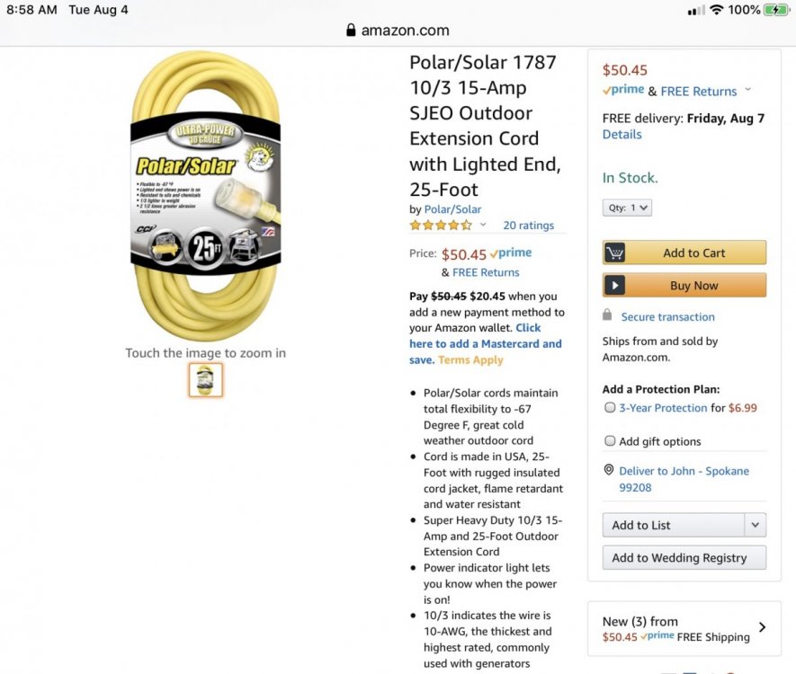

John E Davies Posted August 4, 2020 Posted August 4, 2020 (edited) Susan, a 25 ft cord will normally be able to reach the side 30A receptacle, but it might be tight if the truck is parked on the entry side, you have the approximately 10 feet of distance across under the frame, and that only leaves 15 ft extra. A second cable is useful. I normally keep the heavy factory supplied (high quality, high theft risk) cable stored away and use this extra heavy gauge 15A cord with a Marinco adapter, and it has been working perfectly for four summers. You have to watch the load, but with the AC going and normal 12 volt loads it has never shown any sign of overheating. I would not suggest running the AC and the microwave simultaneously, but that would likely overload your generator and trip the breaker anyway. I have used this as an extension cord for the big 25 foot cable, for a total of 50 feet, no worries, just don’t try to run the AC this way.... 10 AWG extension cord 25 feet Be extremely wary of Chinese “No name” cords and adapters, they are often very substandard and will break or overheat. Constant high current loads need high quality components John Davies Spokane WA Edited August 4, 2020 by John E Davies 1 SOLD 07/23 "Mouse": 2017 Legacy Elite II Two Beds, Hull Number 218, See my HOW TO threads: Tow Vehicle: 2013 Land Cruiser 200, 32” LT tires, airbags, Safari snorkel, Maggiolina Grand Tour 360 Carbon RTT.

gatorewc Posted August 6, 2020 Posted August 6, 2020 (edited) 15 hours ago, Susan Huff said: Thanks for the info Did you purchase the 10' cord from Oliver or elsewhere? Cost? Actually I ordered one from Amazon. They have several for sale, I try to always stay away the the cheaper ones and go with a reputable company. $44 NEMA. L-5- 30. 30A/125V. 10AWG Edited August 6, 2020 by gatorewc 1 Erv & Sherry Hull # 650 2024 Lariat SD 250 6.7 diesel http://visitednorthamericamap.com/image/ONQCALAZARCAFLGAIDILINIAKSKYLAMIMNMSMOMTNENMNYNCNDOHORPASCSDTNTXVAWAWVWIWYmed.jpg
John E Davies Posted August 6, 2020 Posted August 6, 2020 (edited) gatorewc, is this it? https://www.amazon.com/NEMA-L5-30-Extension-Power-Cord/dp/B0047010CQ?th=1 That does look like a decent cable, and it is available in lots of lengths down to 3 feet. and made in the USA. Marinco makes a similar one, in 12 foot length, it is super quality but it is $230 ......😳. That Iron Box one is probably 90% as good for a quarter the price. However, it doesn’t have the threaded locking ring of a marine adapter, that may or may not bother you. I do prefer to spin down the lock ring mainly because it deters theft and helps keep out rain. John Davies Spokane WA Edited August 6, 2020 by John E Davies 2 SOLD 07/23 "Mouse": 2017 Legacy Elite II Two Beds, Hull Number 218, See my HOW TO threads: Tow Vehicle: 2013 Land Cruiser 200, 32” LT tires, airbags, Safari snorkel, Maggiolina Grand Tour 360 Carbon RTT.
gatorewc Posted August 6, 2020 Posted August 6, 2020 Yes it is John. I tried to copy and paste with my MacBook but couldn't copy. I am sure operator error was in play. I used it for about an hour or so with my Ollie and was satisfied. Connection was warm but not hot. 90 degrees led to some of the temperature. Thanks for your help! 1 Erv & Sherry Hull # 650 2024 Lariat SD 250 6.7 diesel http://visitednorthamericamap.com/image/ONQCALAZARCAFLGAIDILINIAKSKYLAMIMNMSMOMTNENMNYNCNDOHORPASCSDTNTXVAWAWVWIWYmed.jpg

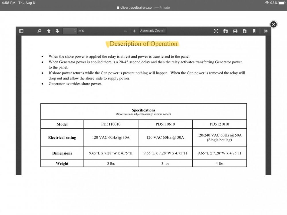

Moderators mossemi Posted August 6, 2020 Moderators Posted August 6, 2020 6 hours ago, hobo said: Not sure why I would ever have the shore power cord AND the generator hooked up at the same time. It's one or the other. If the shore power is not hooked up then there is no power feedback issue. Curious though if there is in fact a transfer switch somewhere that I'm not aware of in my 2018 LE II. This is from Oliver University in the transfer switch manual. Mossey 3 1 Mike and Krunch Lutz, FL 2017 LEII #193 “the dog house”
hobo Posted August 8, 2020 Posted August 8, 2020 On 8/6/2020 at 5:05 PM, mossemi said: This is from Oliver University in the transfer switch manual. Mossey Thanks for that. Good to know even if I don't envision ever having both connected at once. I guess it's the having a wife who worked for Dominion Energy for 40+ years in me that always makes me think of the guys up on the poles trying to restore power when they get the hell shocked out of them because homeowners have hooked up their generators to power their homes but didn't install a transfer switch which prevents that power from being back fed into the grid. It also took me a while to get comfortable with keeping the truck hooked up to the trailer while feeding the trailer with shore power. I don't usually do that but it has happened on an occasion. I was afraid the AC power would go to my truck via the 7 pin cable and fry my electrical system. It won't happen (in theory) but I always feel better when there are zero paths of conduction between the two. Just me I guess. Thanks again though for the info. 1 2018 Elite II, Hull #414 (the very last 2018 produced). Trailer name "2 HOBOS" . 2018 F250 4X4 Crew Cab, 6.7L diesel
