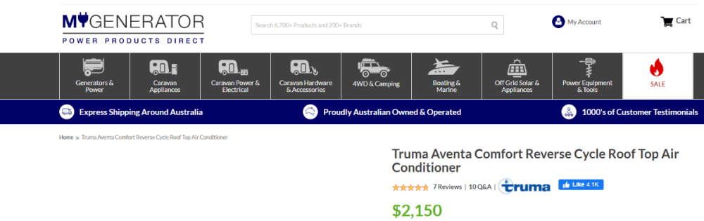

the new Truma Aventa listed for a mere $2,150.  I love German engineering, but not at 2X the cost for a unit too small for an OE2 to boot.  It looks like Houghton still has the market corned at this moment.  Good news is more players, more cost competition down the road.
Geronimo John, that $2150 Australian dollars. About $1575 US. I don't think the Truma is available to us, yet. The Aussies always seem get the new gear before we do!

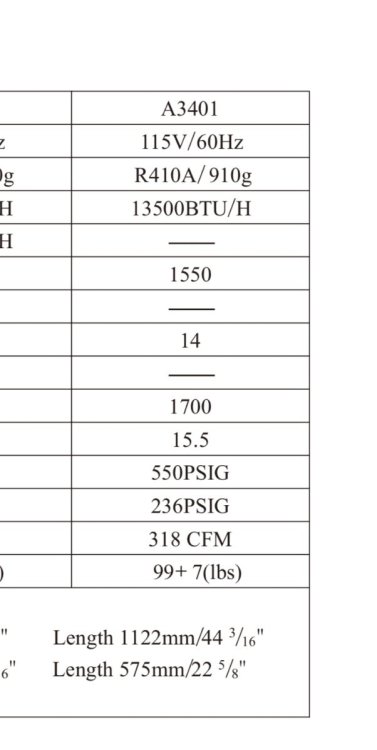

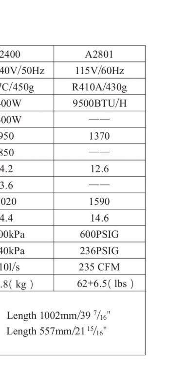

I’m not sure what the actual numbers are for the two units. The screenshots below are from the user manuals and probably represent worst case scenarios…

Interesting, with the higher cfm capability of the 13.5 it might move the same air on low as the small does on high. That would be a 7db difference which is substantial.
