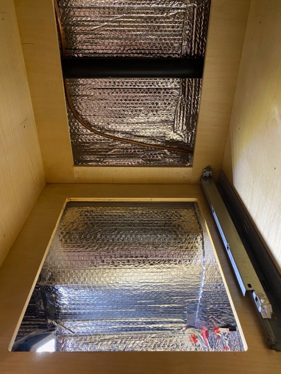

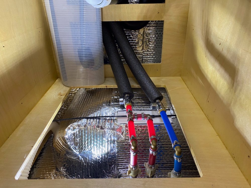

Overland Posted October 24, 2020 Posted October 24, 2020 8 hours ago, Mcb said: I sure would be interested in your recommendations for access holes...and the crimper while you’re at it... I’ve cut five access holes in my trailer: one under my composting toilet, which obviously won’t apply unless you have one; one under the fridge; one under each set of galley drawers; and one in the closet. The most useful and easiest are the ones under the drawers. (Oliver service will cut one of them for you if you ever need to reattach your overflow drain.) The closet one is the trickiest - you can do real damage to your trailer if you mess that one up. I’ll see if I can put some photos together and make a post about them next week. 1

NCeagle Posted December 2, 2020 Posted December 2, 2020 On 10/24/2020 at 2:51 PM, Overland said: I’ve cut five access holes in my trailer: one under my composting toilet, which obviously won’t apply unless you have one; one under the fridge; one under each set of galley drawers; and one in the closet. The most useful and easiest are the ones under the drawers. (Oliver service will cut one of them for you if you ever need to reattach your overflow drain.) The closet one is the trickiest - you can do real damage to your trailer if you mess that one up. I’ll see if I can put some photos together and make a post about them next week. Hi @Overland, any chance you put together a post on these access holes? I'm very interested in getting at least some access to the areas under the kitchen drawers and the closet. If you have, my apologies - I haven't seen it using search. 2020 Elite II, Hull 688 --- 2021 Silverado 2500HD, 6.6L Duramax Diesel
Overland Posted December 2, 2020 Posted December 2, 2020 Haven't posted anything yet. Don't worry - I'll get to it. 2
NCeagle Posted December 2, 2020 Posted December 2, 2020 1 hour ago, Overland said: Haven't posted anything yet. Don't worry - I'll get to it. Thank you! No hurry at all. Eventually I want to check my HVAC ducts in that area since they were messed up closer to the furnace. Rather not guess if someone has already successfully pulled this off. 🙂 2 2020 Elite II, Hull 688 --- 2021 Silverado 2500HD, 6.6L Duramax Diesel
Moderators topgun2 Posted December 2, 2020 Moderators Posted December 2, 2020 I'm worried! Please hurry up! 😉😁🤣 2 2023 Ford F150 Lariat 3.5EB FX4 Max Towing, Max Payload, 2016 Oliver Elite II - Hull #117 "Twist" Near Asheville, NC
Overland Posted December 2, 2020 Posted December 2, 2020 Bath vents are easy to deal with. Just reach in and rip them out - all fixed. The kitchen vents you might want to be more careful with, but those are easy, just use a router and the cabinet walls as your guide. You'll have to be a little careful with the front cut. You can try to use the cabinet trim as a guide, but it flexes, so I held a 2 x 4 tight to the lip of the trim and used that instead. The result is a nice clean hole, big enough to do most any repair or modification you'd like. The one under the sink is that same one Oliver will cut if you ever need them to reattach your fresh tank overflow. You'll of course want to cut some ¼" plywood to screw down over the holes. or anything that bumps out of your drawers while traveling will end up who knows where. 3 1
