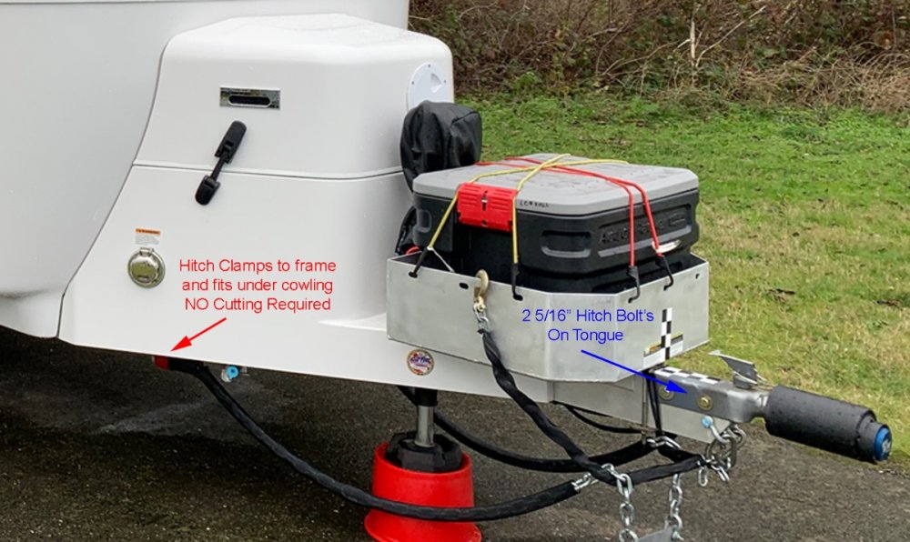

Here's a pix of a 2 5/16" Coupler and how the Anderson Hitch Parts Fit on the Tongue.
They fit perfectly under the fiberglass without cutting.
I added chain shrouds to our Anderson Chain's to keep them from getting scratched up and preventing rust.
