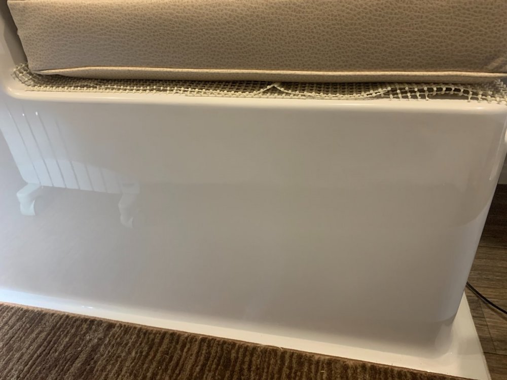

I have a roughly 6 inch by 2 foot area of Gelcoat under my dinette seat that is dull.  It's not easy to see without the right light angles, but you can make it out in the photo, especially where the reflection of the space heater is interrupted.  According to OTT Service, it was likely an area that was missed or not completed when being built - not a big deal to repair.
When it comes to buffing Gelcoat, there are tons of choices and some are better than others on white, so I asked OTT Service what they currently use in-house.  They use a product called Buff Magic (https://www.amazon.com/Shurhold-Yacht-Brite-YBP-0101-Magic/dp/B001HBQDO8).  I'm going to give it a try.  As a bonus it also cleans and shines metals.

Mine had some rough areas like that when we picked it up, but it turned out to be a very fine mist of paint overspray.  The backs of our pantry and closet doors were painted flat white vs the grey and black that I've seen on other trailers, so I'm guessing that they did some touch up painting after the trailer was together.  I know from personal experience that if you try to do any spray painting inside the trailer that you have to cover everything.
I do have some rough patches on the roof though that need to be polished.  But they're under the solar panels so I guess they'll remain.

I've also had a couple of those "dull" patches since new and I've tried (not very much or very hard) to polish then out by hand with no success.  I'll be interested to hear how this recommended product works.

Marine shops offer plenty of products to do this.  For my fiberglass kayaks, which are similarly finished in gelcoat, I keep a couple of products on hand.  I have a fiberglass rubbing compound, light duty, which is good for buffing out minor scratches and scuffs.  After use, the surface has a dull shine to it.  Also have a finishing polisher/wax which brings back the original, high gloss shine.  If there are scratches that need deeper attention, I will hit the area lightly with sandpaper as needed.  I may start with a middle grade such as 120 or 150, than go over it with 400 than move one to wet sanding with 800 and, if a critical spot, will finish by wet sanding with 1200.  Than onto compound and finish with the polisher/wax.  I've brought beat up hulls back to factory finish by doing this.  Plenty of instructionals on youtube as well.

NCeagle,
We have used Meguiar's #67 one step compound achieving good results for water spots and light scratches:
https://www.meguiars.com/marine/products/meguiars-marinerv-one-step-compound-m6732-32-oz-liquid
After using #67 then we applied Meguiar's Flagship premium marine wax/cleaner with good results:
https://www.meguiarsdirect.com/meguiars-flagship-premium-cleaner-wax-32oz.html

I had similar - a little light compound and buffer took care of it for the most part - had a few spots that required some 1000 grit to get it all out.
I also had the sloppy floor glue -  3m adhesive cleaner took care of it very well.
And O/S also - on the outside ???
All were cover with a good wax - Meguiar's is hard to beat.

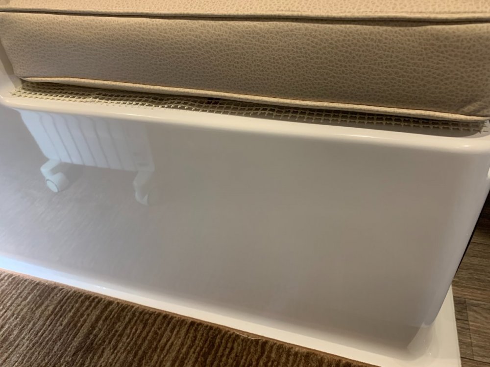

Final verdict:  the Buff Magic worked.  I started out polishing by hand and could see it was working, but after my rotator cuff started aching I used my drill with a buffing pad on it.  👍 I figured I'd finish with my random orbital buffer but I probably won't bother as I can't see any swirl marks or blemishes up close from the first pass.  Again, tough to see the real results without moving around and looking at it from different angles in the light, but I tried to capture the same lighting and reflection as the first picture.   It does look like the rest of the interior now - new.
