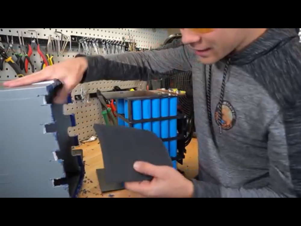

BackofBeyond Posted February 3, 2021 Posted February 3, 2021 Interesting - the insides of the Battle born $950 "Battle Born" Battery Tear Down - YouTube 2 Cindy, Russell and "Harley dog" . Home is our little farm near Winchester TN 2018 Oliver Legacy Elite II - 2018 GMC 2500 Duramax "Die young - As late as possible"
John E Davies Posted February 3, 2021 Posted February 3, 2021 That video is wonderful, the guy is so enthusiastic. He was wondering about the “wierd foam stuff” in the bottom of the case. I wonder if that is intended to dampen road vibration and shocks...? It would be cool if they would offer an extreme duty model with even more padding. Thanks so much for posting that! I love knowing what is inside things. John Davies Spokane WA 1 SOLD 07/23 "Mouse": 2017 Legacy Elite II Two Beds, Hull Number 218, See my HOW TO threads: Tow Vehicle: 2013 Land Cruiser 200, 32” LT tires, airbags, Safari snorkel, Maggiolina Grand Tour 360 Carbon RTT.
