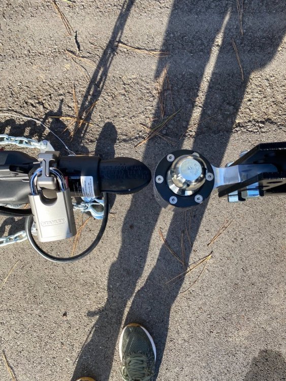

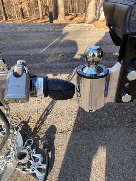

In keeping with my tradition on this thread, now I have a rather serious OFF TOPIC issue:
At Delivery Day last Tuesday, the tech hitching the Andersen to my TV (and I was videoing all), said hmmm the safety cable (breakaway) would not reach my actual truck metal, and so he put it on a link up on one of the two chains, "near" my actual truck body. But not attached TO my truck frame.
I asked if this was normal. He said it would be ok. Something to that effect. As a new person to towing anything at all, I accepted the answer.
Today I got another opinion and more expressed surprise that this cable DOES NOT reach all way to the actual metal of my truck frame.
I know you are all familiar with these breakaway things, but still attaching pics of mine. Mine is just like yours, except it does not reach my truck frame to attach onto the truck frame, as I believe (was told) it should. That is the whole point of it, right? If your chains fail, the breakaway is the last ditch to keep the trailer from breaking away from the TV.
Yes, I am brand new to all this. The last thing I want to worry about is the trailer breaking loose, etc. Sure, it may be ok, but should I get this addressed by OTT? It is weekend as I type this. I really cannot go back to HOHENWALD Monday, I am preparing to leave this SP early TUES AM. (I am at the campground they put you up in after delivery, things are ok, just on elec for now. Info overload BIG TIME. ) So, I leave Tues AM, breaking a long drive into halves, of 5-6 hrs of driving, stopping halfway at a SP (reserved) Tues night) so I am not over tired or arriving after dark trying to unhitch and hook up elec. On this journey I will be on almost ALL interstate (yes, in right lane) for 5-6 hours each of the two legs of trip.
(Note: I had considered going on a slower speed and even scenic route -- before this new concern about the breakaway cable even came up -- but I simply cannot do that for many reasons, scheduling and business-related. And FOR ME, the stress of traveling a completely unfamiliar route won't help me, it will hurt me at this point. (Interstates are known to me, and thus LESS stressful, in that I know there will be gas, food, rest areas, and help if I need it, and I have been on these particular interstates many times. As a new FT RVer the last thing I need right now is more stress. Please. Still at breaking point at times. TIA.

until those (Davies et.al.) more knowledgeable than I  chime in, here is a thread i found.  copy paste into Search Arg, and you will get a good read.
Trailer Emergency Breakaway Cable - Original Factory Cable Not Long enough
i want to say my cable is about 4' long.  sorry i cannot give you an exact measurement, as #665 is across town hibernating.
there once was a "Forum'r"  who accidently "Stepped" on his, engaging it, he plugged it back in by hand, and drove down the road, with ppl waving at him, until he looked back and saw smoke coming out of wheel wells and realized his brakes were engaged...  realizing he did not re-insert properly.  i have been very careful not to step on mine.  And i will be buying the red "Pig-Tail" type cable.  I KNOW NOT WHAT YOU WANT TO HEAR, BUT SOMETHING YOU NEED TO BE CAUTIOUS ABOUT...

What you need is something like THIS.  Simply attach the big hook end to you truck and the other end to your existing "breakaway cable".
However, this entire length should not be toooo long nor tooooo short in that you want it to not drag on the ground nor do you want it so short that you can't make turns without it activating your trailer brakes.
Note that this "thingy" does not help maintain contact between your truck and the trailer.   Its purpose is to apply the brakes of your Ollie in the event the Ollie becomes detached from your truck so that the Ollie will not continue to roll down the road without you.
It is more than likely that Tractor Supply has one of these in stock and either the guys in Service or at virtually any trailer/camper shop can adjust it properly.  If it were me, once I had one of these extensions in hand I'd look for a fellow camper who looked like they knew what they were doing and ask them to install it for you.
I can't tell what your distance is, from your photos
If I remember correctly,  you should have 24 inches of play.
You have time. Take it.
Use it
Take your trailer back in next week, talk to Jason, and get it right. If it's wrong.

The solution Bill provided is spot on, BUT totally and completely NOT acceptable to need to give it. The connection and solution you were provided by Oliver would be illegal in California, and as you figured, defeats the purpose.
one of the things that you should not do is what you were told as being ok. Do not connect the emergency brake breakaway cable to the safety chain.
Forum, this is a $60,000 vehicle. Why this solution allowed by Oliver? That cable should be manufactured, assembled, at delivery to fit the tow vehicle,  or the tow vehicle info should be collected and the cable prepared prior to delivery.
Sheri. You are going to be fine. You see issues that do not make sense and ask questions. Enjoy.

Thanks Bill. Seems like OTT would have furnished a better way of dealing with this. I will try to get to Tractor Supply tomorrow. Most campers appear to be leaving tomorrow. If I can’t find anyone around who is knowledgeable on this, what am I supposed to do? Drive with it attached to the chain where the OTT orientation guy had it placed? I will have no way of knowing if it is activating the trailer brakes, is that correct? I mean, until people are waving or there is a “situation?” This makes me very nervous indeed.

Thank you. I agree. I do not intend to disparage OTT, but yes, I am shocked at this. A $60k trailer and a brand new person who knows zero about any of it, and it was attached to the chain at Delivery Day and I videoed it and asked “Why is it too short?” And now, it has since been unattached and reattached and is perhaps not in the correct place at all, for all I know. I am terrified.

I have to leave. A schedule. Appts. Sigh. Even driving it back to Hohenwald first thing Monday AM when they open, knowing it may not be right during that drive all the way back, is . . . well.

Safety breakaway wires are necessary.  But, very rarely used.
I towed  thousands of miles with my dad, without ever needing them. But, when you do, you do.
You're fine, going 30 miles to Hohenwald,  to check it out. Check your connections when you hitch up. The bulldog is pretty much foolproof, imo. If you are hitched, have the collar lock on place, you're golden. You can't lock the collar  if you're not hitched properly. At least, I don't know how you can screw it up.
Don't think I could
Edited by SeaDawg
If your breakaway is connected with proper distance, your emergency brakes will engage, should your trailer "break away ."
Thats the purpose of the cable.
This should have been hooked up properly when you picked up your trailer.  I towed with a Rebel and the break away reached to the truck.
Having said that, you don’t need to lose any sleep over this.  Especially with the Andersen, if you ensure the bulldog is on the ball right, chances are slim to none that you will have an issue.  Mike
So, if you hook up, think you're good, pull ahead 20 feet, and check. You'll see.
If  you're on the ball, all is tight.
I wish I were there to see, but the only way you can engage the collar lock is if you are TOTALLY missing the ball connection.

As the other "opinion" on this issue - I was somewhat surprised to discover the BAS cable was not long enough to reach the same connection spot as the chain hook. The Oliver folks had simply connected it to the chain, as shown in Sheri's pics - but also not routed it in a workmanlike manner.  The cable was NOT sufficiently long enough to reach any vehicle I have experienced.
Given what was available at the time - the current connection was and is sufficient - but can be improved very simply - heck a few looped HD ty bands would do the trick.
Oliver  delivery personnel should have remedied this at delivery - in my view.
I will add - the Anderson hook up - a much improved design over the one I had - stinks - when it comes to pinning the whale tale.  A novice - if they don't cuss- will - after fussing with the pin. Get a grinder - bevel the pin, and loosen the damn chains. Otherwise - find a sailor and  go to town......
Sheri - you don't have to do anything - but later, you can make it more better- .
Edited by BackofBeyond
BoB, from what you have said, I agree.
If I were Sheri, I would drive in in Monday, and get a better connection .
From what I see, from the photos, the disconnect "would"  probably  work. I don't like it either, but it should work in an emergency.
I'd want to get it replaced
