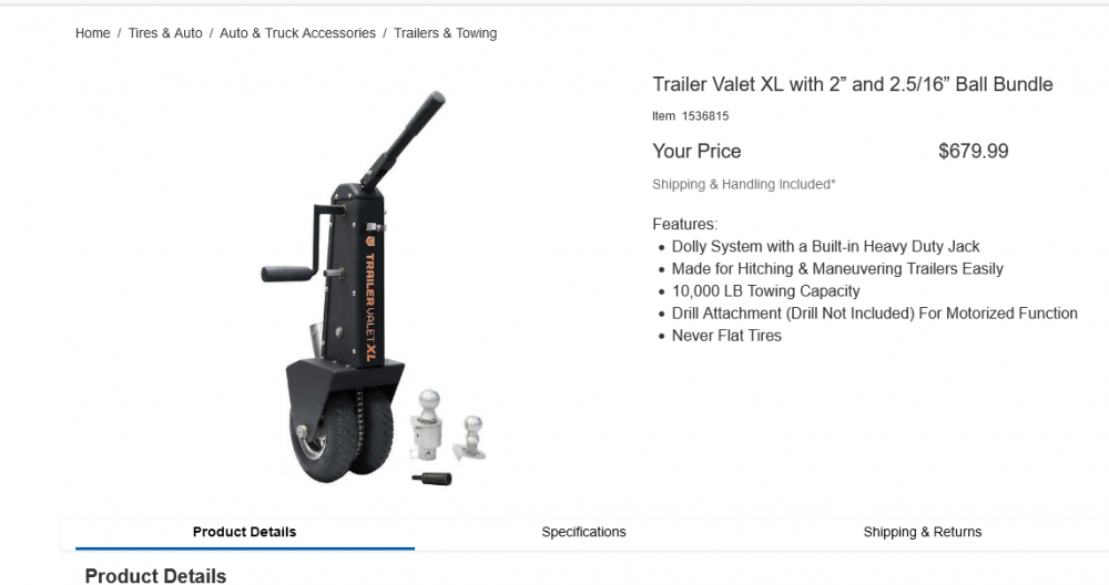

We own two other power dollies that we've used for our smaller Elite, the ez tug, and a parkit 360. The parkit 360 is more like this, but has its own 12v battery. I can't imagine trying to steer the trailer, and run a drill to operate a dolly at the same time, honestly.
Not crazy about the parkit 360, as attaching to the trailer properly is tricky, and it's very awkward, and doesn't seem steady in turns. Works ok on flat and smooth, very slowly. Just two little wheels under the tongue make me nervous every time we use it. But, it does make it possible to get the trailer into our narrow sideyard.
I like the attachment of the eztug better. But, it's not rated for the weight if even our Elite. It's fine for moving the boat.
I couldn't recommend either one,  honestly.

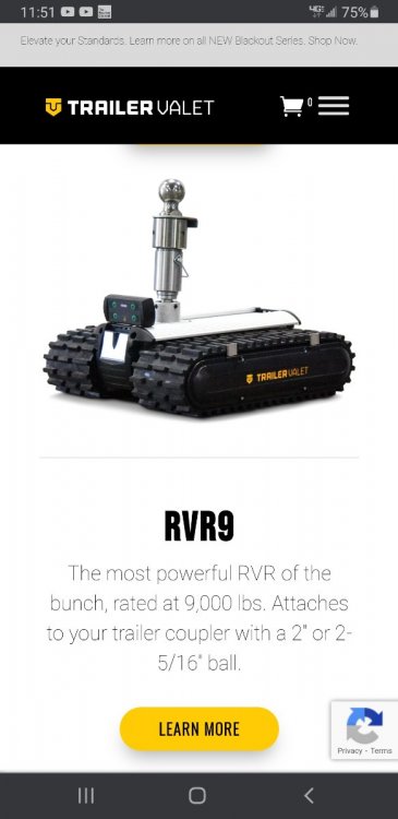

@LongStride, I  wonder if they sold out to trailer valet?
I looked at the RVR9 as well.  The Trax X2 looked much more stable to me.  Wider base and bigger tracks.
I had never considered that they might have sold their design to Trailer Valet, but I did ponder the possibility of a patent quarrel.
