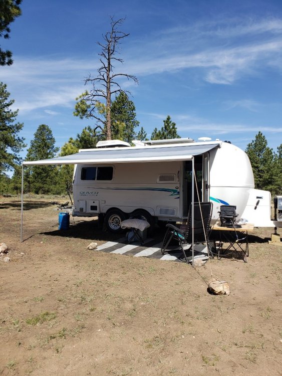

rideandfly Posted April 21, 2021 Posted April 21, 2021 20 hours ago, johnwen said: I went with the 390 AH Lithium batteries and Xantrex's 3000W inverter but elected to opt out of the 340W roof mounted solar panels. I will get Zamp's 230W portable with it's controller and have OTT put a solar port on the LEII we just ordered. Seems like it would be more efficient to aim directly at the sun, not have to park in the sun, and be able to keep the panels cleaner. I have read that it's better having the controller close to the battery vs at the portable panel that's on the end of 30ft of 10 AWG cabling. Would it be beneficial to have the controller taken off the Zamp and moved to the battery compartment (if there's room) or maybe better, inside of the trailer where it would have been if I'd have bought the complete solar package deal. Hopefully I'll get enough power from the portable to charge the batteries and not wish that I had put the larger roof mounted panels on. Thanks for any and all suggestions 🙂 We do not have factory roof mounted solar panels on Ollie. For now we have one Renogy 100W suitcase panel that will charge up to 6 amps in full sun. We use the Renogy Voyager waterproof 20 amp Solar controller mounted in Ollie's battery box. We also use a Furrion solar port mounted on Ollie, but it's only rated for 10 amps. Have our solar panel cables in three sections adding up to 35 feet of 10/2 cable, when used through Furrion port on Ollie probably total of 40 feet of 10/2 cable between the solar panel and controller with up to 6 amps of charging in full sun from a 100W panel. When we leave the campsite with solar panel out, use a padlocked bicycle type security cable on the panel connected to Ollie or something else in the campsite. In the future may add two Solar Panels (up to 150W total) on the swing up doors on Diamondback cover on the pickup bed. Will probably install a solar port on Ollie's LP Gas bottle enclosure or front of Ollie running cables through Ollie to existing 20W Solar controller in the battery box. When we do this modification will add one more BattleBorn 100AH lithium battery, too. This modification will allow charging on the road as previously mentioned. Will install solar panels on Diamondback cover secured with locknuts/bolts & padlocks, but will still be easy to remove for storage when not on camping trips. Bill 2015 LE2 2024 F-350 6.8L

johnwen Posted April 21, 2021 Author Posted April 21, 2021 Rideandfly, thanks for your help and for the picture! According to the Zamp website, the controller is rated 15 amps and produces 12.6 amps. Can all that be passed to the battery? Not sure if that's a proper question, my electrical expertise is rated about 5 out of 100 🙂 You stated a Furrion solar port is rated for 10 amps. Is that the port OTT installs? 2022 Oliver II #996 "Bessie", 2019 Silverado LTZ 5.3, Veterans https://wenandjohnsadventure.com/
