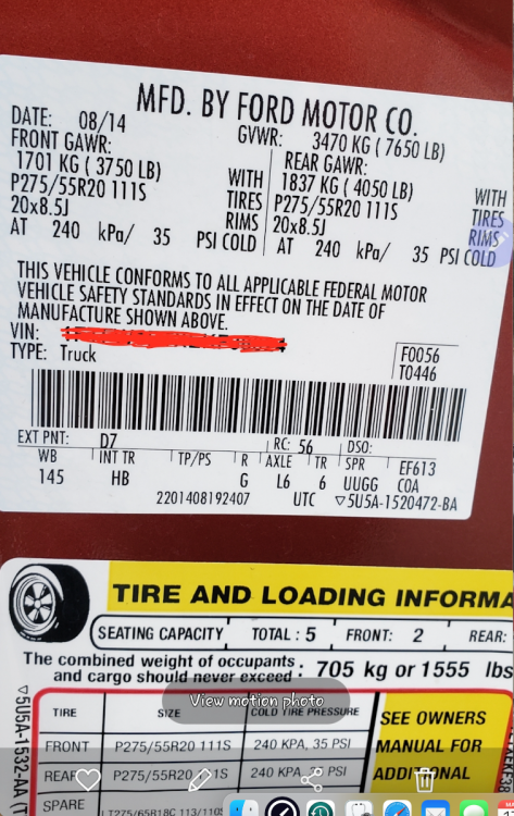

Here it is. I am not sure what that "doc" is but my iMac could open it.... I made a screen capture. The OP is mixing apples and oranges (pounds and kilograms).

What year and model is your truck,
A lot of LE2 owners are quite happy with this model of F150, it has good power but you will very limited in payload. Figure out how much “stuff” you want to bring along. subtract off the weight of the Andersen hitch and the trailer tongue weight, about 700 pounds together (the tongue weight varies a lot depending on trailer options). What is left is available for passengers and their gear. So with that 1555 pounds of payload, you have around 855 left. That is not a lot, but it is OK, especially for just one person or a couple. BUT if you want to bring along two more people plus their gear, it is not going to be very good at all. Any optional equipment bolted onto the truck takes away from the available payload, a canopy could be 200 pounds, for example. Offroad accessories like steel bumpers are realllly heavy.
This is why people buy Heavy Duty trucks, so they can pretty much not worry at all about weight. If it fits in the bed, you can bring it. Almost….
