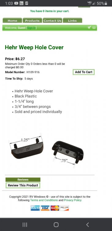

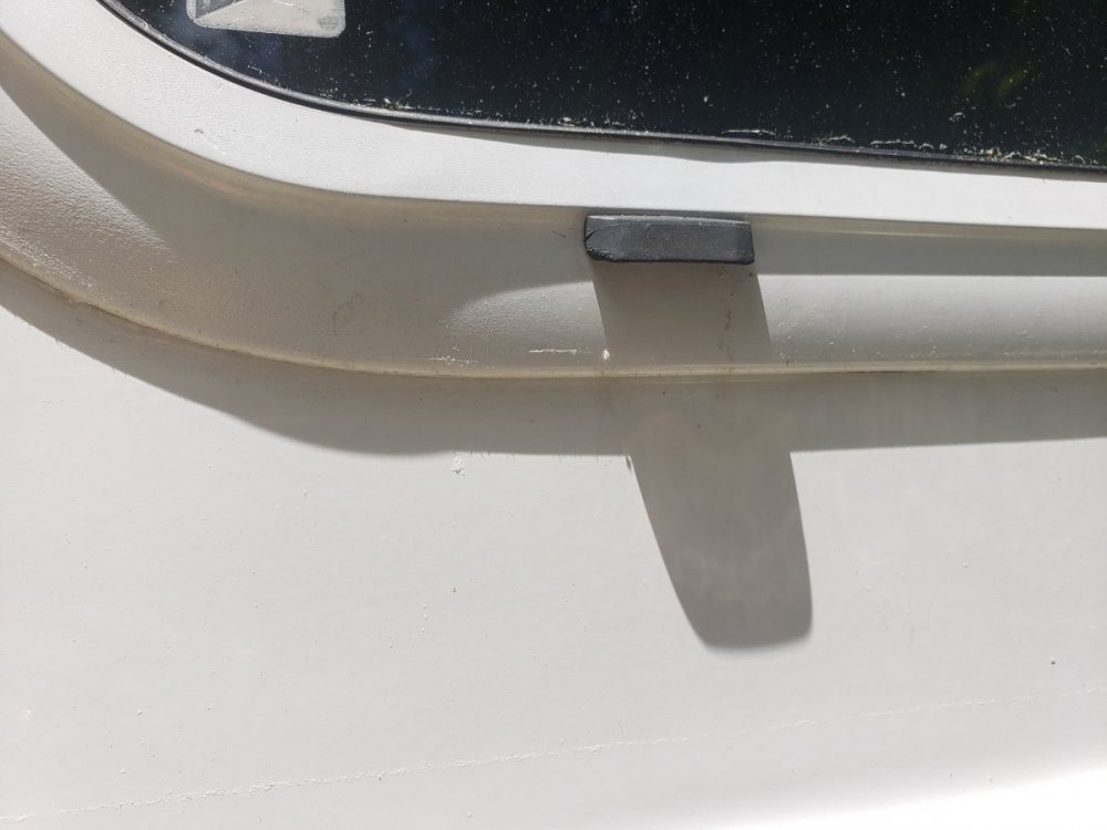

Moderators SeaDawg Posted June 5, 2021 Moderators Posted June 5, 2021 Back in the day, those Hehr covers were probably only a dollar or so. I was surprised at the increase. I need to replace one on my 2008 trailer. They weren't original equipment, at least not then. @DCKiefer found them, and shared the idea with the early owners. I do think they help with runoff, and to help minimize collection of debris in the weeps. They are pretty sturdy. And, removeable for cleaning. Mine are over 10 years old. 2 2008 Ram 1500 4 × 4 2008 Oliver Elite, Hull #12 Florida and Western North Carolina, or wherever the truck goes.... 400 watts solar. DC compressor fridge. No inverter. 2 x 105 ah agm batteries . Life is good.

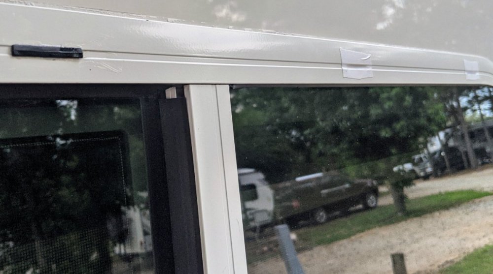

Moderators Wayfinder Posted June 6, 2021 Author Moderators Posted June 6, 2021 Well, we're at a camp site and making due with what we have. Naturally this week is full of rain. Here's my temp fix for now. Moved a weep hole plug to the other side, after cleaning it. Rolled it into place with a round rubber mallet I had on hand. Used white duck tape after cleaning metal with alcohol and let dry. We're ordering white gutter material now. We'll have a lot of extra if someone wants it. We'll ship to you.... For good wine or bourbon. 😁 1 Chris o-o 2016 Legacy Elite II (demo) - Hull #110 -"Rock'in 110" o-o 2024 Ford F-250 Lariat, 7.3L Godzilla gasser o-o Augusta, Georgia
BackofBeyond Posted June 6, 2021 Posted June 6, 2021 Wow - that is new to me! Lookslike they are installed upside down????? I have no idea why you would purposely put holes in the top. As mine leak fine with them exclusively in the bottom channel. RB Cindy, Russell and "Harley dog" . Home is our little farm near Winchester TN 2018 Oliver Legacy Elite II - 2018 GMC 2500 Duramax "Die young - As late as possible"
Moderators Wayfinder Posted June 6, 2021 Author Moderators Posted June 6, 2021 Weep holes on top AND bottom for these window frames. They don't use these any longer. Chris o-o 2016 Legacy Elite II (demo) - Hull #110 -"Rock'in 110" o-o 2024 Ford F-250 Lariat, 7.3L Godzilla gasser o-o Augusta, Georgia
Moderators SeaDawg Posted June 6, 2021 Moderators Posted June 6, 2021 The weephole cover i have looks much smaller than yours. I wouldn't order the ones bcnhb and I posted without measuring yours. Probably about the time Lippert bought Hehr. .. Another industry giant, becoming too big. I'm so sorry. The duct tape was a good idea. I often use that to figure out where a leak is actually coming from. And, applied properly, it's a decent temporary fix. Sherry 2 2008 Ram 1500 4 × 4 2008 Oliver Elite, Hull #12 Florida and Western North Carolina, or wherever the truck goes.... 400 watts solar. DC compressor fridge. No inverter. 2 x 105 ah agm batteries . Life is good.

Moderators SeaDawg Posted July 6, 2021 Moderators Posted July 6, 2021 What's the distance between the prongs that hold the covers in the slot? Mine are .75 inch, inside to inside. They're not really "plugs," but instead little tiny visors. 2008 Ram 1500 4 × 4 2008 Oliver Elite, Hull #12 Florida and Western North Carolina, or wherever the truck goes.... 400 watts solar. DC compressor fridge. No inverter. 2 x 105 ah agm batteries . Life is good.
