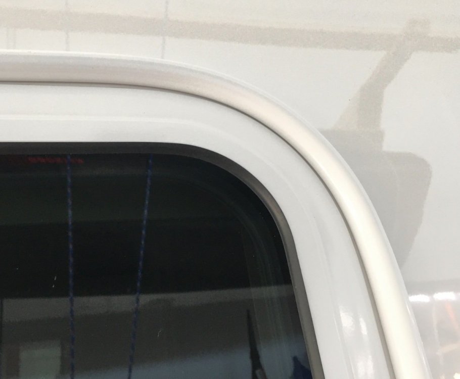

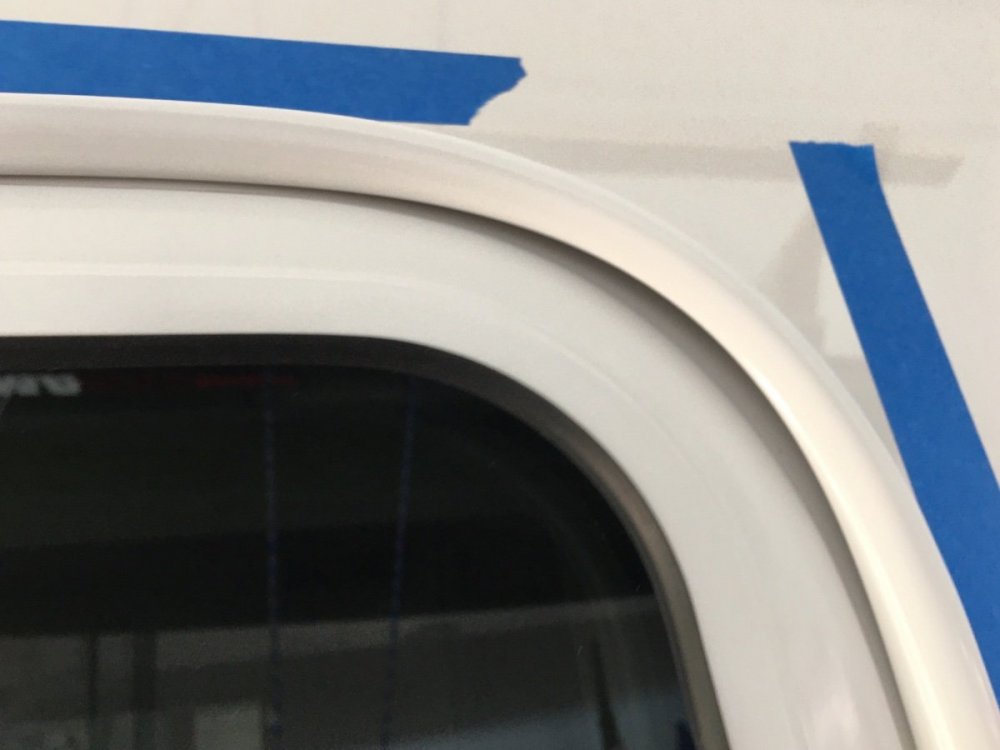

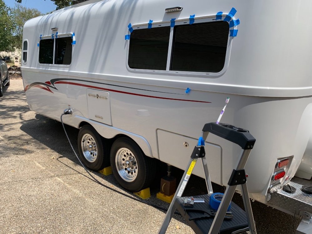

This isn't a full HOW TO install them, there are plenty of videos you can watch. Here's one: ...  https://www.youtube.com/watch?v=HsEjREGiBj0  ... The most important thing is prep, you must get ALL the old junk and wax off or the adhesive won't stick well. I started with isopropyl alcohol, then followed up with 3M Adhesive Cleaner, with an old clean tee shirt. One big problem I had was with the rounded corners, they would not lie flat. This was indoors at 78 degrees F.
I used a heat gun on LOW to warm the plastic, then pressed it down hard, and held it for a few seconds while it cooled.
I then warmed the entire length and worked it hard against the gelcoat with a plastic tool and my fingers. The 3M VHB adhesive is heat activated and it set up well, and there are no worries of the gutters lifting, there is no need to tape everything down for days, as some people have done.

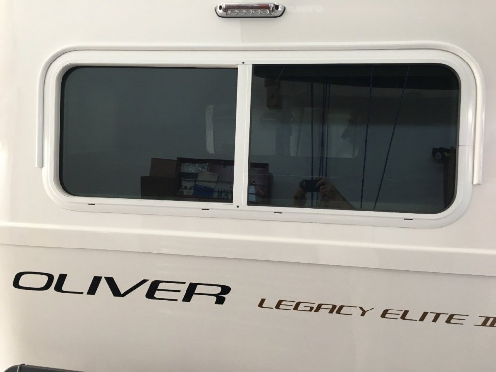

I am not sure why I waited so long to do this mod, it isn't very difficult. However, I ran out of material and was unable to complete the rear window, so I am waiting on another 10 foot section. When I measured, I did not plan on running the gutters so far down the window frames....  I bought a 25 foot roll. Drat.

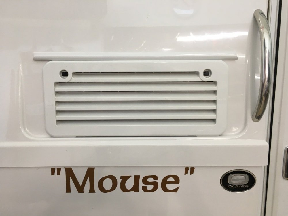

Fridge upper vent 21"= 1.75 feet

I did this mod twice. The first time it was spring (April) and the temps were in the mid 80s.  I installed the gutters then took my trailer back to storage.  That night we had a norther come through and the temperatures dropped to the 30s and the next morning all the ends of my gutters had flipped up.  The second time It did it was summer.  Hot.  No temperature drop and the gutters have remained in position for a couple of years.  Like John, I did all the prep before installing.

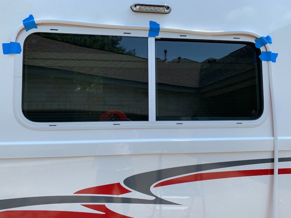

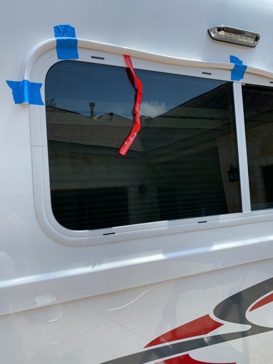

Positioning before sticking them on.
Slowly remove the red backing and stick in place.
I left the tape on overnight.  I also let it sit in the sun after sticking the gutters.

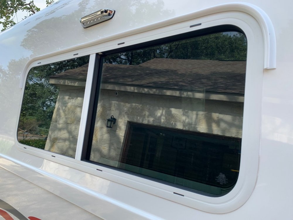

Finished product.  I didn’t go down as far as John, but they still work well.  We’ve had lots of rain this current trip and the run off from the roof is shunted around the windows.

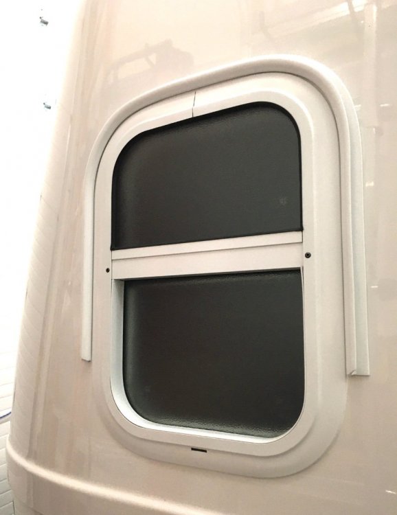

I continued them further down to get the discharge point past the joint where the two window frame pieces meet; to deal with wind driven water coming from the side; and to help anchor those pesky top corners.

My rear emergency exit window has an integrated gutter so I did not use the EZE Gutter there.  I did think your use of the extra gutter over the upper refrigerator vent was an excellent idea.

My windows are pictured above with the gutters applied.  It’s been several years and no issues.  I haven’t tried to re-caulk.  In fact, I’ve never re-caulked.  Going on 7 years now, no leaks.  I’m a “if it ain’t broke, don’t fix it” guy.  If I get window leaks, I’ll just peal off the gutters, caulk and put new gutters on.  Mike

If you have to recaulk, just seal the gap between the window frame and the gutter. I intentionally left that 1/8” gap there, for this reason. No big deal IMHO.

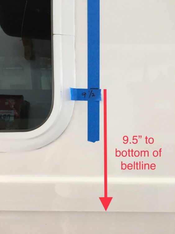

Needed to get a few things done at our home and returned to it leaving the camper at the campground.  Referenced this thread and I cut all of the gutter material to length based on JD's "9.5" up from the belt-line" guidance and, probably most importantly, warmed the material before installing it.  Obviously, I spent a lot of time cleaning the surface with alcohol too.  I would never attempt to install these on any kind of a curve without heating them up a bit.  On the low setting, as JD mentioned.
Warming the material activates the adhesive and really made it less difficult to make the turn around the corners of the windows.  As another mentioned, having it extend further down just creates that much better of a bond.  I used a plastic tool to really push the gutter on while it was still warm.  And I was lucky to have a warm day to do the install.  No painter's tape was needed.  They're on there and good.
