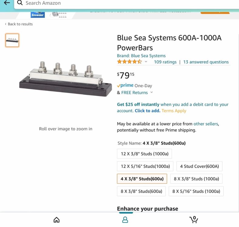

You also said:  Install Zamp solar port in battery compartment door and to battery bank (some say to the busses, whatever they are)
Below is a picture of a busbar.  It is used to allow multiple connections on either the positive or negative side of the battery bank, just like your fuse box at home.  The difference is that in the fuse box each wire or circuit is attached to a breaker and the breaker connects to the busbar.  When your rv tech installed the BMV-712, it included a shunt that is connected to the negative side of the battery bank.  The shunt has 2 posts with one post connected to the battery negative post and that should be the only wire or cable connected to the negative side of the battery bank.  All other negative wires should connect to the other post on the shunt.  There usually isn’t enough room on that post for all of the wires to connect to, so a busbar is added to increase the connection points.  The BMV display is connected between the 2 shunt posts and measures the amount of energy going into or out of the battery bank.
