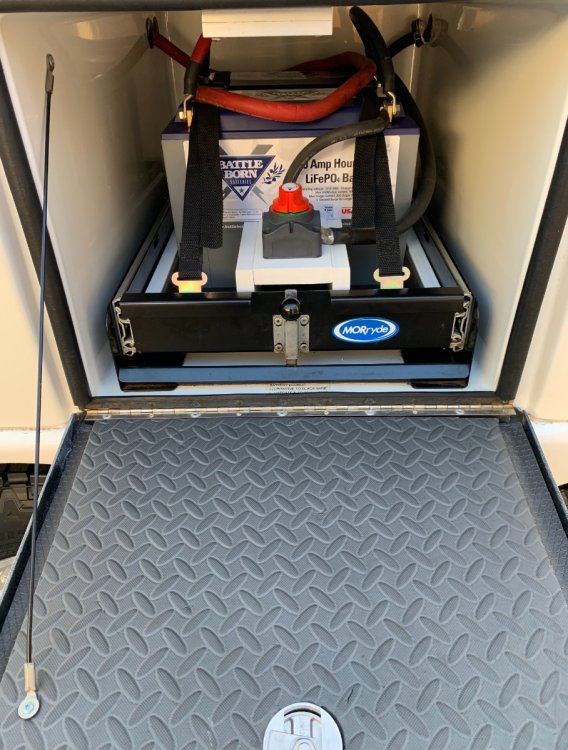

Bryan,
Looks like the battery straps have metal T clips that pass through a slot the rail, instead of a j shaped hook that gouges the battery.
Is that what we see in your first photo?

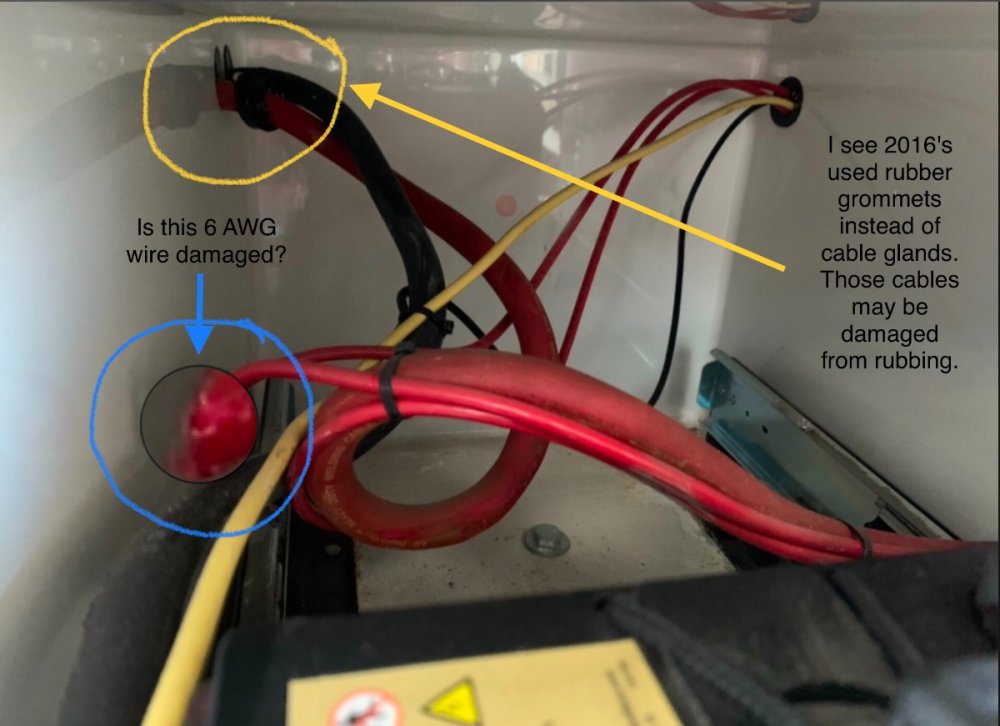

Mike, this picture concerns me.  I suspect the battery to inverter cables have been rubbing in the holes out of the battery box.  They should be inspected.  Also check the red 6 AWG wire I circled, it looks like it may be damaged.  It is either the Progressive Dynamics battery charger wire or the Blue Sky Charge Controller wire.
I know the Blue Sky CC is a MPPT type controller, but I don’t know which model it is and if it supports LiFePO4 batteries.  You should verify that before buying LiFePO4 batteries or plan on changing the CC.

Thanks, Mike.  I will check out both.  My trailer was built in late 2015/early 2016.  The wiring everywhere was not done as well as they are currently doing.  I’ll inspect both areas you circled.  The solar controller is the same as several other owners with Blue Sky that have already made the switch to Lithium, so I know that is possible.   Mike

We also removed all the wiring from the battery box and sealed off the outside vents and insulated the door. From the looks of the wiring in your battery box, you are not getting the full amperage story thru your shunt to the IPN display. I think you could benefit from some modifications.
I'm seeing something different here. The J-hooks are still there but the battery tray appears to be an updated design. The slots for the hooks are through horizon angles at the top of the tray, rather than through the vertical sides. This moves the hooks above and outside the storage area.  I'm trying to get info from Morryde on this change and also whether the 250# max capacity rating has changed to negate overloading by the GC2 AGMs.
Update to earlier post:
No changes by Morryde. Looking at the photo zoomed in, it appears as though Oliver has added narrow rubber strips to isolate the batteries from hook damage.  I'll have to check mine but I seem to remember the Trojans being a pretty tight fit. Not sure this will work as a retrofit solution, but if it does, OTT needs to step up.
Then: How to resolve total battery weight vs tray maximum capacity issue.
Edited by bhncb

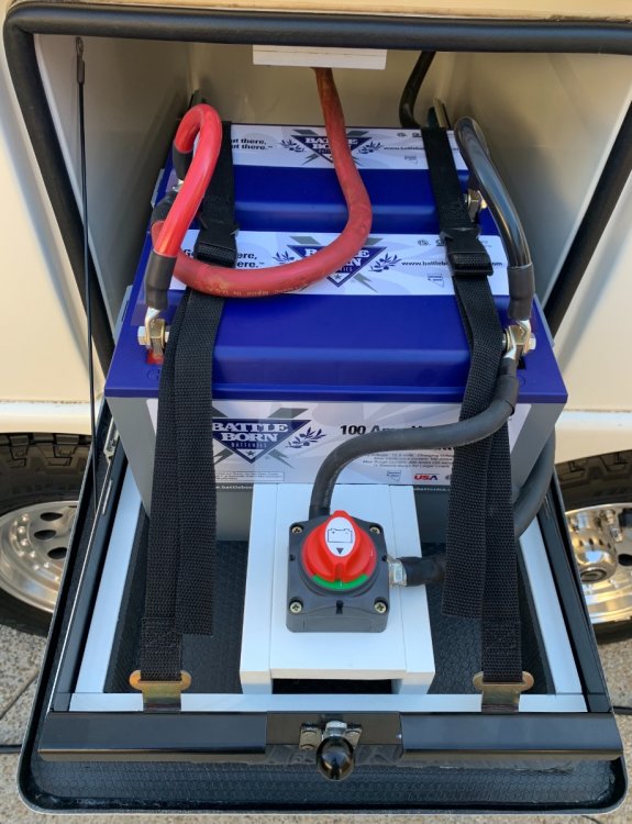

After some research and discussion I ordered two Battle Born 100 AH lithium batteries to replace my 4 old AGMs.  I also ordered a new PD charger that supports lithium.  I have the parameters to change on my Blue Sky solar controller.  Learning as I go and appreciate all the comments, guidance and advice.  I do want to clean up my cabling and also secure the two Battle Borns so there will be no risk of rubbing.  The Battle Born folks were very helpful and said I could add a third within the first year or two without any issue.  I’l also go from about 250 lbs of batteries to about 60 lbs.  Quite a difference.  Mike

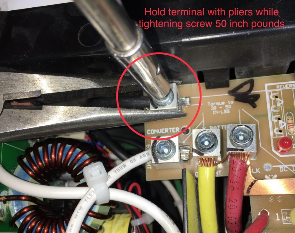

Mike, just the other day I swapped the Progressive Dynamics charging unit, it was relatively simple but I can offer a few tips. I will make a How To thread with pics. I think we will see more and more owners doing this mod as their “old school” lead acid batteries fail. I emailed Jason last month suggesting that the company issue a technical bullet with official guidance on how this should be done and he forwarded that to somebody. He did tell me that the production department kept no records of which PD units were installed, so an owner must indeed physically remove the cover to check the board. Maybe when enough swaps have been done, we can post a poll to figure out the rough cutoff date for when these lithium ones began to appear from the factory. I also suggested that they could offer an upgrade kit through the Oliver Company Store, for which we have now been impatiently waiting a couple years....
Edited by John E Davies
Link to comment
Share on other sites
Here are the instructions from PD.  It is pretty easy to follow and has nice images too.  I received my replacement unit in April 2019 and it was Li capable. My new board showed LI/WIZ instead of LI/LA. NOTE: WIZ is for charge Wizard and is the same as LA for lead acid, while LI is for Lithium
I did have a tough time getting the white wire removed from the lug (step #3). Otherwise it was pretty simple.
This works:
Mine were actually a little loose.
Link to comment
I’ll add these instructions to my Oliver manual.  Also useful for my upcoming project!  Mike

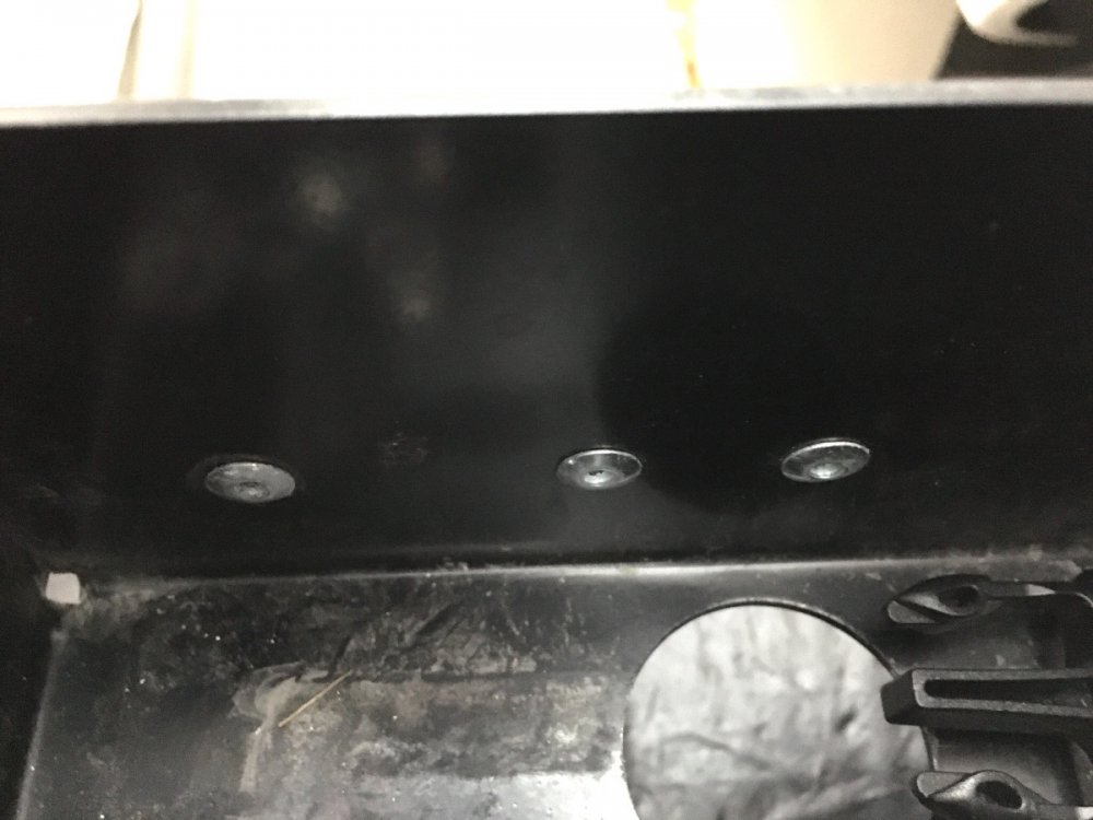

Removed batteries and battery tray from #75 2015 LE2 Ollie this afternoon.
There was a little damage caused by the strap hook and rivets to one of the batteries, but battery is OK for use:
Going to clean, prep and paint tray. Will also sandwich & secure 1/8" UHMW plastic strips between battery and tray where rivets and strap hook contact batteries. Ordered 1/8" plastic material from Amazon.   You can see corrosion formed over the years:
I think your plastic strips will work well, however FYI I think the rivets are facing the wrong direction. Mine are installed with the head inwards, so they don’t cause any significant amount of wear. It would be simple enough to change them, but I think the strips are fine too, as long as there is enough room for them.
Wow, the acid sure made a mess, didn’t it? AGMs are known for being “maintenance free”, but that is definitely an eye opener. I do recommend the ceramic Duplicolor Brake Caliper paint I mentioned previously, I think you will like it. It claims to not require a primer coat, and I rarely do, but considering the condition of the steel on your tray, I think that should be applied as well. The only caveat about the paint is that while it is dry to the touch in a couple of hours, it doesn’t fully cure for 7 days. I would not install any batteries on on top of it until then.  Just think, if the batteries had been located above a regular steel trailer A frame without a plastic box, those steel rails would have been damaged too. The Ollie fiberglass will clean up easily enough....l
Good luck.
John,
Your trays were riveted correctly and our trays were not from the OEM.  Hopefully our tray is not normal for 2015 Ollies.
Original batteries from Oliver were lead/acid 12V group 27 batteries, that's where the corrosion mess came from. Installed AGM batteries 3 years ago, before Lithium batteries were on my radar.  Did not look closely or see the corrosion until taking a closer look when we started talking about Lithium batteries a few weeks ago. Now that the tray is out, going to clean & paint, maybe buy Lithium batteries, too. Will see.
Edited by rideandfly
Bill:
Our original battery tray looked the same as your's with the rivets head on the outside.  In 2017 we had to replace the battery tray due to all the slide bearings came out plus other damage to the slides themselves.  The replacement tray came from Oliver and looks just like the picture in JD's reply; with the rivet heads on the inside where the batteries are located.  Our 2015 Elite II we opted for the four Trojan T105 wet cells, I keep a monthly check on the batteries and they are doing great, hopefully a couple more years of use from them before replacement.
