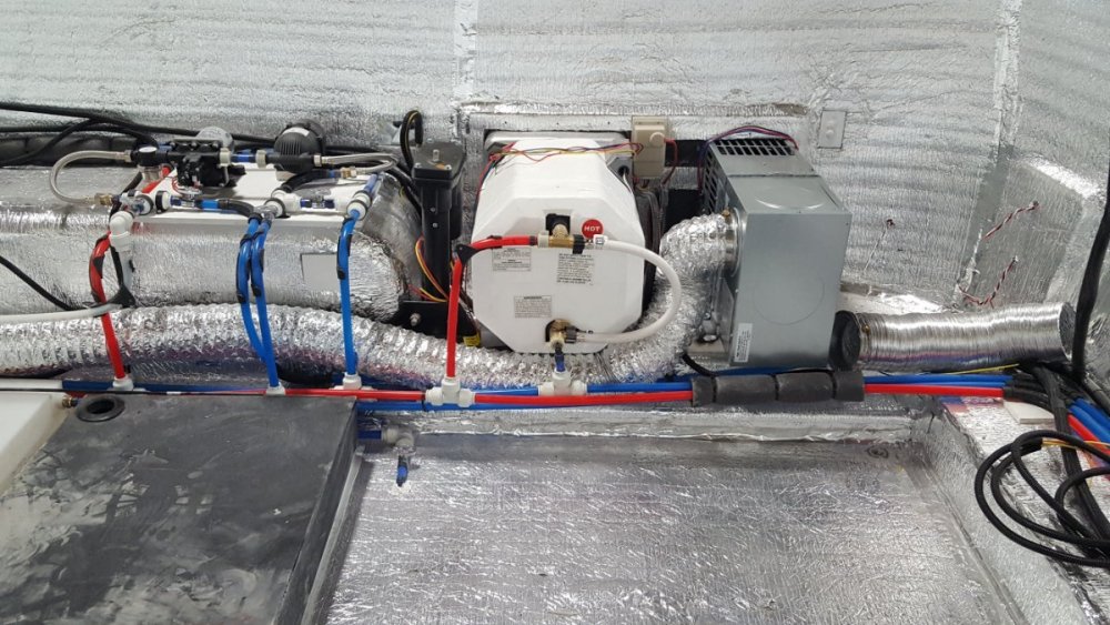

Fritz Posted October 11, 2021 Posted October 11, 2021 I feel like I'm missing something obvious, but where is the drain valve for the fresh water tank on the 2021 LE2? The drain location is not shown in Oliver's winterization video. Or is the way to empty the tank simply to pump it (mostly) dry? 2021 Oliver LE2 Ram 2500 diesel
Moderators Mike and Carol Posted October 11, 2021 Moderators Posted October 11, 2021 It is under the curb side bed under the furnace ducting. Probably 1/3 the distance from the kitchen to the back of the trailer. Mike 1 Texas Hill Country | 2016 Elite II #135 | 2020 Ram 2500 6.7L Cummins
Fritz Posted October 11, 2021 Author Posted October 11, 2021 Ah, thank you. I see that this valve won't be able to drain all of the tank, because is connected to a discharge port about 3/4 inch from the bottom of the tank. But I guess that's OK... 2021 Oliver LE2 Ram 2500 diesel

Geronimo John Posted October 12, 2021 Posted October 12, 2021 Fritz: Here is the EXACT location of that drain. Look just to the right of the foot prints and towards the wheel well a bit. GJ 2 TV: 2019 F-150 SuperCrew Lariat, 3.5L EcoBoost, 10 Speed Trans, Max Tow, FX-4, Rear Locker OLLIE: 2018 OE2 Hull 342, Twin Bed. OLLIE DIY’s: Timken Bearings, BB LiFePO4's, Victron 712 Smart, 350 Amp Master Switch, Houghton 3400, Victron Orion DC - DC, 3000-Watt Renogy Inverter, P.D. 60-amp Converter, Frig Dual Exhaust Fans, Kitchen Drawer Straps. Front Wardrobe Shelves, Snuggle Shelf. TV DIY’s: 2 5/16" Anderson System, Nitto recon’s, Firestone Rear Air Bags, Bilstein 5100’s, Mud Flaps & Weather Tech all, installed Ham Radio (WH6JPR).
Fritz Posted October 12, 2021 Author Posted October 12, 2021 Thanks – that helps me see where some of the other plumbing goes as well. I was not able to get water to come out of the drain after opening it, but that is probably because I pumped most of the water out of the tank with the pump. I will try tomorrow to add a little suction to the drain port just to make sure that I’m getting fluid (in this case, maybe a little bit of antifreeze) to come out of the drain. 2021 Oliver LE2 Ram 2500 diesel

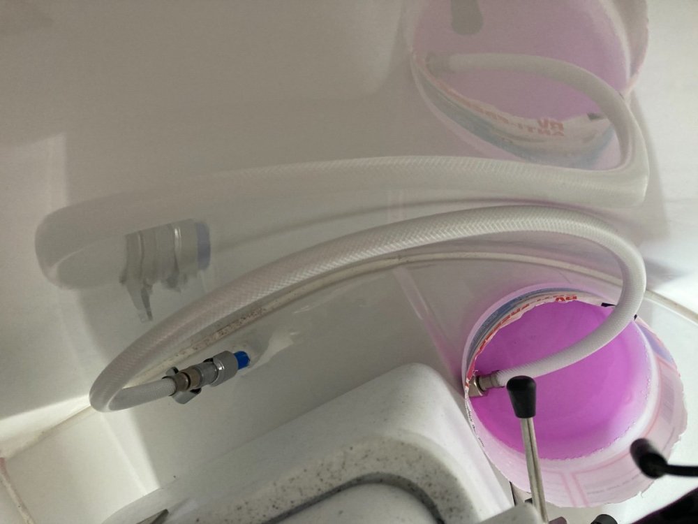

Mountainman198 Posted October 20, 2021 Posted October 20, 2021 On 10/12/2021 at 12:46 PM, John E Davies said: The small line behind the toilet base with the 1/4" chrome ball vale IS hooked up to the fresh system, and you need to flush that out. Put a paper cup over the outlet or you will get a face full - the water or antifreeze comes out like a geyser. If you ever happen to open up the vanity, you could disconnect the line there and cap the tee fitting. 2021 Elite II, Hull# 898 2018 Toyota Tundra, 2003 Dodge Ram 3500 5.9l SRW
Mountainman198 Posted October 20, 2021 Posted October 20, 2021 Just finished Winterizing and have the composting toilet. Fearing the geyser of water then pink stuff all over the bathroom and myself when purging the small toilet line, I went to Ace and bought a sink line ($10) and cut the top from one of the empty antifreeze bottles. Worked fine for mess-free winterization of the toilet line behind the Natures Head. Maybe three drops of pink stuff to wipe-up. 5 2021 Elite II, Hull# 898 2018 Toyota Tundra, 2003 Dodge Ram 3500 5.9l SRW
