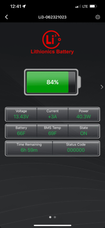

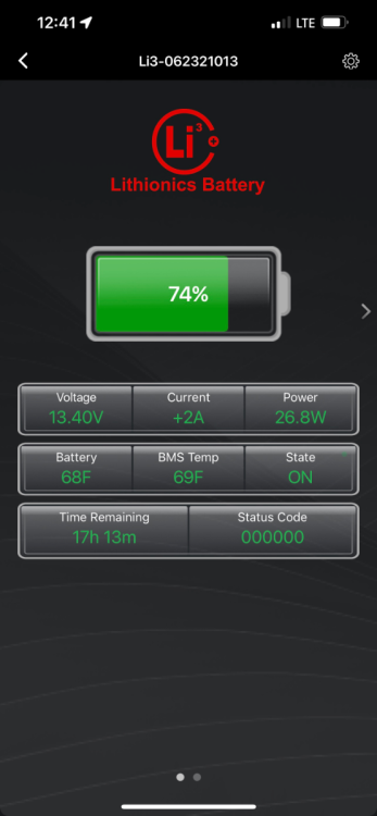

Does anyone with the 3 130AH Lithionics batteries ever see a different SOC between their batteries. I have one battery that always seems to be different than the other 2 even though it is showing similar voltage.

I have the 3 130ah batteries in our Oliver and I have seen pretty much the same thing you have on the phone app. The fact that the voltages are the same tells me your batteries are fine.
lithionics has admitted that the percentages shown are not always as accurate as we would like. A few things they recommended I do has helped the app SOC to be more accurate though.
I updated to the latest firmware for the BMS. This can be done in settings on the app. Make sure your phone has good Wi-Fi connection when you do this because the battery bms needs to go out on the lithionics site and get the correct firmware.
Next I drew my batteries down until they shut themselves off. This is called the reserve voltage cut off. Then I charged my batteries to 100% or 14.2 volts.
This seems to have helped make the % state of charge numbers more accurate.

Thanks guys.  I really haven't "used" the batteries very much yet.  I'll go ahead and run them down to RVC and the give them a full charge to see what happens.
