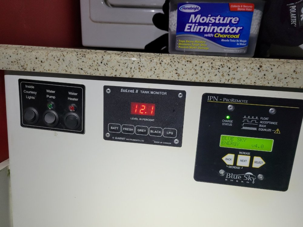

Now, I don't know what's causing the drain on the batteries, if indeed there is one, or if the panel readout of 12.2 is correct?  Or why the solar isn't keeping the batteries charged.  If anyone can offer some troubleshooting guidance we would greatly appreciate it. I've done a bunch of reading on this forum but nothing has helped me to understand what we might need to check and am uncertain how to proceed. I have not done a deep dive into the owners manual yet, that's next I guess.20220106_125942.thumb.jpg.2fb57382a84aa357c9759fab0ac5b8ce.jpg I included a couple of pictures to hopefully help with my descriptions.

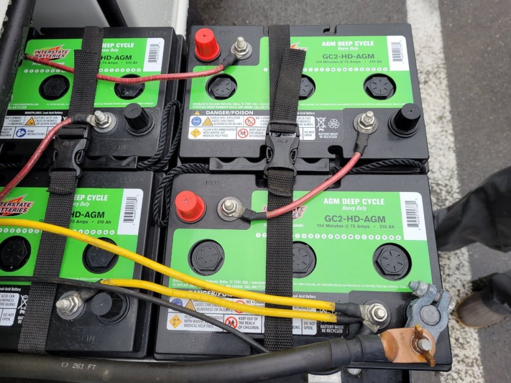

12.1 volts is OK, but just barely. Looks like you took them out just in time. There are lots of "phantom electrical draws" in your trailer. Something on the order of 0.4 amps/hour. That's 9 amps per day. In a week that's 63 amps or more. Looking at your battery pic, you have 210 available amp hours before you reach 50%. You state the batteries are "fairly new". We don't know their history of if the PO let them go down below 50% a few times.  I would have them checked under a load (free at Auto Zone or such) and see how much reserve they have left. The poor weather you speak of most likely had a lot to do with them not charging too well. Can you plug up to 120 volts?
Also, judging from the 4/0 negative cable (I hope there's an equally large red positive wire) I am assuming you have an inverter. If so, you really need to replace all those small 10 AWG connecting wires to 4/0 also.
The batteries are connected in series so the voltmeter agrees with your trailer battery monitor. 6.1v X 2 = 12.2v. I doubt you damaged anything by disconnecting the batteries as long as you kept the + and - wires away from each other and the + away from any metal trailer structure (even without the batteries there will still be voltage coming from the solar panels).
Looking for stray current being used in the winter is important. For instance, if you have a composting toilet there is a fan that stays on all the time unless you disconnect the power cord at the toilet.
Do not store your batteries on a concrete floor and charge them a couple of times throughout the winter.

All of these comments have been extremely useful and educational.  First off, after getting my first cup of coffee this morning and starting to read the feedback, we immediately jumped in the car and went to the Oliver to verify/address whether the 4/0 positive cable end was touching anything metal.  Well it kinda was I guess because it was laying on the bottom of the metal battery tray.  We put pool noodles on both the positive and negative ends of the 4/0 wires, thankful we didn't get shocked touching the trailer and nothing appears to be amiss. Thank you Steph and Dud B for that comment and the math.  I realize a 6 volt battery is probably full at about 6.7 then.
ScubaRx thank you for the comment on upgrading the connector wires for the "in series" batteries, that was a gold nugget and we will be changing those out.

You can use your Blue Sky display to see what you’ve got going out and coming in.  A low winter sun combined with a cloudy or rainy sky will limit your solar panels.  We had to pull out the generator when camped at Grand Teton and Glacier National Parks a few years ago.  Low sun angle and clouds prevented the solar from fully charging our batteries during the day.  Your Blue Sky display should tell you what kind of phantom draw you have.  Steve’s estimate of .4aH is a little lower than ours.  If I turn everything off I still get .6 to .7aH draw.  We store under cover so now I just turn the batteries off with a battery cut off switch that I installed.  Mike

Looking at your photos, it would "appear" that your solar panels were charging the batteries.  (See the green light on in the photo of the blue sky remote), and possibly in bulk state, unless you were lucky and just captured that photo on a blink. But, the 12.1 on the seelevel gauge means it wasn't really charging, (should read 13.4 or so in bulk), or you had some huge power draw going on, like the 3way fridge running on dc. The Dometic 3way never defaults to 12v like the Norcold. It has to be set to dc, but it can be done accidentally. Your solar panels would not be able to keep up with that big draw, especially in cloudy weather.
The other possibility is that the panels weren't actually  charging the batteries, at all. We have about  a .35  ghost draw in our trailer. In 3 to 4 weeks, that would draw your batteries down to 50 per cent.
Do you have a breaker near the pd charger/converter to cut the power from the panels? We do, but I don't remember if we installed it, or if  Oliver installed it, back in 2008. @ScubaRx would probably know, as your hull numbers are only 17 apart. If you don't have one,  you can cover the panels with a dark packing quilt so they won't be making power, and I'd suggest you do that when you reinstall the batteries and connect the cables.
I'm also curious about the message on your display. Mine never shows "blue energy v4." It always shows whatever setting i was last looking at,  instead. Maybe this is different in the newer remotes. Again, @ScubaRx or one of the other owners of newer systems may see that. I don't know.
There should be a large red rotatory switch near the charge controller. If you turn this off all solar input will be interrupted. On my unit this does not kill the power to the IPN Pro display.
About the IPN Pro display. That shown is a screen that would only be seen during boot up, whenever power to the screen had been interrupted and then restored. The photo would have to have been taken during this stage. On my unit that screen and green indicator light only stay on for about 2 seconds.

A shot in the dark with this statement- Your original picutre on the Sea Level II Tank Monitor shows 12.1 percent. I assume you pushed the Batt button to get that reading. If not it was a reading of one of your tank levels.
That's interesting.  Just guessing they didn't just happen to capture a 2 second display.  Maybe a storm caused a power outage? Display froze?
We normally charge our batteries from solar only. We lost power from the solar, just one time, this past summer,  when we were away. Fortunately,  we got back in two weeks. Battery voltage was down to 12.3 on the seelevel, 12.4 on the ipn proremote. The storm had apparently tripped our solar breaker. It never happened before (in 14 seasons), and not since, so guessing lightning, quite close by.

Dudley, you probably already know this, but for the benefit of newer owners who's 12VDC electrical knowledge may be a little rusty.
In Oliver's 4 x 6 volt battery package you have two sets of two 6 volt batteries. Both batteries in these sets are wired together in series to make a 12 volt battery (one wire from the positive terminal on one battery to the negative terminal on the other battery - think as if you're putting batteries in a flashlight, each battery's voltage is added to make the total). The voltage doubles for the set but the available ah remains the same.
Then, the two sets are wired together in parallel by connecting the positive and negative terminals. This keeps the voltage the same for the four batteries but doubles the Ah capacity of the pack.
This wiring scheme gives you a 12 volt system with a aH capacity of double the stated aH of any one battery. This is how many aH you can use before reaching the dreaded 50% point of no return.
Then, to properly connect the battery pack to your trailer the positive and negative wires should come off the opposite corners of the set of batteries. This will enable each battery to be discharged and charged equally.
And, the bigger tray in the Elite II allows that configuration.  It's really nice for you elite ii owners to have all those amp hours available.

I've read all ya'lls most recent comments (huge benefit and thank you!!) and stayed up reading manuals last night.  I believe you nailed it with the Blue Sky charge controller being frozen, therefore it was not doing its job.  The backlit greet light has always been on anytime I went to check on the trailer and anytime I pressed on the Next button the screen never changed from what is shown in my attached picture.  I thought that very odd but regretfully I did not follow up to educate myself as to why.  Pulling the batteries caused a reboot and (fingers crossed) hopefully BlueSky will come back on working correctly.

We got the AGM batteries charged up at a local battery store and were told they were in good shape.  We had flipped the 30 amp breaker to off, thinking that would cut any power that needed to be off while reinstalling the batteries.  We did not know where the master off/on for the solar panels was located, as it was not in the overhead shelf side wall like I've seen in photos from others.  While cleaning several days later I found the solar on/off switch under the street side bed, so I now know where that is located. It was still on while we had reinstalled the batteries, and thankfully nothing happened (arcing, twitching, etc.).
We got our Casita sold and now have the Oliver sitting in our driveway, plugged in to the wall.  The charge controller came back on and I can cycle thru 5 or 6 different items so that seems to be okay.  I did notice that the charge in/charge out view did not have any number registering for the "in" part, and it was a sunny day so that caused me to think that a number should be registering if the solar is putting in a charge (it was a sunny day too).  The "out" was registering 0.4 and that sounded normal compared to what some of you have mentioned is your normal phantom charges.
I still need to educate/convince myself the solar is working and make sure I thoroughly understand what the charge controller is telling me. The manuals only help me so much so I will be doing some searches on the FB page and Forum for descriptions as well as some videos.  Thanks again everyone for all the contributions!  We are closer than farther away to trucking.

On my Solar Charge Controller when the solar panels are actively charging the batteries, the display shows 14.5 + or - volts.
When the batteries are fully charged the Solar Charge Controller shows 13.6 volts.
Sorry folks, I just noted that the above is from 2022.  So likely all of the below was a waste of your and my time.
GJ
Scuba RX is spot on in that both cables coming into the battery bank need to be 4/0.
Beyond the above statement, what you have is a serious problem that is unrelated to your poser loss.
The 2,000 watt Inverter if loaded will easily pull over 2,000 watts.  Recalling Watts = Volts *  Amps         or       Amps = Watts/Volts      For your inverter it can easily require the wire to carry  2000A/12.5V  =  166 amps.  The 10 AWG wire is rated only for 30 amps.  THIS IS A SERIOUS FIRE SAFETY ISSUE.
Please seek help in changing out those wires.  They are NOT OEM.
