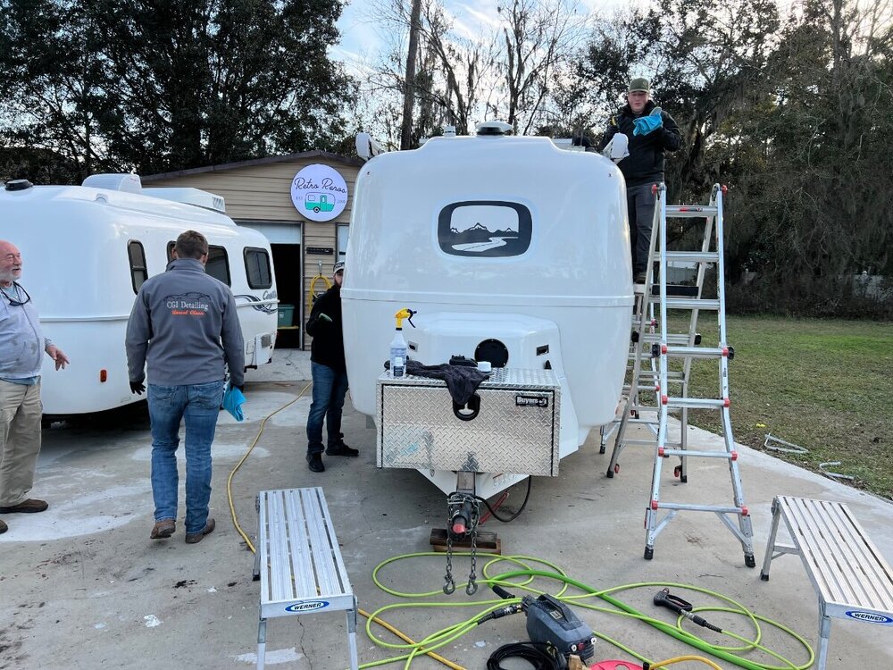

Joe and Janet Childers Posted February 15 Posted February 15 We decided to let CGI do the work on our camper after talking to several Oliver owners who have had their Olivers ceramic coated. It took 4 guys who knew what they were doing 9 hours to complete the process. Our camper had very little oxidation. It has been covered or under a shelter at all times (2020 Hull 588). I had to convince Joe that his knees were not 20 years old any longer and NO some DUDE was not going to help him do it if he could find that DUDE. After he saw the work Gavin and crew did to make her shine like new he agreed. They also replaced the moldy white trim around the windows. We arrived back to NC to 6 inches of snow and freezing temperatures for about a week. When we rinsed and soaped up the camper, she looked brand new. No hard scrubbing required. 5 LEII 2020 Hull #588 Egg-Stream 2022 GMC Sierra 2500 Crew Cab
Moderators topgun2 Posted February 15 Moderators Posted February 15 J & J - Looks great! How refreshing to find four relatively young guys that are not afraid of a bit of hard work. Yes, I know that they charge a fairly high price for that work, but, I've paid more for less. I assume that you took some Pepsi with you? Bill 4 2023 Ford F150 Lariat 3.5EB FX4 Max Towing, Max Payload, 2016 Oliver Elite II - Hull #117 "Twist" Near Asheville, NC
Moderators Mike and Carol Posted February 15 Moderators Posted February 15 CGI does great work… 4 Texas Hill Country | 2016 Elite II #135 | 2020 Ram 2500 6.7L
