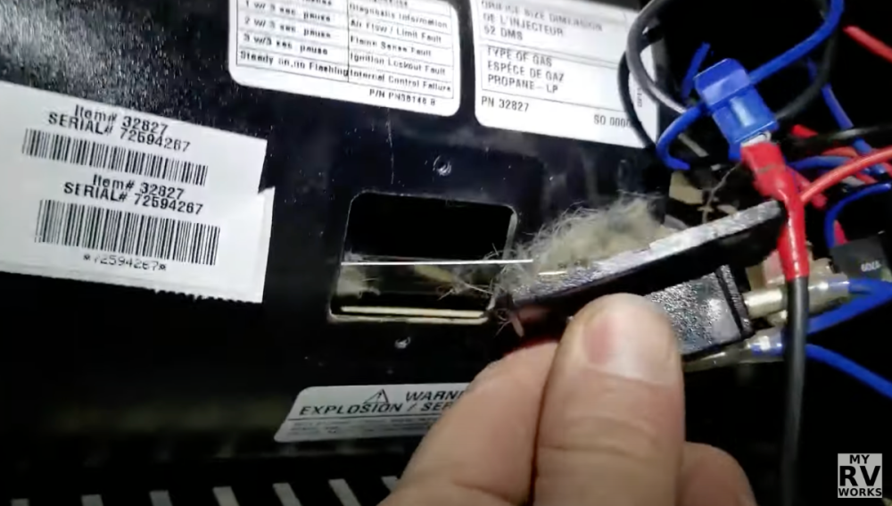

Galway Girl Posted April 5, 2022 Share Posted April 5, 2022 Here's how to check your sail switch....the outside panel of the furnace comes off with a few screws....the video shows what's inside (rotated 90 from how ours are mounted.) Sail Switch with pet hair shown below...but could be just dirty. The video : 4 3 2019 Elite II (Hull 505 - Galway Girl - August 7, 2019 Delivery) Tow Vehicle: 2021 F350 King Ranch, FX4, MaxTow Package, 10 Speed, 3.55 Rear Axle Batteries Upgrade: Dual 315GTX Lithionics Lithiums - 630AH Total Inverter/Charger: Xantrex 2000Pro Travel BLOG: https://4-ever-hitched.com Link to comment Share on other sites More sharing options...

routlaw Posted April 5, 2022 Author Share Posted April 5, 2022 24 minutes ago, Galway Girl said: Here's how to check your sail switch....the outside panel of the furnace comes off with a few screws....the video shows what's inside (rotated 90 from how ours are mounted.) Sail Switch with pet hair shown below...but could be just dirty. Wish I owned one of those Atwoods, unfortunately the Suburbans are a major PITA to work on. The entire thing has to be removed from the camper to get to anything but the ignitor. I've done this before, its an all day affair due to the limited working space. Even the compartment dividers to the storage area in the rear have to be removed. Anyway was hoping all indicators would not point to the sail switch for this reason. Regardless thanks for linking the video, it was helpful even though it is for an Atwood. 1 Legacy Elite II #70 Link to comment Share on other sites More sharing options...
