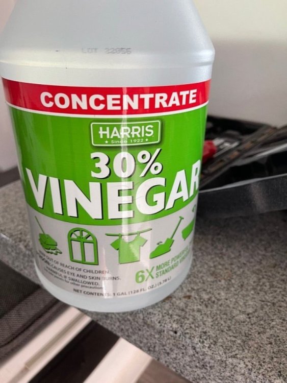

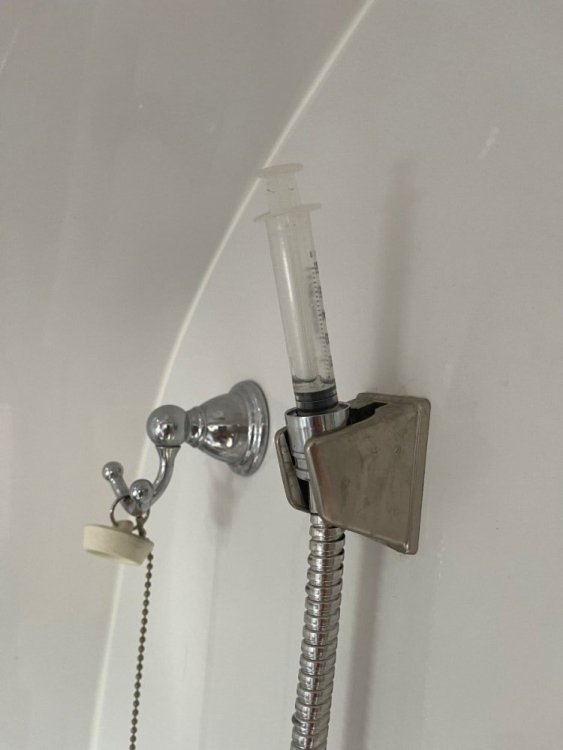

Imelda Posted June 2, 2022 Share Posted June 2, 2022 (edited) Hi all. I had discussed my problem of very low water pressure at my shower faucet even with the faucet head removed on an earlier post. No issues at kitchen, outside faucet or toilet. I decided to share this on a separate post on how I fixed the problem since others might have this problem sometime. I bought the vinegar (see pic) at Home Depot and was planning on pumping it though the fresh water tank (bypassing the water heater) and decalcifying before my next trip. But meanwhile I had the idea of removing the faucet head, turn of water or pump and drain as much of the water out of the shower water line as I could. Then I took a syringe - see pic (no needle) and slowly over 1 hr. injected about 2 cups of the vinegar down the faucet hose (see pic) . Be sure to wear gloves and eye protection as the vinegar will burn. I hung the shower hose to the shower holder so I got max amount of vinegar down the hose. Pics need to be rotated 90 degrees. After 1 hr. I went back and turned on the water pump and water pressure is back to normal. 👍 Edited June 2, 2022 by topgun2 pic rotation 2 6 Link to comment Share on other sites More sharing options...
