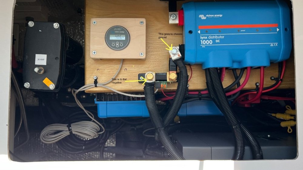

Here are a few photos.
The photos that you see of the bolt, wires, nut and the silver metal plate below it were covered with an insulated black tar type coating from the factory, this was causing a bad ground connection. The bolt you see has been changed, the original was welded and it was a HORRIBLE weld with spatter all over the screw it was barely able to make a good ground connection!! There is also a bolt that goes through to the main trailer frame connecting that silver metal plate that you see.  this completes the correct and secure ground!!

Thanks for posting the pics, that badly repaired ground stud would certainly throw a bunch of circuits out of whack! The black tar stuff is perfectly fine too, it is generically called “liquid electrical tape”, and it is used for putting a flexible waterproof coating on any connection that you want to stay corrosion free indefinitely. The down sides are it’s quite messy, and it can cover up a lot of sins like your crappy welded repair.

That black tar coating came like that from the factory as did the poor weld job. The spatter from the weld on the screw would not let the screw make full contact, it only had a partial contact on the electrical spades on the wires which caused the poor ground and a very minimal ground contact. Because of the weld spatter the spade could not make full contact and there was a arc spot on the spade from only touching that “blob” of weld spatter. Now, the plate, nut and the screw after we repaired it is covered with dielectric grease and now full contact between all connections including the screw in plate.

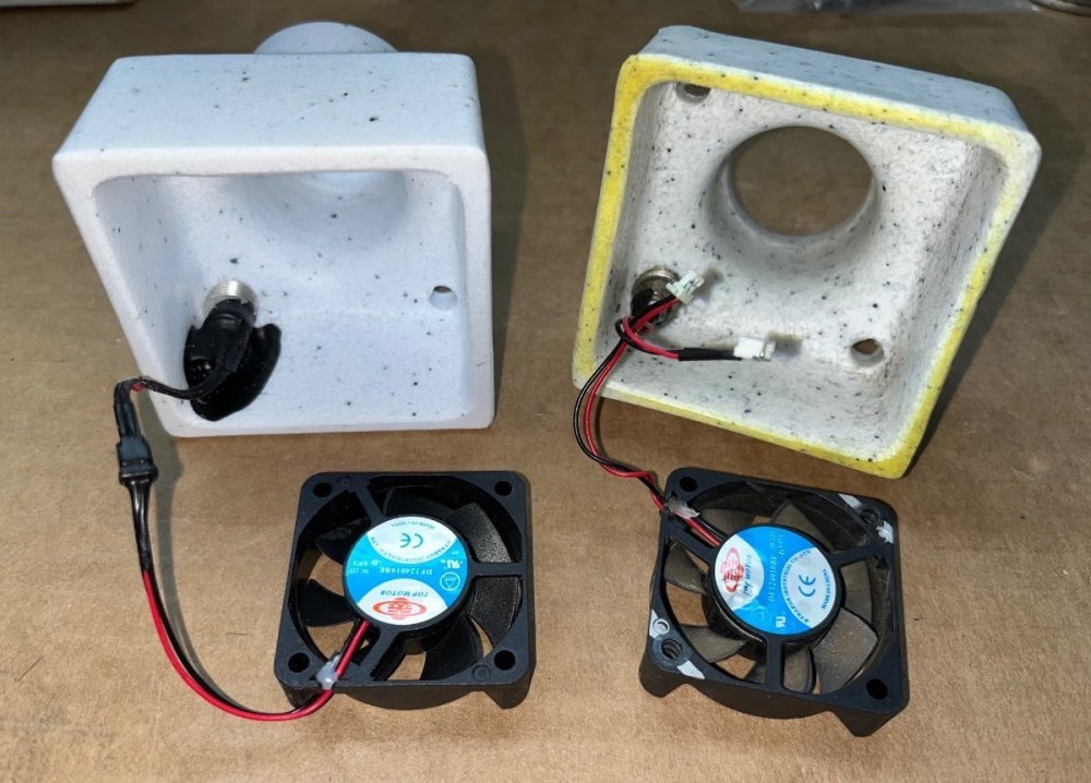

Here is an excellent example, I don’t know if it is the same exact product. Natures Head replacement vent fan now comes from them with all the connections and solder joints protected.
The connectors are actually covered with heat shrink tubing first, then covered with the coating, that is pretty thorough workmanship, I guess they were having problems…..
