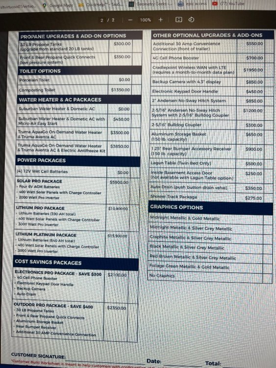

Guest Posted July 18, 2022 Posted July 18, 2022 30 minutes ago, mossemi said: the 2 5/16" coupler was installed in the production department, I would consider that an upgrade. Hello, FYI, The 2 5/16 coupler is now listed as on option on the 2023 build sheet. Kirk
John E Davies Posted July 18, 2022 Posted July 18, 2022 52 minutes ago, Kirk Peterson said: The 2 5/16 coupler is now listed as on option on the 2023 build sheet. Thanks, what is the cost? Do they charge anything extra for the matching Andersen? And it is about time! Where is that disk brake option? 😀 Can you scan that build sheet and post it? John Davies Spokane WA SOLD 07/23 "Mouse": 2017 Legacy Elite II Two Beds, Hull Number 218, See my HOW TO threads: Tow Vehicle: 2013 Land Cruiser 200, 32” LT tires, airbags, Safari snorkel, Maggiolina Grand Tour 360 Carbon RTT.

Guest Posted July 18, 2022 Posted July 18, 2022 59 minutes ago, John E Davies said: Thanks, what is the cost? Do they charge anything extra for the matching Andersen? And it is about time! Where is that disk brake option? The cost for the 2 5/16 bullbog coupler is $300. 2 inch Andersen no-sway is $850 2 5/16 Andersen no sway with 2 5/16 bulldog coupler is $1200 From OTT for 2023 E2: Quad Shocks on dual Dexter leaf spring Nev-R-Lube axles with “Nev-R-Adjust” 10″ electric brakes: Standard

John E Davies Posted July 19, 2022 Posted July 19, 2022 12 hours ago, Kirk Peterson said: Thanks for posting, I haven’t done it yet, but if you check all the expensive options, what is the total price for a fully specced out LE2? Mine was “moderately” equipped five years ago for $62k 😳 John Davies Spokane WA SOLD 07/23 "Mouse": 2017 Legacy Elite II Two Beds, Hull Number 218, See my HOW TO threads: Tow Vehicle: 2013 Land Cruiser 200, 32” LT tires, airbags, Safari snorkel, Maggiolina Grand Tour 360 Carbon RTT.
